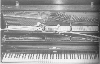

Well, you can mic a piano with a single SM57, or two mics is probably more of a standard. However, nothing's a hard & fast rule, other than what sounds best at the time, or sometimes what's most convenient.
On a serious piano session, & for best results, I would remove the piano's top-front wooden panel, to expose the string section and sound board. Then place one or two mics about 12" off the strings from the front, L & R, set up on either side of my shoulders, either pointed directly perpendicular to the strings, or angled slightly toward the center.
I believe this would be a "standard" setup of mic'ing an upright piano with 2 mics, although a single mic could be used in a center position.
However, sometimes you do just what's convenient. F/I, on my most recent piano track, just last Sunday, I used a single mic on the piano, pointed up into the gap between the front cover and keyboard, right into this 2" space, just comfortably to the right of my right hand, & pointed slightly upward from the right to the left toward the strings. It's an acceptable mic placement, but I'd have gotten better results to fine tune the EQ more, at the time. It's a decent track, though.
I'll scan and post a pic of what I'm talking about, "standard upright piano mic'ing".
Pic: "standard" mic setup for upright piano,... from "Musician's Guide to Home Recording", by Peter McIan & Larry Wichman. I could probably take a better picture.;)
See: It looks as I've described, except these mics are boomed in a bit toward the center, and angled out. It's a relatively minor difference from what I described, but you get the general idea.
Angle mics out from center a bit to isolate Hi/Lo a little on L/R mics, or angle mics in to get a more cohesive tone in both mics. Alternately, you could spread the mics a bit & angle both mics directly toward & perpendicular to strings. You'll get a subtle change in the mic'ing effect by small changes like this.
There's nothing set in stone, but there are some guidelines, and minor differences are done to taste. I've occasionally used straight mic stands placed on either side of the piano bench, angled a bit inward, but a boom stand aids in the real nitty-gritty of mic placement onto an upright piano.
Thanx for listening, & thanx for asking!

Wow! What a great & detailed explanation!! Thanks :) . But what is the significance of micing with 2 mics instead of just one ? The piano is a mono instrument. :confused:
Daniel
One mic captures the lower registers, the other the higher ones. And just because it's a mono instrument doesn't mean you have to treat it as such.
Well, it's also a large instrument, with 88 keys.
Even in the center, there's a good 24" of spread between the most commonly used high notes and the most commonly used low notes,... [center third of the keyboard].
Sometimes two mics helps capture the piano's highs and lows better, just based on covering the physical distance better, and the physics of sound relative to mic placement. It is just more comprehensive as two mics used together, even though your end result may often be a panned-to-mono single recorded track.
That being said, it is perfectly feasible to mic a piano with a single mic, placed in the center. It's done all the time.;)
Uh, I didn't catch that!... "A piano is a mono instrument" is a bit of a misnomer!
I certainly don't look at it that way! The word "mono" doen't apply to piano, as an instrument.;)

Hey Dave, that piano sure looks mighty familiar:p
fitZ
ps(how you and the family doin? Tell your son the "old bucket of wine" says hello!)
Hey FITZ! Damned if that piano doesn't look just like mine,... but it's not!
I scanned that pic out of a book, but as I said, I could probably take a better pic. I noticed right away it looks almost identical to my piano.;)
