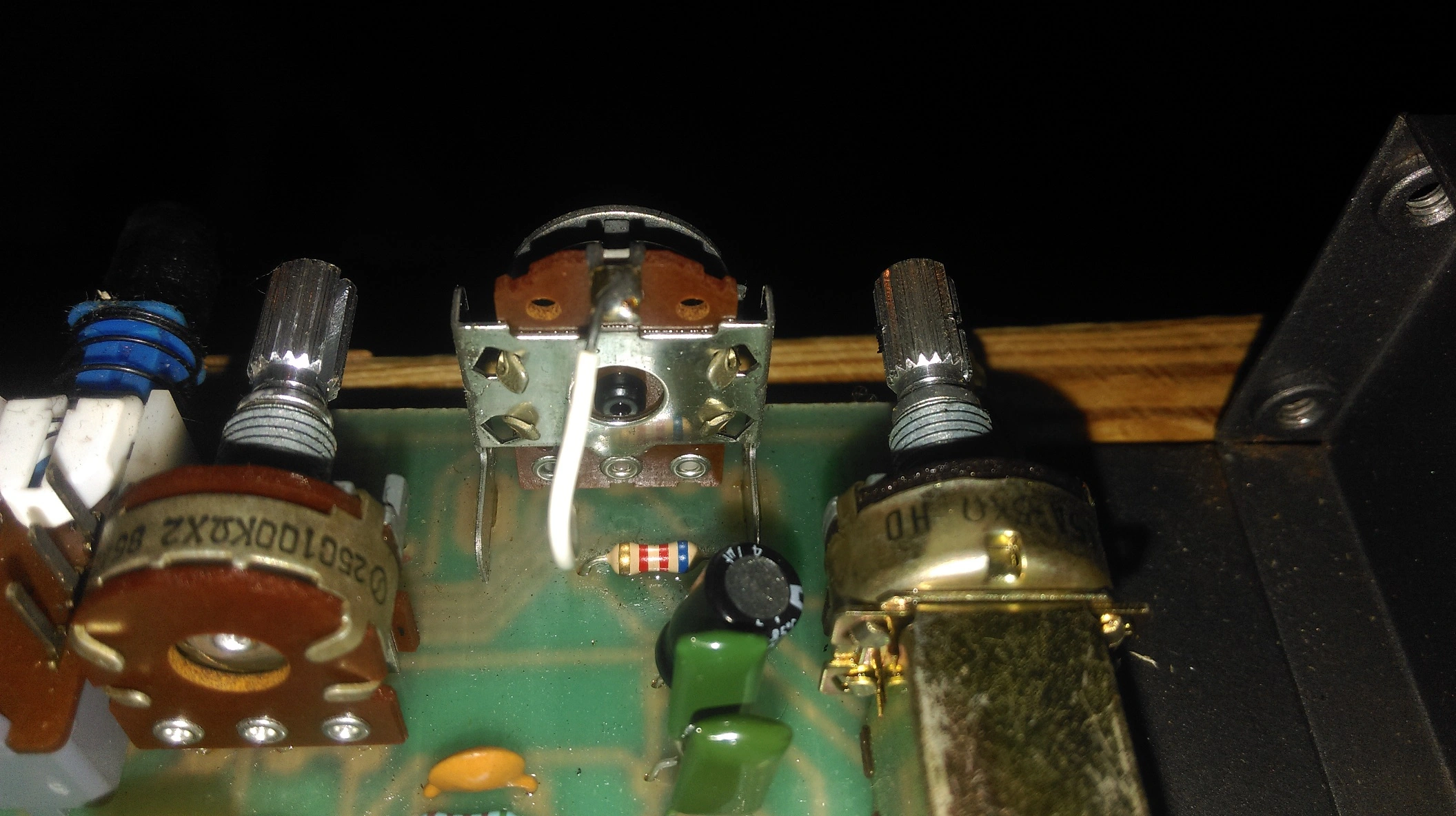

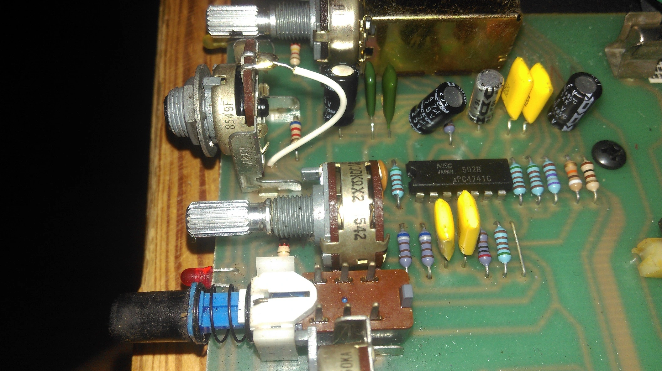

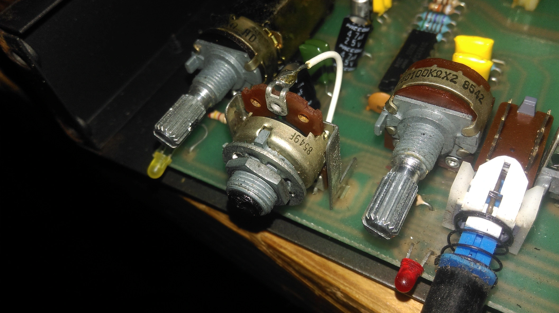

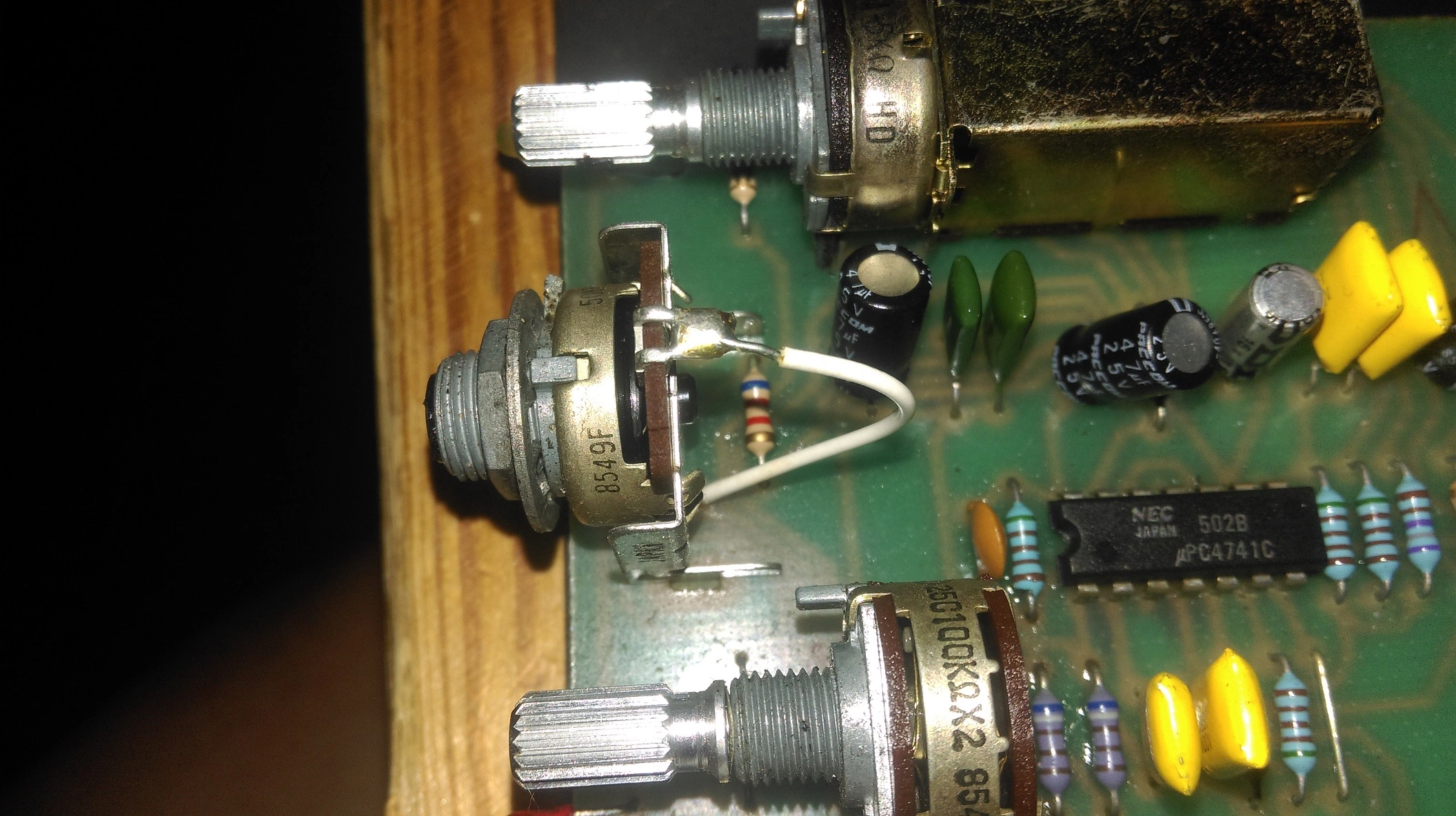

Awesome, thanks for the info. Looking inside the unit, I found that the pot is unlike any I've ever seen. Granted, I'm not a tech, so I haven't seen a lot of pots, but I've been inside a good deal of guitars and amps, and I haven't seen something that looks exactly like this before.
See the attached images. Most pots I see look like the "100K pot" image (attached), with the brown board at the bottom of the shaft, and the enclosed housing beneath that.
But the pots in the Rane have the housing first, and the brown board beneath that.
I'm sure this is commonplace for techs, but I've never seen it before.
Anyone know what's going on?

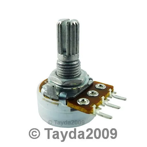

That pot has a tapped track. Mechanically centre tapped but electrically, WTF knows!
Assuming it still works you need to centre the wiper mechanically then measure the resistances from wiper to each end of track and ends of track to tap.
You are probably only going to get the right pot from the OEM or, by finding all the markings on the pot and then seeking out the manufacturer.
Getting the pot out without damaging the print track will be tricky, don't want to school Granny so shout if you need an MO!
