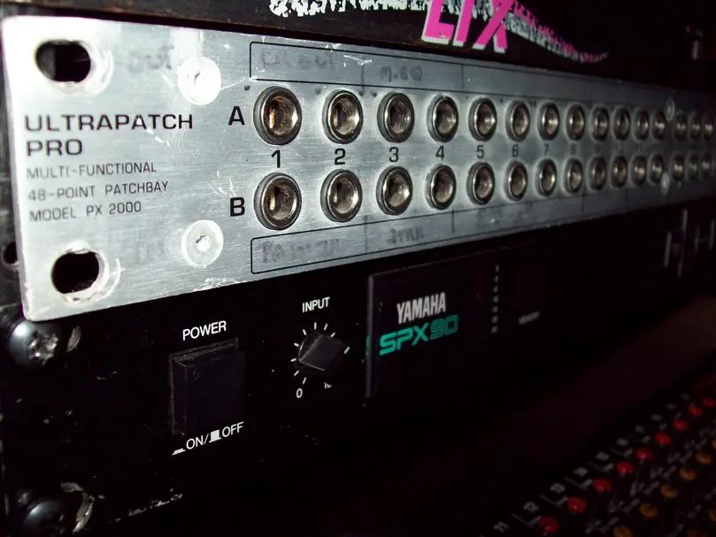

Your going to need a patch bay or two to do this correctly.
How many AUX sends are there on your mixer?
:cool:
O.K.
I have the patch bay..

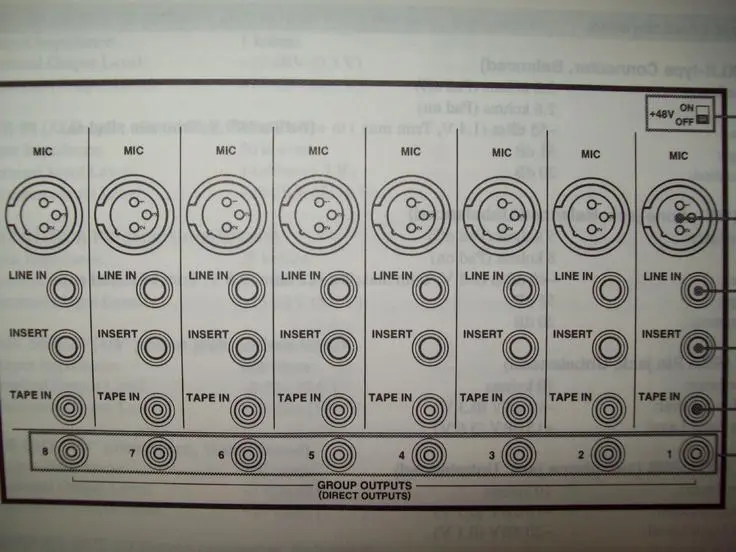

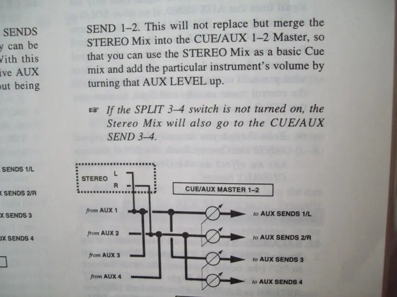

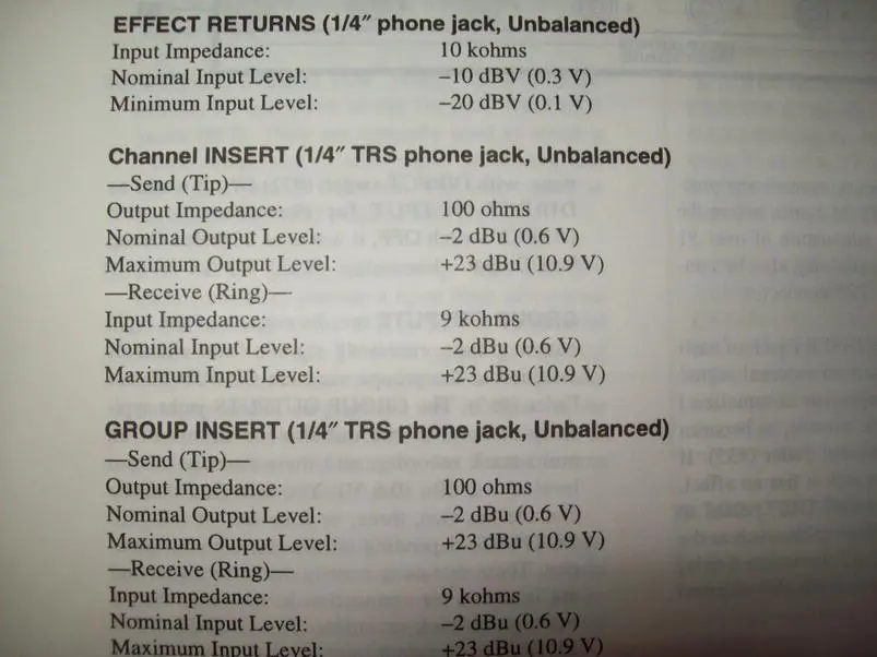

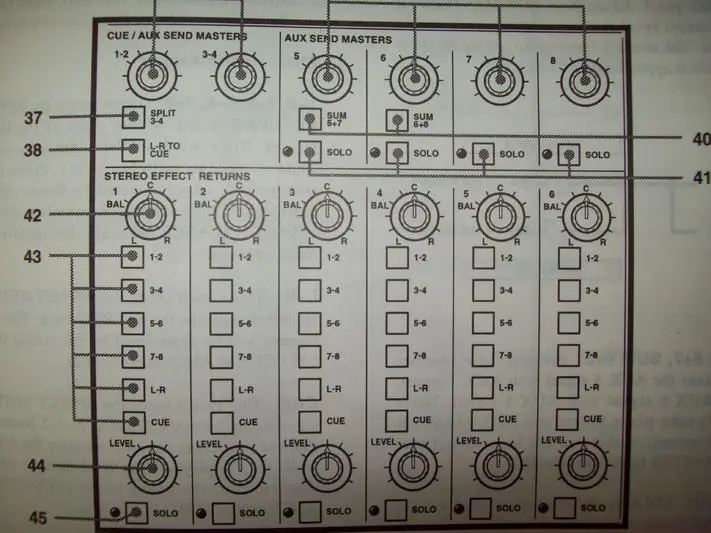

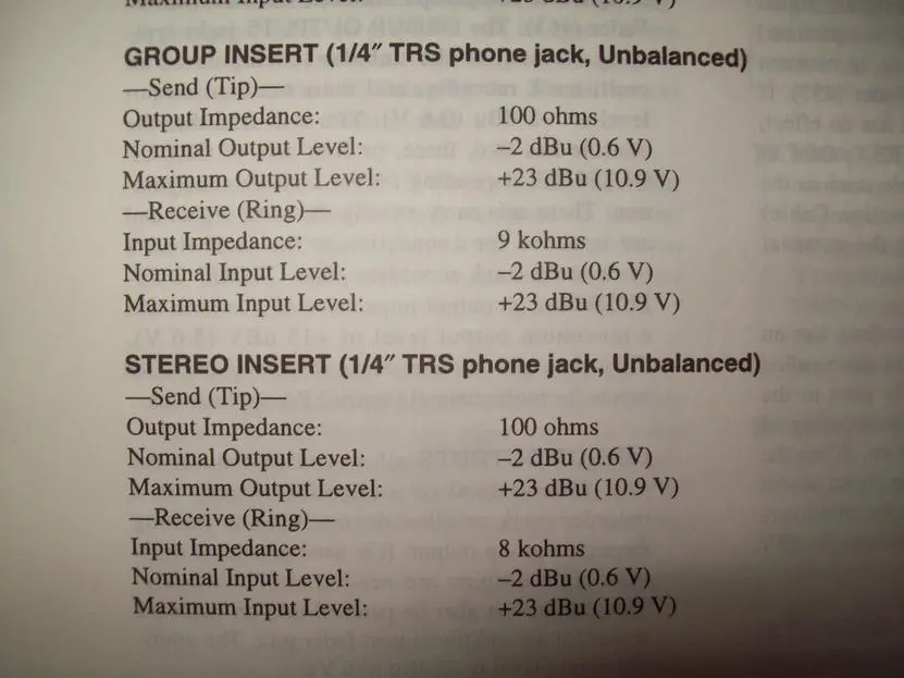

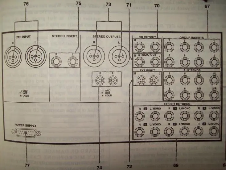

and here are some specs from the M-2600 manual

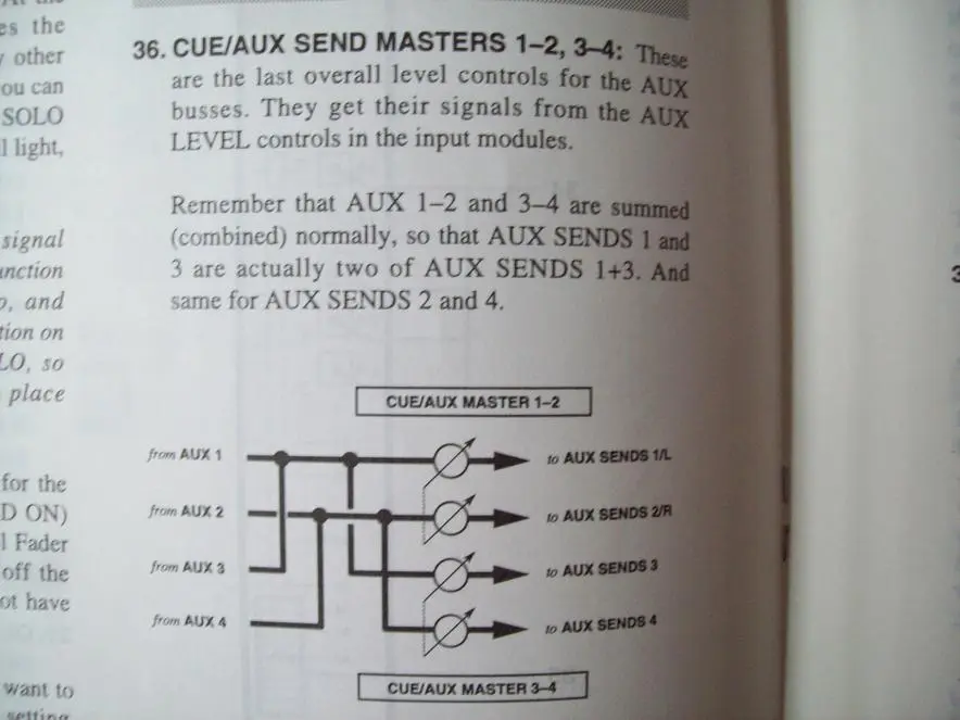

and some more...

Looks like the most that you can do at one time is 6 and that is with total control of them all. Meaning no piggy backing (that doesn't work to well).
Just look in the manual to see if the AUX send and returns are balanced or not and use the appropriate chords.
As for the channel inserts you'll need an insert cable. Those inserts on the channels are usually for comp/limiter/gates ~ that's what I use them for in live sound.

It says 1/4 phone cable?

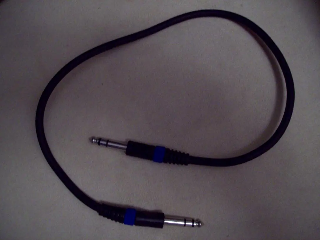

You mean insert cables right? that is a cable with one t/r/s on one end with two separate cables on the other end t/s termination of both.

And yeah... don't get hung up on the send and return cables... the only specialty cables required would be the insert cable for the individual strips.

This may sound redundant, but you are running the send out to the 'in' on the box and the 'out' from the box to the return aren't you?

this ^^^^^^^^^ double check that. The 'out' on the fx DOES NOT got to 'out' or 'send' on the mixer.

1/4" phone is exactly the same as an instrument cable. It's not the cables ...... you've got something either hooked up wrong or you have something on the board set to where you're getting some kind of feedback loop.
