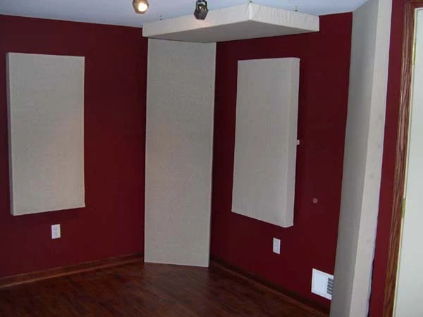

Here's a pic of some absorbers I built with mineral wool and wood frames. Fabric on the front and back is enough to hold it in place. I did use a center brace for the 8' ones.
I used 703 for the ceiling ones because it will support itself without sagging and is very light.
