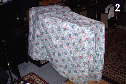

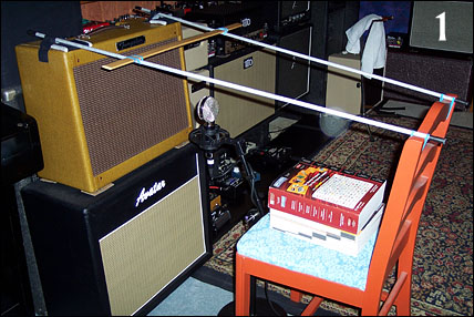

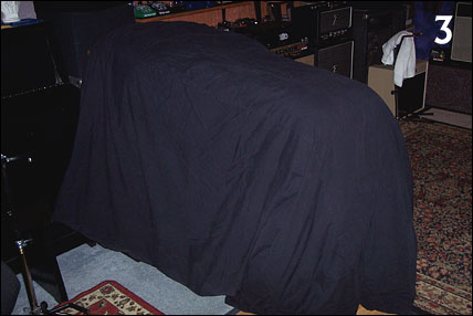

No...not at all...you just add the ambience during mixdown....and besides, when close-miking (like most guys tend to do), the room doesn't figure in all that much anyway.
I don't need to use a closet since I have my studio space...but I'll often build a tent over the amp/mic because I WANT to remove the room from the equation and add the ambience later....and, I don't like to close-mic all the time, so with the mic away from the cab, it WOULD pick up the room, especially when using something like a ribbon-mic with figure-8 pattern.
Actually...the tent approach also does a great job of cutting down some of the amp's volume so it's not bleeding out into the studio (or annoying people outside).
This is my typical tent setup:
I use this setup often.

Yeah...true...blankets won't soundproof it, but they help cut down the volume some....and using a closet will do that even more.
I guess it really depends how loud you wanna play and how easily your roomates are annoyed by it. :D
I don't use the blanket "tent" for volume control...I use it mainly to remove the room ambience from the equation so I can choose the room sound later, and more to keep outside sounds from getting INTO the mics, rather than to keep the guitar sound from getting out. :)
That looks very innovative but I'm curious... Why not plug your guitar straight into a mixer? Or, if the amp sound is particularly special to you, why not run a line direct from your amp, to the recorder?
