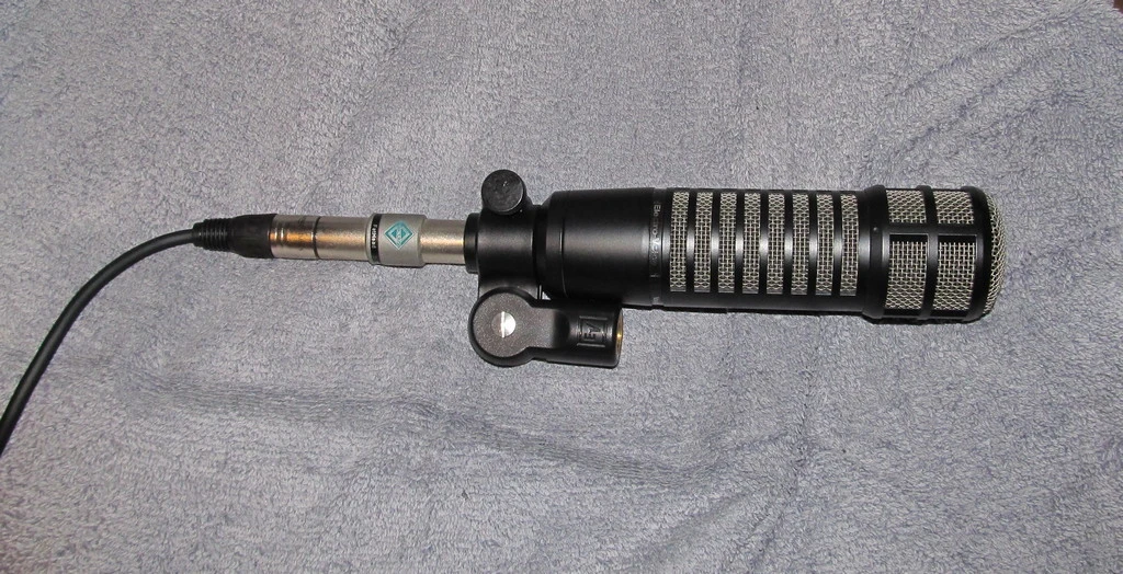

Curious..... did you have a problem with the RE320 direct into the UMC202HD without a booster? The RE320 has a moderately hot output, more than a Shure SM57 and in typical use should have enough output for the UMC202HD to work with.
You could plug the SM DM1 directly into the back of the RE320 or into the UMC202HD if you have only one XLR to XLR cable. Like my RE320 with a FetHead....
