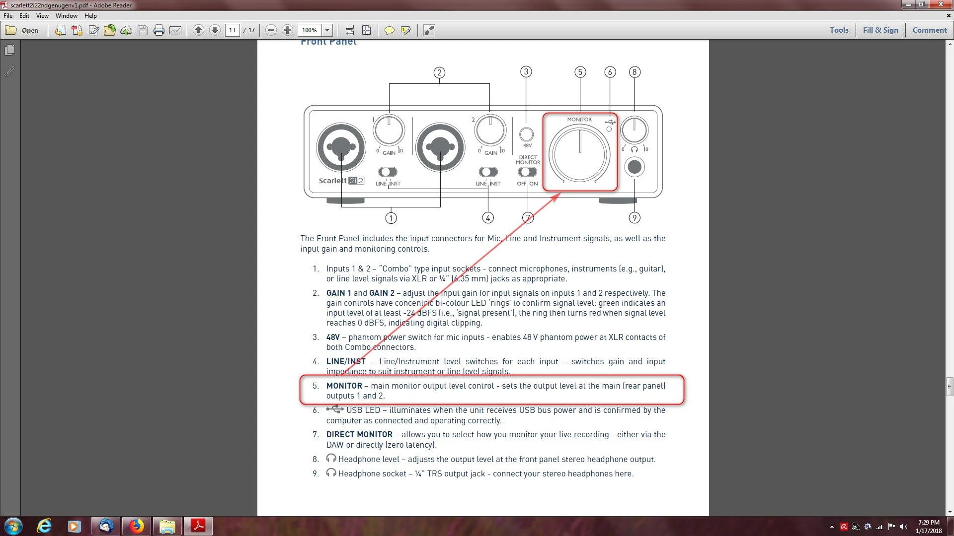

- Realizing you may be new to this, have you turned up the 'Monitor' control knob on the 2i2 as shown below? This control is for the outputs on the rear of the 2i2 and I don't believe affects the sound from the headphone jack which appeared to work. If you haven't tried yet, put the 'Direct Monitor' switch to the ON position.

...Realizing you may be new to this, have you turned up the 'Monitor' control knob on the 2i2 as shown below? This control is for the outputs on the rear of the 2i2 and I don't believe affects the sound from the headphone jack which appeared to work. ...
I'm gonna feel pretty dumb if this is the problem. I "assumed" when he turned them up this is the knob he was turning!??
Sometimes not easy piecing parts of the puzzle together:) Hopefully it's as simple as this.
