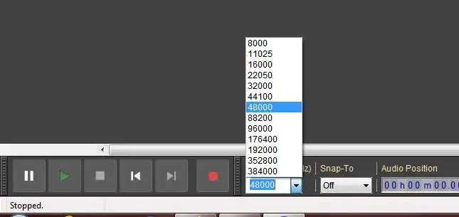

Audacity. Windows 10 and 48000 the onlysampling rate I have ever used. I cant see any settings that are different from what have worked in the past.

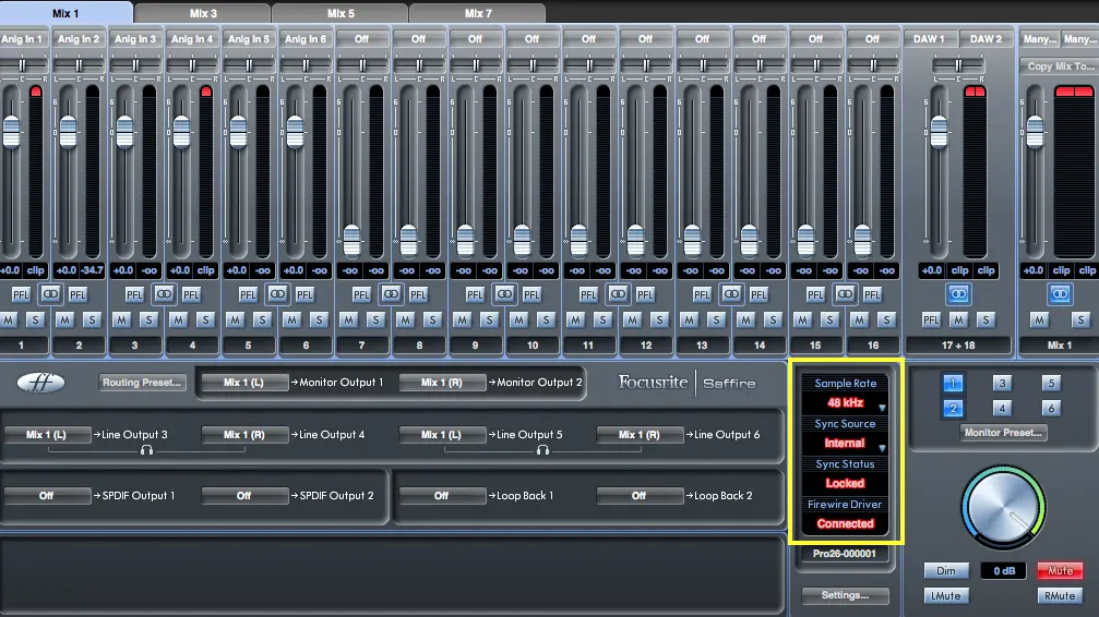

Do you have the Focusrite control application installed and have the 2i2 interface set to the same sample rate as the project in Audacity? (It's called Saffire Mix Control for my Saffire Pro 26, probably Scarlett Mix Control for yours.)

Honestly, no idea. I just know that on the Mac, I have to use the app to set the F'rite to the Logic Pro project sample rate. "Assumed" it would be the same elsewhere!

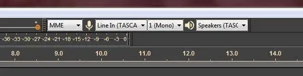

Yeah, I was at that page previously and the link it gives for the driver gets you to an 'ASIO' driver, but Audacity still uses MME within Windows. Perhaps the 'driver', while not able to use ASIO in Audacity, sets some of how the 2i2 functions for Windows.
My Tascam US-144 is similar. It shows the Tascam being used, but uses MME since ASIO can't be selected. There is a 'default' recording rate in Audacity, but that can be changed.

MME is the one you want. Your Focusrite should show up under Line In and Speakers like the images I put in post 13 for my Tascam interface and as well in the Focusrite link that was provided in previous posts >>> Recording with your Scarlett 2i2 2nd Gen in Audacity (Windows) – Focusrite Audio Engineering
