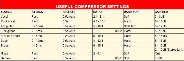

It's always difficult with new kit cos you want to be able to hear what you've spent your money on but with compressors its different, generally speaking if you can hear the effect working you are probably using too much.
I'e added a useful reference table to get you started.
Luck
Luck
Thank you sir, you hit it right on the nose. Just would like to hear my money at work lol... I'll try those and tweak from there.
Only question I have is, it says for vocal RELEASE 0.5s/Auto. What do they mean by that? I just have a setting for fast and slow. Also it dosent have a listing for THRESH?
