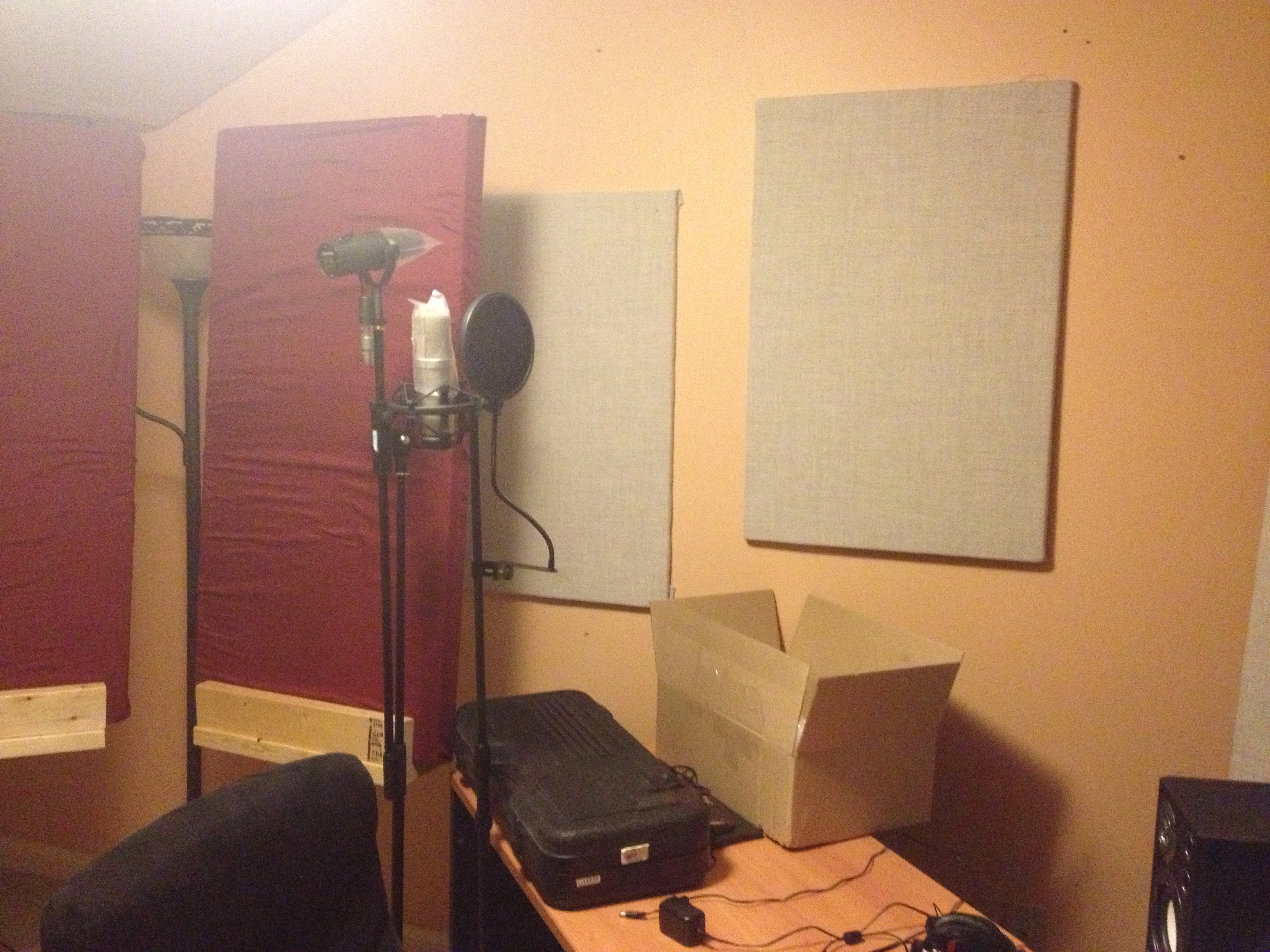

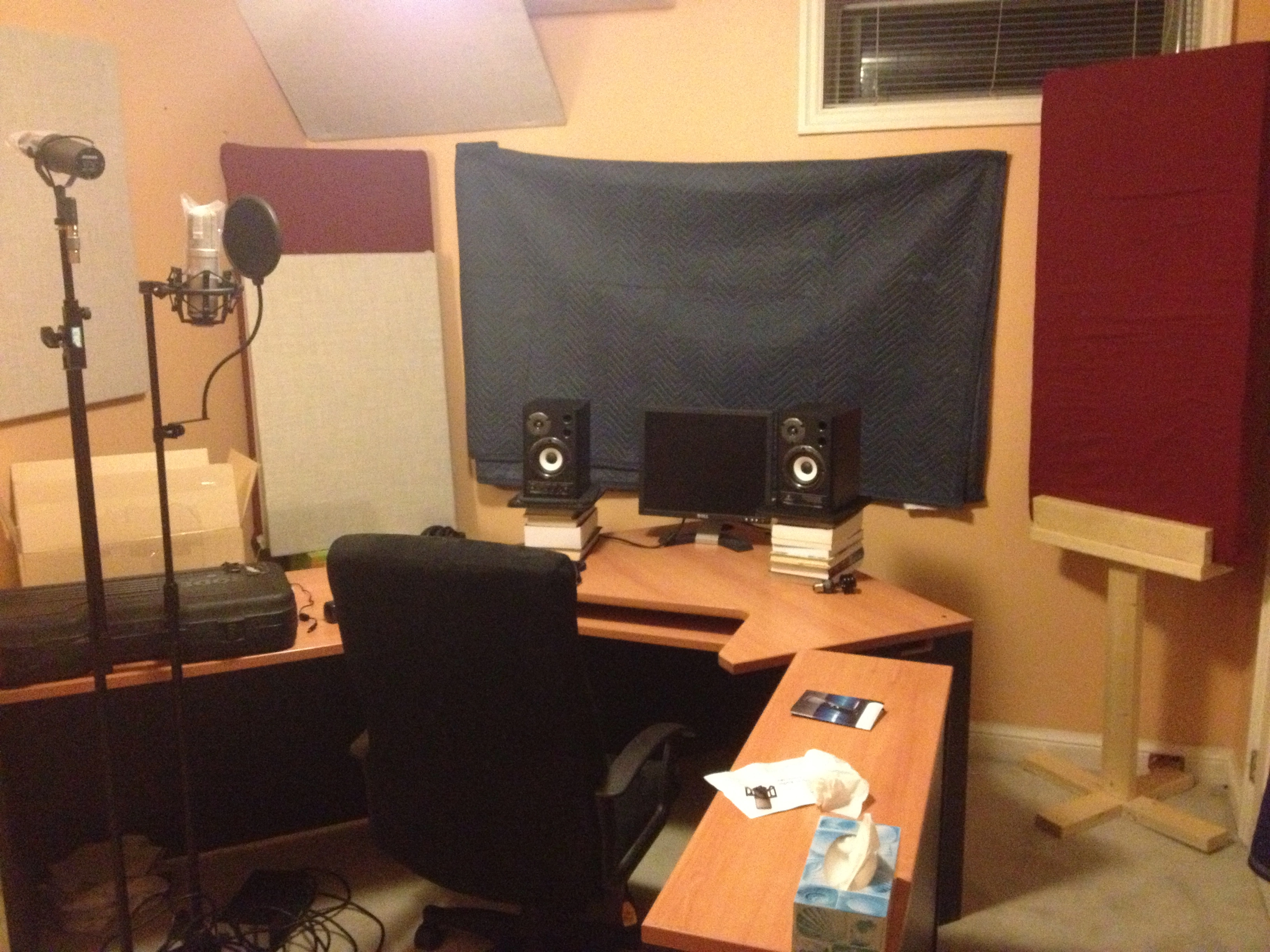

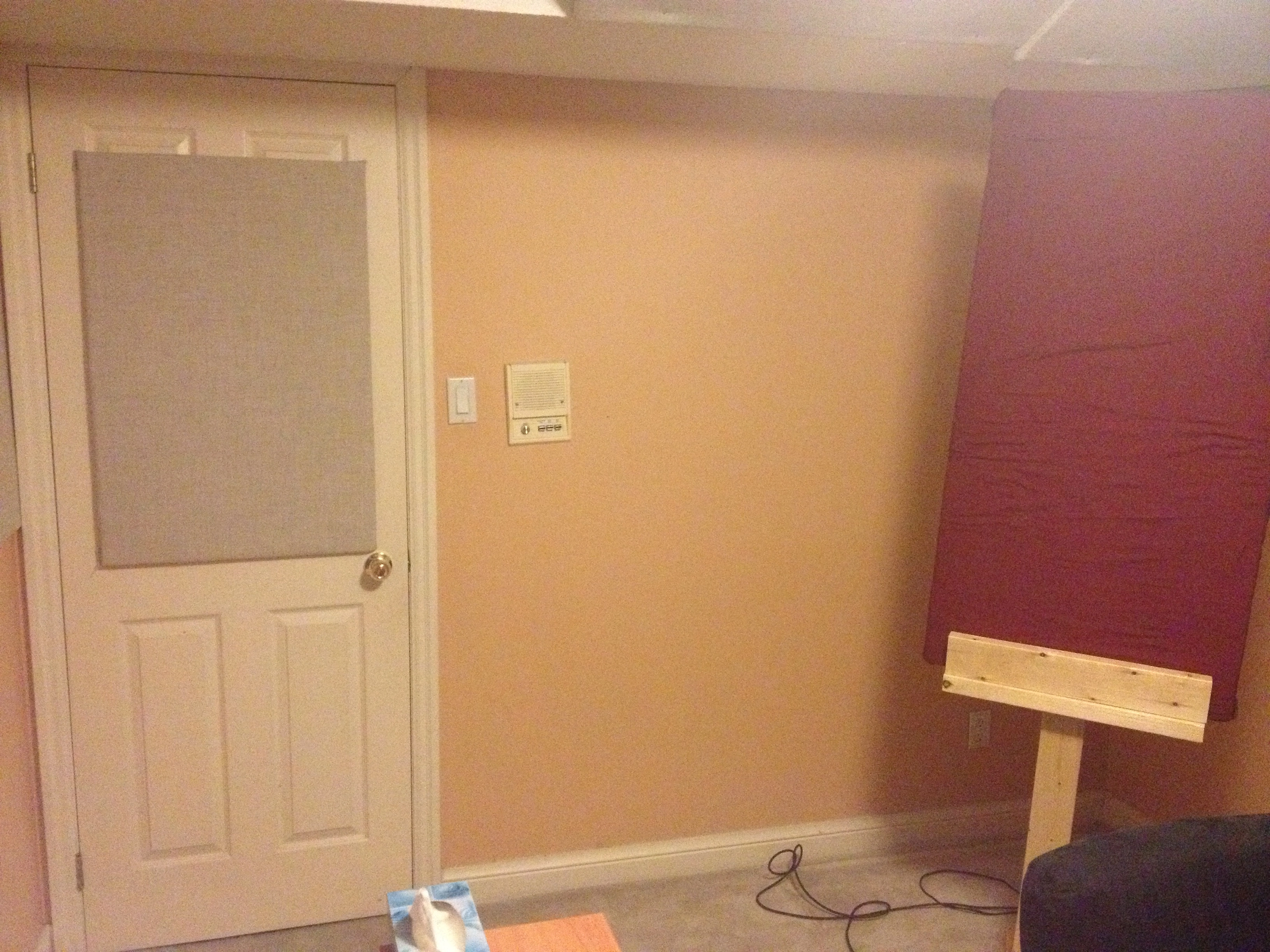

lots I'll post pics up, soon.
Its a 12x10x7.5 room and I have two bass traps at the front and lots of acoustic panels all along the walls as well as a gobo behind me while singing
here is my room!

How does my recording room look to you?
My guess: too much of the high-frequency content is being absorbed by the quilts. Will result in a very unevent sound. Try it without the quilts.
Yes I know a small reflective room, which you would understandably want to tame. But you don't want to do this at the expense of your high frequencies.

As for the room effect, unless I have a properly acoustically treated studio, I'm a big fan of close miking and simply dropping the room out of the equation as much as possible. I agree that the quilts etc. may be attenuating the HF--but this only matters if you mic is far enough from the source that the room is a factor. Get up close and personal via a pop screen and the room matters a lot less.
