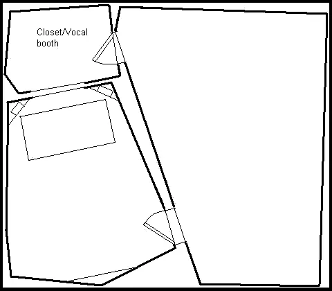

How would you divide up the space?
I'd go with gullfo's suggestion. I might not be inclined to split into 4 small rooms, but i can't really think of a way round that with a square room. The least i can think of is 3 rooms(or 1), but that doesn't really improve on gullfo's suggestion.
I fear that I may have to make it into two rooms, which are four sided, though not necessarily rectangular. This would allow the rooms to be used as something else afterwards, were I to move out, as well as being somewhat cheaper. Obviously I'd have to counter any acoustical anomalies with treatment.
What do you think to that?
I just remembered. I suggested this a long time ago for a square bedroom studio. It could be adapted to be more acoustically correct, but that might work.
