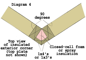

my fault - bad example in the drawing but simple enough when constructing - cut the base plates to join on the angle and overlap if double plate on top. place studs on 90 degrees to plates and fill gap with a ripped down blocking.
Ahh right, cool.
