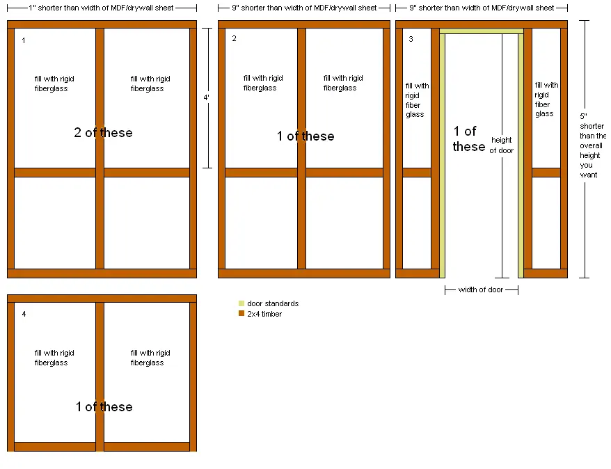

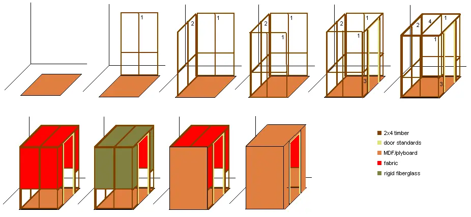

Here's my attempt at a step-by-step guide.
Build the frames as shown in first pic. Cut an MDF sheet in half(4'x4'), glue rubber sheeting to bottom for isolation (although if you have a carpet you may not need the rubber), and place where you want the booth in your room. Screw the frames to the MDF and to each other as shown. Staple fabric where shown(where the rigid fiberglass will go) to hold rigid fiberglass, and install rigid fiberglass where shown. (Cut and) Install MDF sheets, and install the door with rubber seals. Build and install the ventilation and wall box as shown before, add lighting, flooring, and decorate to suit.
Hope this helps, and that it is comprehensible.

You should need no more than 18-20 8' 2x4s, no more than 20' of door standards (maybe 5or6"x2" timber), 6 sheets of 8'x4' MDF or plyboard, you should need no more than 15m of 2' wide fabric, no more than 10 batts of 4"(20 of 2") rigid fiberglass, a door, two fans, XLR and 1/4" jack chassis, some audio cable, a light, flooring(maybe laminate), underlay, and rubber sheet(may not need). I have a feeling a missed something, but i can't think of it.

just a bit puzzeled over the diagram are the layers starting from the inside
fabric-rigid fiberglass-fabric-mdf/plyboard ?
any thickness mdf/plyboard ? or is it the thicker the better.
thanks

fabric-rigid fiberglass-mdf. The fabric is to hold the rigid fiberglass in place and stop the fibers from escaping, and irritating. The MDF does this on the outside.
And yeah, the thicker the better.

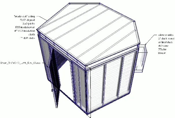

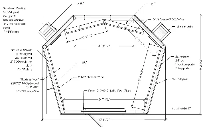

i've drawn up a simple booth suitable for drums or vox, if it helps.

gullfo
Whoa, thanks a lot:)
I'm gonna send a message to Rick Fitzpatrick now and see if he's willing to offer help in some way.

hi gullfo
any chance you could do that picture a bit bigger or put a link to it ?
looks perfect for what i am thinking about building.
thanks
