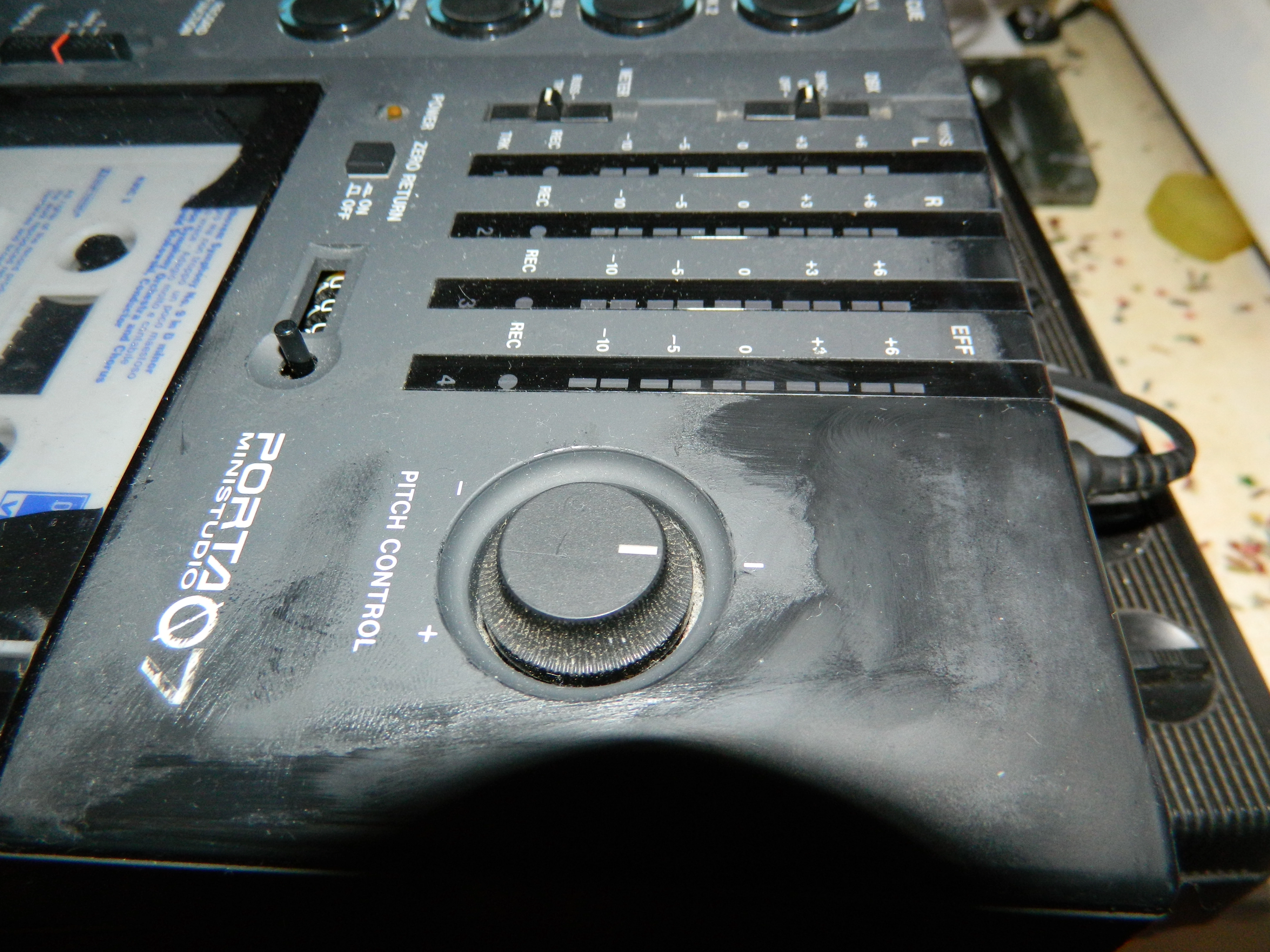

Yeah that was what I thought too, I've noticed that on a pre recorded tape I've been mucking around with that on the 07 I can hear a ghost track of the old music. On the porta two I can't, so I quessing that if nothing else the playback quality is better on the 07. I was wondering if anyone could tell me about the finish on the 07. Is it plastic with a thin grey rubberised layer on it? It seems that the grey layer has become sticky on my machine. I've cleaned an area on the back with various products and found that acetone will obviously clean that layer off back to plastic but it will also take all the writing off as well. Any ideas on fixing that???
Can you post a picture of the rubberish layer?
I've never heard of such a finish on any portastudio product. Maybe its just a film of grease/palm oil, dust and tobacco smoke residue? And if so, any household dish detergent should help to break up the grease but it might require introducing liquids into the guts of the machine and that would kill it. The only safe way to do it is to take the machine apart and soak the casing in hot soapy water for a good long while and then do some gentle scrubbing with a soft cloth.

Ok Here's a picture, the darker area is cleaned back to plastic the light grey is the sticky area. Is the the original colour?

I'll venture a guess.
It is a painted surface, and the finish has failed.
It may be related to cigarette smoke or a corrosive atmosphere, such as city smog.
:spank::eek:;)
It's hard to tell from the picture but it also looks like sun/heat damage to the finish. And if so, I don't think you can clean that off. Cigarette smoke would leave a yellowish tint to the surface and that would yellow the white lettering which still looks white. So it was probably sitting by an unshaded window for a good while and got discolored from the sunlight. That's not fixable, in my opinion.
Also, I don't believe the surface is painted though. That color is mixed into the plastic at the manufacturing level when it was still in a liquid state.
Cheers! :)
Yeah I thought that might be the case. According to the seller it has lived in it's box for years. It came from up North which is quite humid in our country, so that might be it. I may try and seal it with clear coat so it doesn't keep rubbing off on things and leaving grey smears on my fingers!!! Thanks for the help guys, much appreciated, I'll start having a play.
