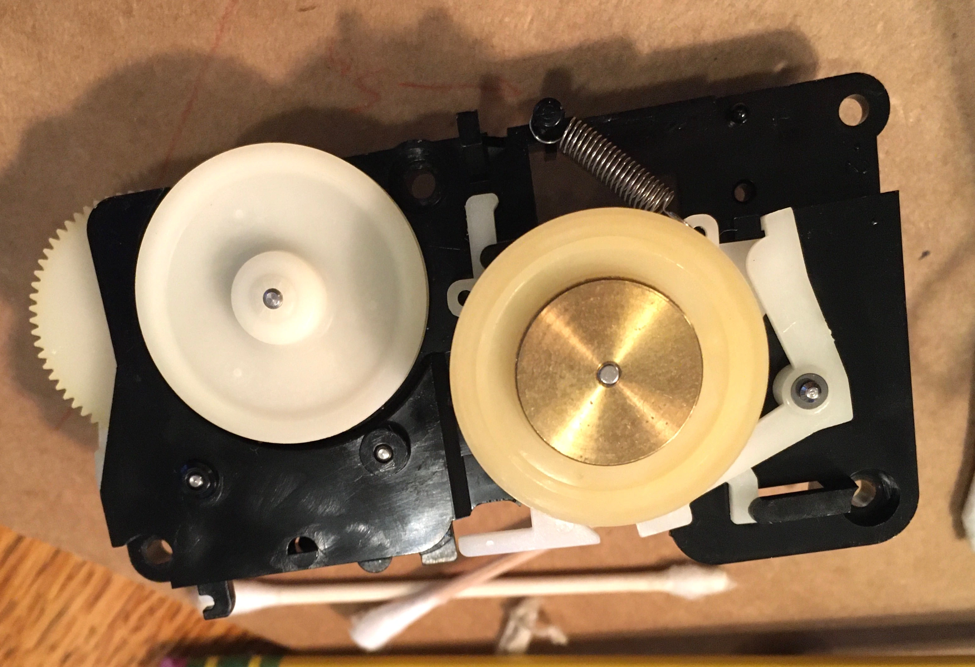

Here's what I see when I remove the black reel plate from the transport assembly.
Is that idler tire troublesome? I can't tell just by looking at it. I cleaned and relubricated what I can see, *while keeping this whole thing intact*. Mainly because I haven't figured out how to disassemble the take up reel/idler section further. But I'm starting to think I should learn how...
What I do know is if a little bit of force is added onto the tire/reel point of contact (either by pressing down on the tire, or left on the lever it's connected to), then it drives the take up table much more reliably. Does this mean it's worn?

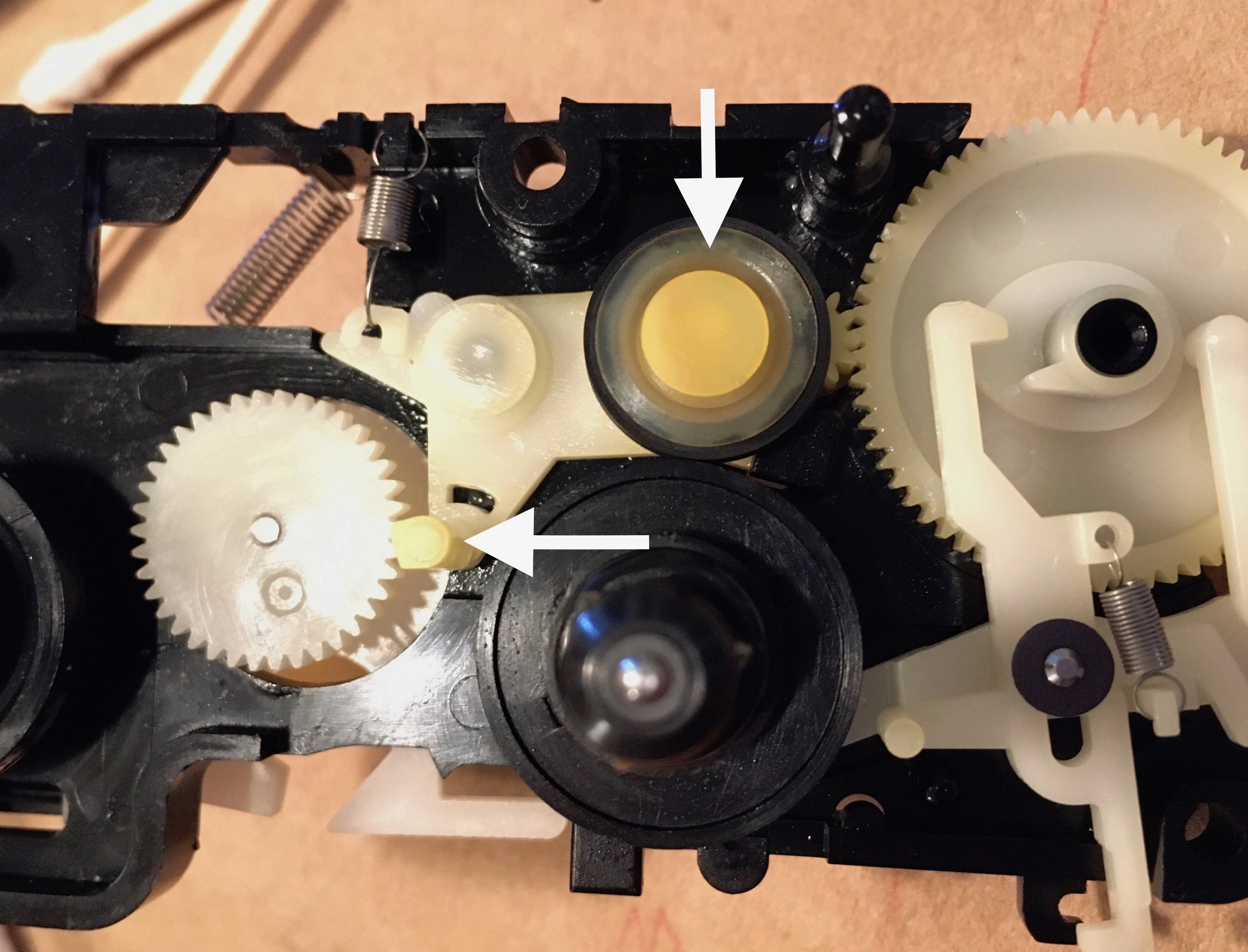

Here's the point of (non) friction between the idler tire and the take up reel.
Quick googling shows that someone is selling tires for the Porta One, and a bunch of other machines, but not this one!
A youtuber made a new one out of a couple rubber plumbing washers, for the 244. I love the inginuity!
Porta Two is sadly not represented in the DIY idler fixing scene.
Ive found in many machines that to be an idler tire symptom. Its a good idea to replace all rubber.

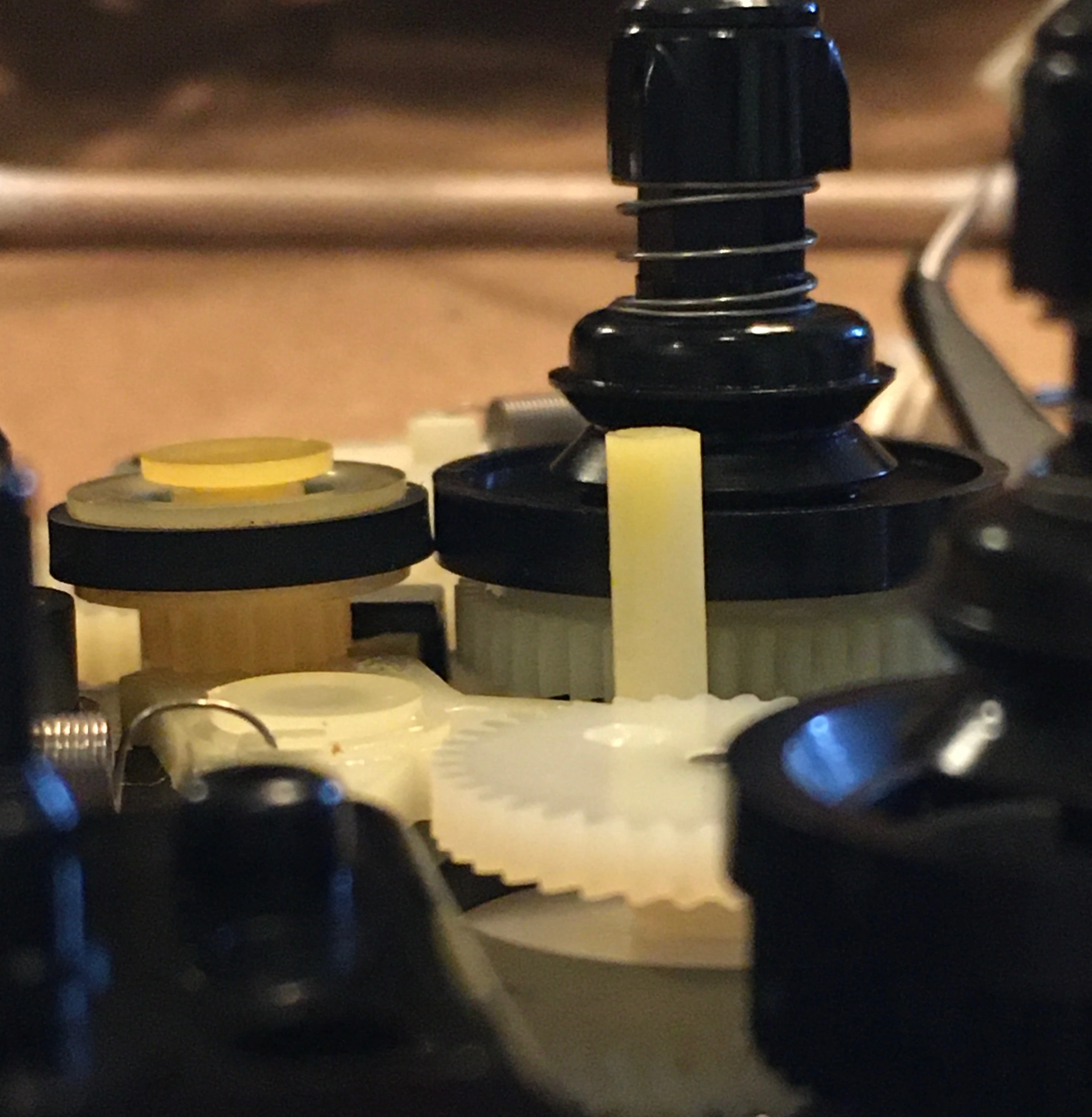

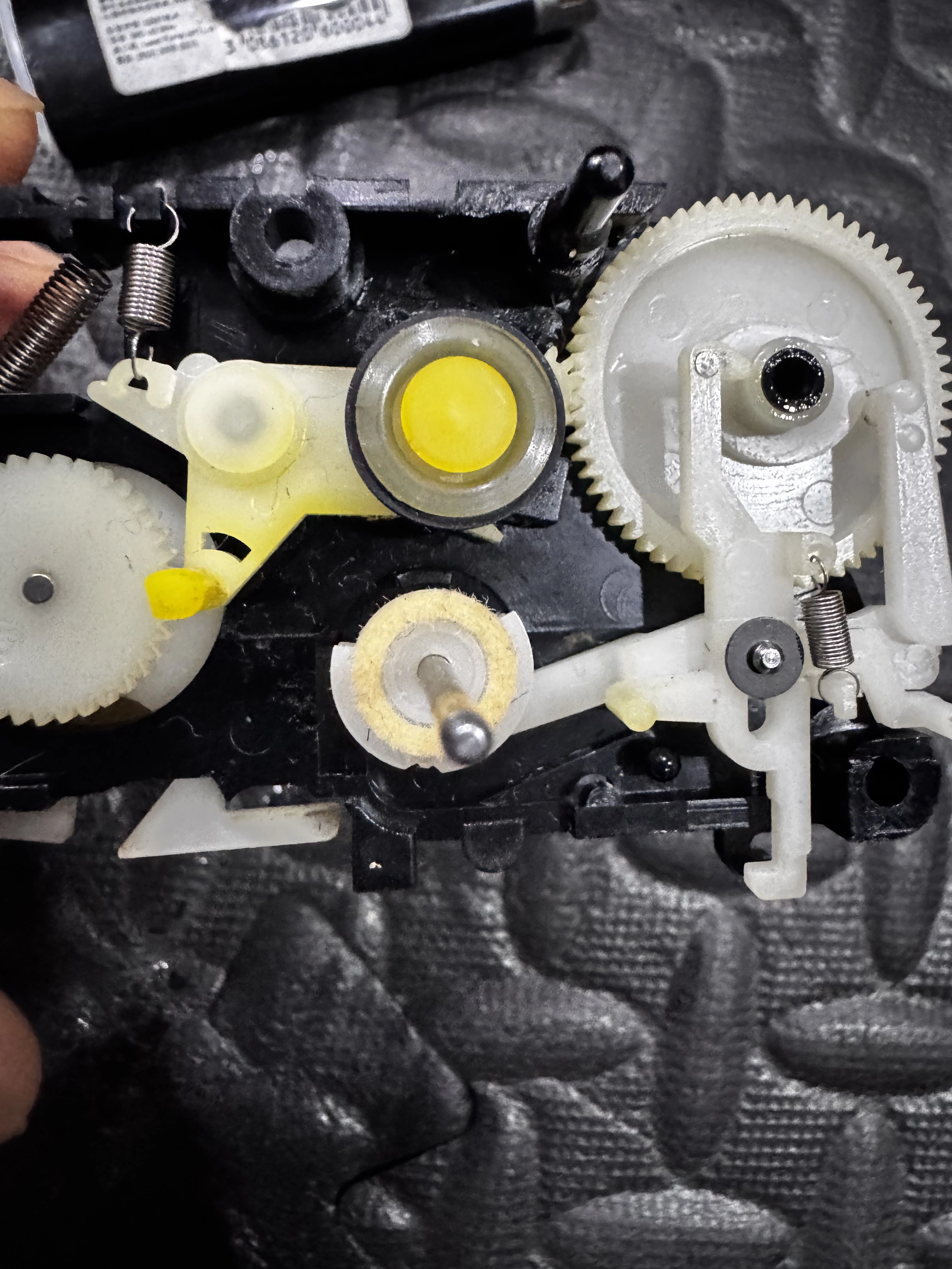

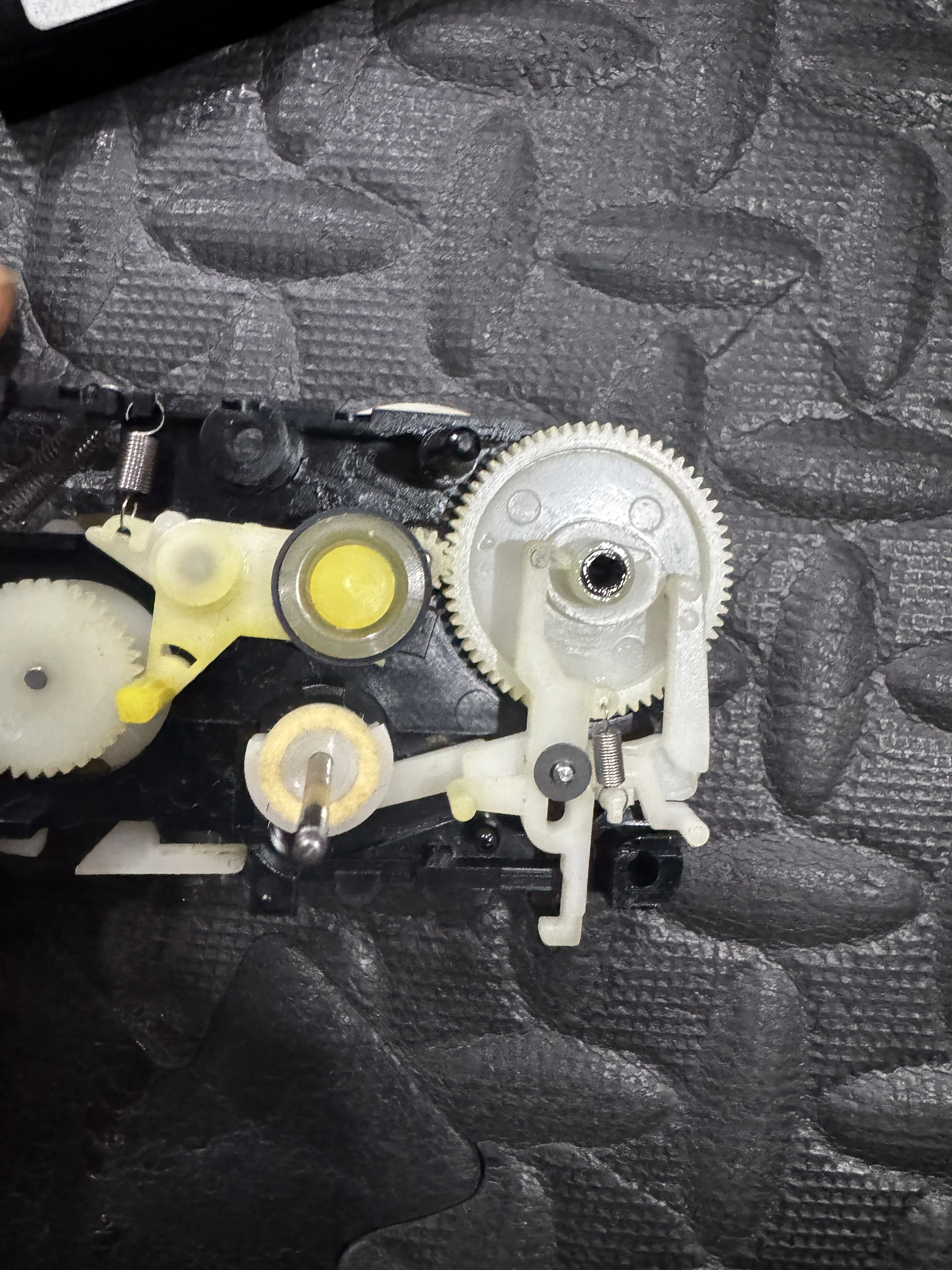

I removed the idler tire/arm assembly (by lifting that little white plastic pin/cap thing to the left of the tire) ,cleaned, lubed, and then...kinda improvised a fix.
I took off the tire from the wheel, spooled a bit of thread around the wheel and put the tire back on. It's working wonderfully for now.
This only worked because the rubber is in decent condition, certainly better condition than the disintegrated or chewed up ones I've seen on youtube.
Not a permanent fix, but it's great to have this one working for now to at least test record functions and such.
