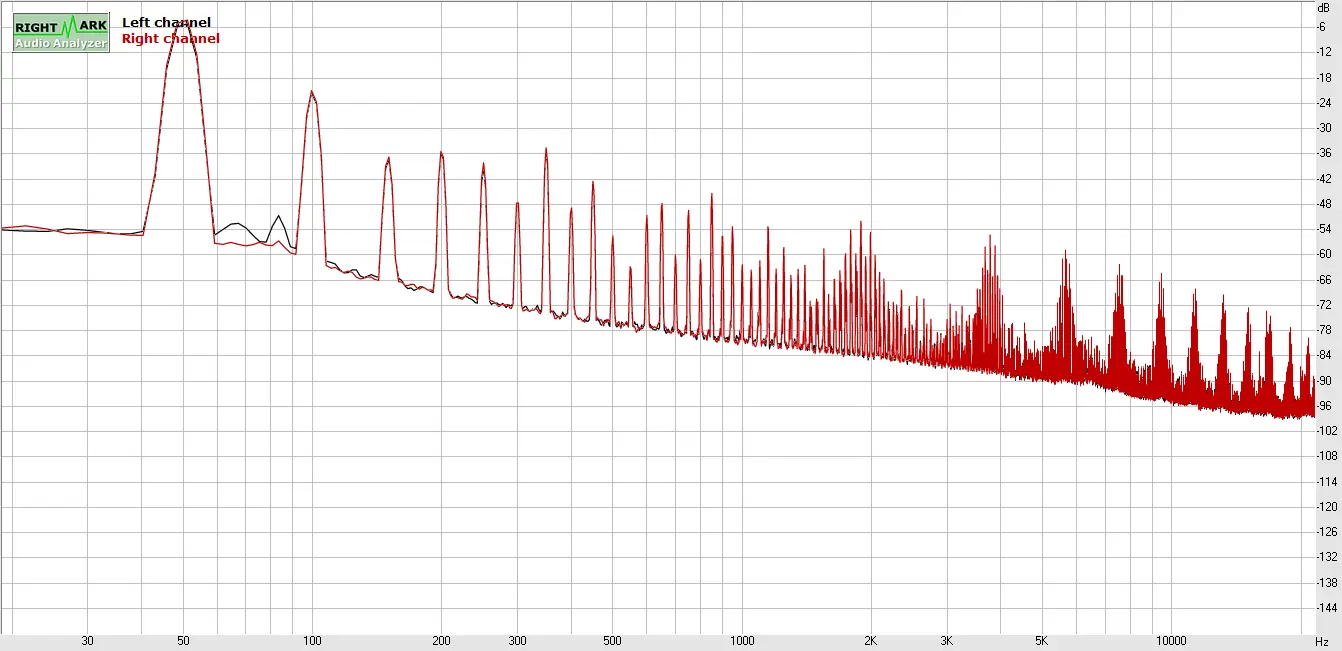

Can you record "the bit of noise" and post it? (attached as 320k MP3 works best for me. 10secs as .wav would be better but, Hey, ho!)
Ok, that noise spectrum tells me the pickup amplifier and USB converter it working, why?
The steep downward slope of amplitude with frequency and the MUHASIVE! amount of 50Hz hum and endless harmonics!
My bet is the cartridge is buggered in someway, open circuit? Could be the stylus is displaced but then I would not expect it to track a record.

Its odd because when i play the record i can hear a little bit of sound from the recordplayer itself but really quiet.
What does that tell you?
And what do you suggest i do next?

Sorry, been a'bed! That tells me the stylus is probably properly seated in the cartridge cantilever. What you hear is called "needle echo" something the beardy tweaks strive to shut out.
This also means to me that it is the cartridge that has failed...BUT! In some 50 years of messing with hi fi I don't ever recall one failing! Certainly not BOTH channels so, look at the tonearm wiring. Might be a plug adrift inside? You really need to test the TT into an amplifier.
