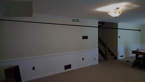

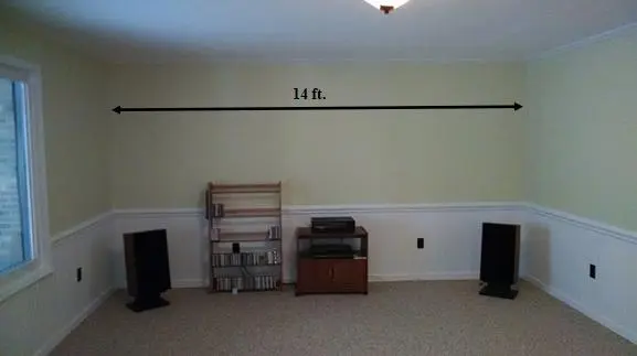

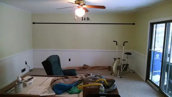

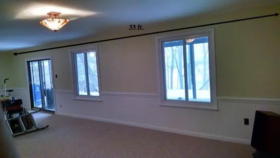

The room is in the basement level. This is a rectangular room measuring 14’ x 33’, with a carpeted floor over concrete and 8 ft. drywall ceilings. The walls are mostly drywall with 3 ft. of paneling on the lower sections. The 2 short walls are solid without any windows or openings. The long south wall has an 8 ft. opening where the stairs come down and the long north wall has 2 windows and a sliding glass door as well.
