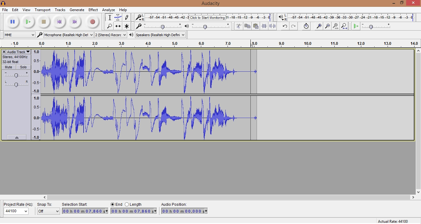

Just bought a new microphone from Amazon (InnoGear® Studio Recording Condenser Microphone) along with Phantom power supply 48V. Hooked everything up and the playback sounds like crap. So muffled and sounds like something is shaking because it cuts off at random times. Is it the mic? A faulty wire? my computer mic jack? This was pretty expensive purchase for me, please help. Attached it an image of what a typical recording looks like with this microphone with regular talking.

It's possible there's something wrong with the mic. It's also possible that you're singing into the wrong side of the mic too. I've done that myself.
It's too bad you didn't do some more research first. You're using the built-in A-D converter in your computer which is really not made for anything other than the 'beeps and boops' of computer sounds and maybe some voice-Skype type talking.
What are you trying to do - what software are you using? Sounds cutting out would be a buffer setting in the software.
BTW, at $50 total for mic and phantom power supply, you are at the absolute bottom of the barrel for this type of equipment - it may have been a lot of cash for you, but like everything: 'you get what you pay for'.
I did a bit of research which basically told me that what I was getting was a good value for its price. Software I'm using is a program called Audacity, also I cross referenced the effect with an online, flash based, editor on Soundation.com. What would you recommend I use for interface instead of my computer?

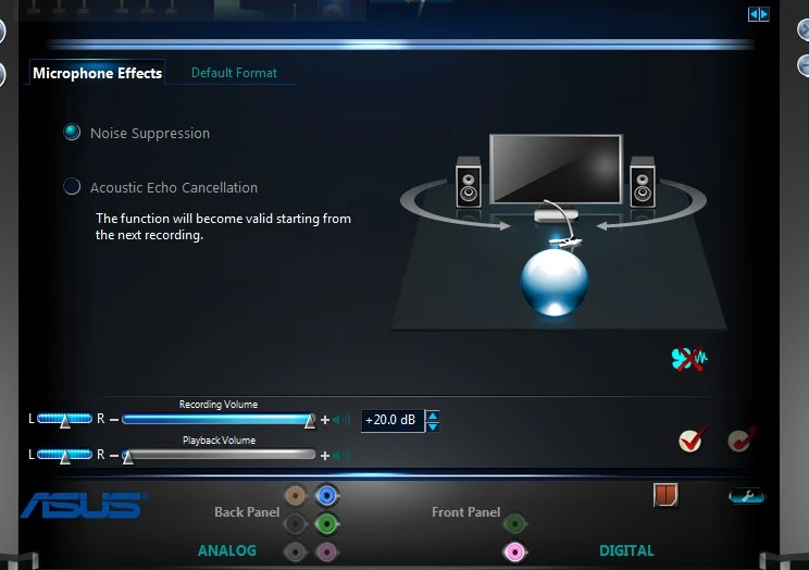

Is that an ASUS PC you're using? I see the Realtek soundcard in the Audacity selections. You may have similar audio control panel as below that can affect what goes to Audacity. Lower the mic gain (recording volume) if you have this or similar. If this doesn't help look at other Windows settings related to recording and the mic.

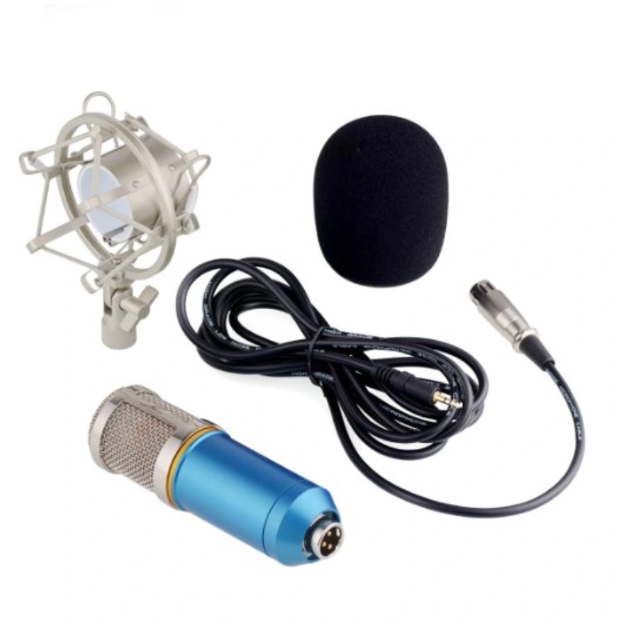

At that price point, I wouldn't expect it to be better than the built-in computer microphone. I think a low-end USB microphone like the Blue Snowball would be a far better solution. I've never heard of that company, and their Amazon presence appears to be as a vendor of flashlights, aromatherapy oil diffusers, and Bluetooth monopods.
I actually have tried it straight from the mic to the computer and the sound quality doesn't change. Yeah I'm heavily considering returning this and checking out another alternative. Just need some clear and at least semi professional sounding recording for voice-over work. It is ASUS, I will try that, but it seems like something is broken when that wavy crap happens because it gets choppy and the mic is still. Thanks for being nice and helpful, and not being a total dick.
