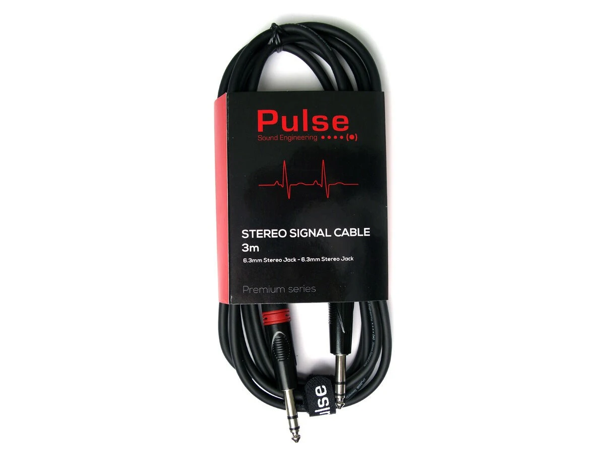

...does it come with everything i need to connect them to my pc and/or UMC202HD interface, or are there some things i will need to buy extra in order to be able to connect the monitors? Like, a Hosa CM-110 cable for instance, or? If so, do i need 1 or 2 of those?

Two of those is all you need - then a 2 wire 16 guage to go between the main speaker and the satelllite.
Do note that the speakers come with,
Included Accessories​
  • Speaker wire
  • 1/8" TRS to Stereo RCA cable
  • Stereo RCA to Stereo TS cable
yes . . . I take back everything I said.
It looks like they come with everything you might need.
Edit: I changed my mind. A pair of TRS to TRS will get you from UMC202HD to the Eris
However, the included stereo RCA to TS included will be fine.
  • Speaker wire
Aside from the Speaker Wire - the TRS to TRS is needed for a solid connection.
