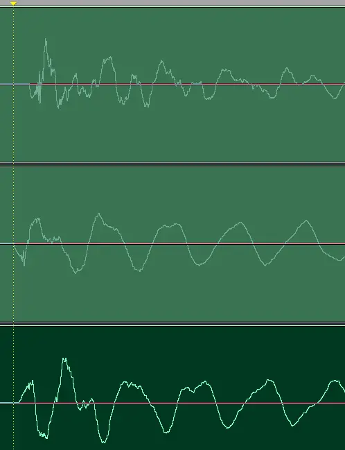

Here is a recording of a tom using three mics. They are set up the way many folks record a drum set. I zoomed in on the beginning of the waveforms so you could see what occurs.
Mic/Track #1 - Overhead - about 36" above the tom.
Mic/Track #2 - On the top head.
Mic/Track #3 - On the bottom head.
Notice in the picture that the Overhead mic (track #1) is about 2 or 3 milliseconds late due to being farther away from the drum head. It may be out of phase depending on the dominant frequency. To correct this we may need to slide the OH track left about 2 milliseconds or so until the kit takes on a more coherent or clear sound. The idea is to get the "ups" and "downs" to agree with the other tracks as often as possible.
The bottom mic is out of phase with the top due to pointing in an opposite direction. To correct this simply reverse the phase in our recording software.
mp3 that is original/unchanged, (all three tracks flat and dry)
mp3 with bottom mic flipped/reversed (all three tracks flat and dry)
mp3 with OH track dragged left 2ms (all three tracks flat and dry)
Moving the OH track, in this case, didn't offer much difference in sound. But it may have made more of a difference with the snare, kick, and cymbals all playing.
