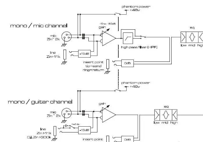

As you can see in the attached picture of a popular Mackie mixer, the phantom power is after the XLR inputs...the 1/4" inputs take a differet path past the phantom power.

And I suppose I could have answered my own question by using some common sense and looking at the schematic :p But yeah, looks like its separated from the trs/ 1/4 input and comes in before.

I guess you cant read schematics at all then... take a look... the phantom power in both instances feeds both the line in and the XLR... they are parallel.
If you dont believe me... plug a non balanced 1/4" plug into the line out, with the phantom power on...and see what happens :)
I should have mentioned before... on the phantom power.... there are no diodes between the XLR and the line in jacks to isolate them, except the one noted as guitar/mono, and it has the hi/z switch to disable the phantom power , and the voltage from the phantom power goes BOTH ways.

Uhh...those little double vertical lines on the wires inbetween the XLR and 1/4" inputs are the symbols for capacitors in schematics. Capacitors block DC like phantom power. In fact, those are specifically called blocking capacitors, because they are there to stop phantom power from hitting the 1/4" input.

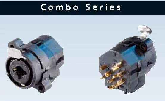

It really comes down to how thos combo jacks work. On his mixer, there is no separate jack for the line input.
I just looked on the neutrik site, it doesn't look like there is a way to connect the 1/4 separately from the xlr.
I would call Soundcraft.
nah, the combo jack separates the XLR from the TRS/TS still....they touch different contact points.

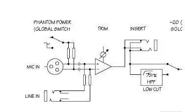

The schematics for his unit look basically the same as the Mackie one I gave above (except they allow Hi-Z input on channel 2).

Are you sure? That one has 6 contacts because it is a switching jack. The other 3 are the thru.

well, here's the Compact 4's schematic
They have to go to two different contact points...they're two different signals. If they're going to be passed thru the same amplifier, the line level signal is going to have to be padded. Yeah?

Just making sure, All the stuff I have with the combo jacks only has 3 connections and the Neutrik site didn't seem to address it.
hmmm, is there a switch for 'em?
and is this on a mixer or a device that only accepts line level?
