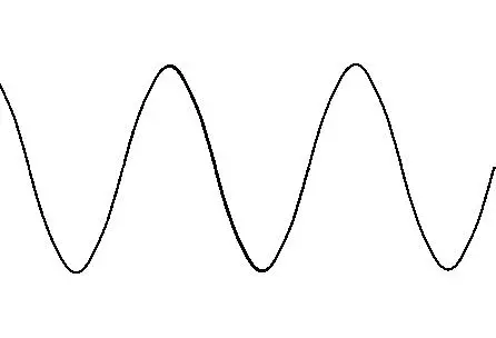

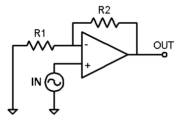

Now, any 'clean' boost, or straight preamp is usually just a simple op-amp, like so;
opamp1.webp sine.webp​

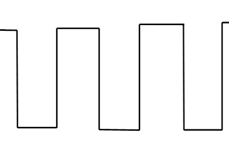

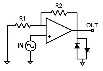

.......clean, and what goes in should be what comes out, just bigger. However, you can clip the signal, or square it off, and that's the overdrive/fuzz you typically get. Mild clipping is 'overdrive, whilst extreme clipping with over shoots is 'distortion' or 'fuzz'. You can clip the output in parallel or shunt;
opamp2.webp square.webp​

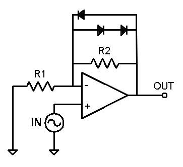

..... you can clip the feedback loop;
opamp3.webp​

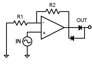

.....or you can clip the output in series;
opamp4.webp​

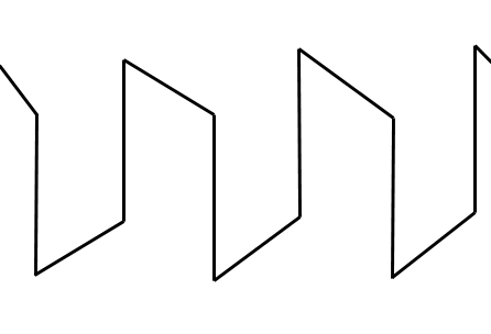

..... everyone does it a little different; even germanium/silicon/LEDs clip differently, then if you use symmetrical vs. asymmetrical clipping; the possibilities are endless. Some pedals use a combination of clipping. The trick is finding what you like. Harsh clipping with overshooting is fuzz; and on a scope may look like this;
distortion.webp​
Find what you like, which is a never-ending hunt. But damn, it's fun.

The Fulldrive 2 is a Tube Screamer, regardless of what anyone says. Symmetrical clipping in the feedback loop, like a TS9, but slightly 'darker' tone control. If you like Tube Sceamers, you'll like the Fulldrive 2.

The OCD is really different in that it uses MOSFETs configured like diodes for the parallel clipping. However, with four versions of the OCD at last count, who knows how they'll all differ to your ears. Apparently MOSFETs have a slower response time, so it gets sold as sounding more 'tube-ish'. LEDs do the same thing. I popped a set of LEDs in an old MXR Distortion+, and it's a different pedal. Much smoother and creamier, much less harsh. I think some versions of the OCD used diodes, but maybe Zeners?
