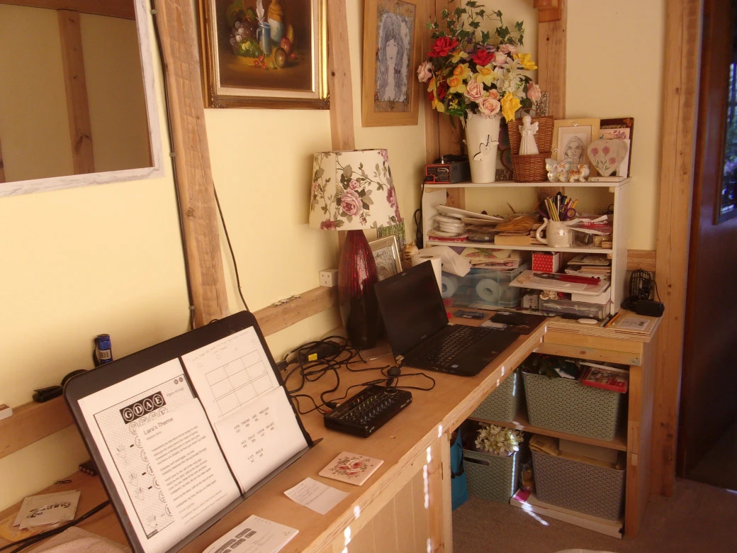

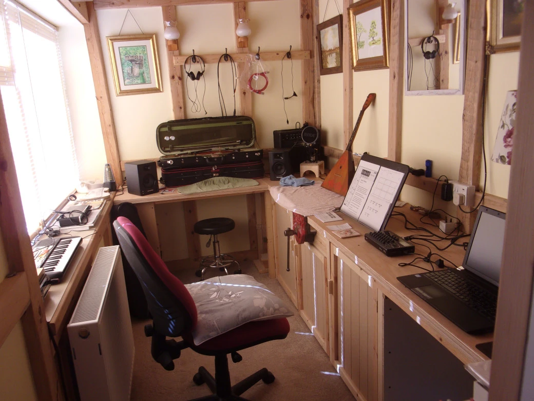

My studio is small measuring 144" x 78" with 96" ceiling height; door at one end and a long glazed window.
Gear so far;
Tascam DP- 008EX

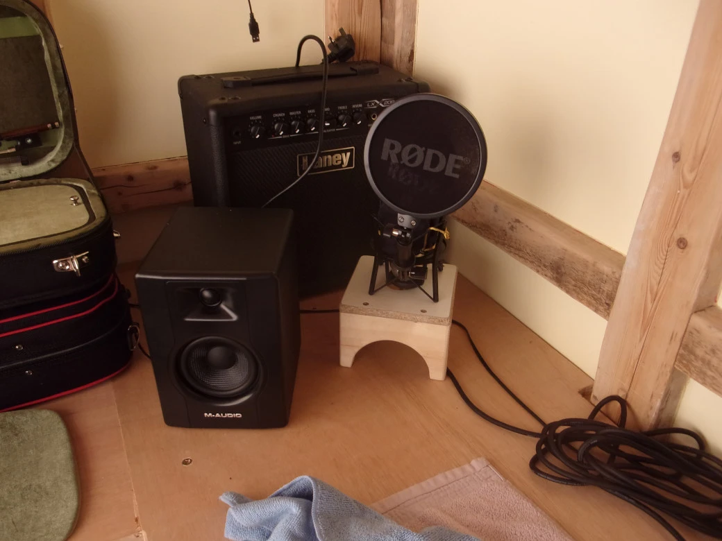

Rode condenser mic on home made stand at the moment due to space problems.
Guitar amp Laney LX20R
M-Audio amplified monitors.
Behringer UMC404MD interface.
Laptop with 8 gig ram and SSD drive.

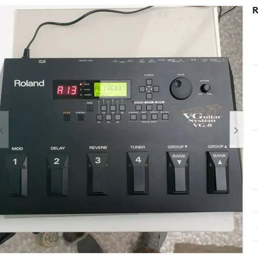

I mostly play/record/play back my German violin but I'd like to try different sound effects. I watched a girl playing her violin on YouTube and she was using a foot pedal this was a Micro-Pod and I've been trying to find this pedal here in the UK but she was in America so the pedal not available here.
Please treat me like a total novice but I'm spending far too much time trying to research and understand pedals; pods and synthesisers etc at the moment I'm baffled but I'm a quick learner and I do have some funds available so can anyone clear the fog a bit please; I see lots of electronic kit for guitars and wonder if this would also be of use to me with violins and if so any suggestions please; what to search for how to connect up for playing directly through the amp using the pickup and how to record through the Tascam using the pickup; at the moment I can record using the Rode mic on phantom power but if I try to use the amp then massive distortion sets in due to cross talk hence I've now bought the pickup.
There are lots of such kit on eBay as shown above but could I use it with violins please?
Sorry to be vague and possibly I'm not asking the right questions regarding kit but at least I've now asked and jumped in at the deep end. I've already received help on the Tascam section which I'm truly grateful for and am now aware of feedback due to the confined space.
Kind regards, Colin.
I guess you can use most multi effect units for guitar also for violin. The question is how you record the sound. A mic in the room or a pickup system attached to the violin?
With a (piezo) pickup the system should behave like any acoustic guitar with a piezo system.
With a mic, you have to check if the signal needs to be boosted or if your FX unit has a dedicated mic input. Also you will record hall from the room (which can be good or bad, depending on the room sound).

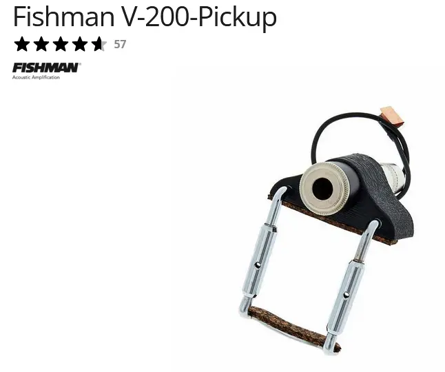

Thanks so much @Slouching Raymond for the useful information. I mentioned the pickup is a "Fishman V-200" which is due to arrive soon so as yet I'm totally ignorant of using a pickup on a violin;

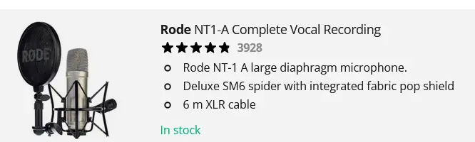

I've also got this Rode condener mic;
Excellent tip regarding using headphones; at the moment the only phones I have are very cheap eBay items so I could upgrade without problems also the tip about using the interface with the Fishman pickup; I can try this once the pickup arrives.

I looked up your pick-up, which is piezo, and requires an impedance matching preamp. I'd just plug it into your interface, and see what you get.

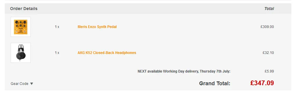

I'm now well sorted having just bought the two items seen above; 3 year warranty on the pedal; not the cheapest pedal but reviews state it's a good one so rather than mess around dithering what to do I bought this pedal knowing I'll never need to upgrade for my needs but it sure looks interesting to play around with.
The pickup I bought can be used without preamp but it's recommended to use a preamp so I'll suck it and see.

I enjoyed the pleasure of playing my violin directly through the Laney amp yesterday afternoon; the new Fishman piezo pickup is excellent and was fitted into the bridge with the aid of a bit of trimming of the bridge using abrasive paper doing this gently not to cause damage and not to remove too much material.
Without a preamp it was plenty loud enough and I also enjoyed using the new phones; it sounds really strange through the phones but nice and I could wind the volume up a bit without annoying neighbours. I need to get used to the amp controls.

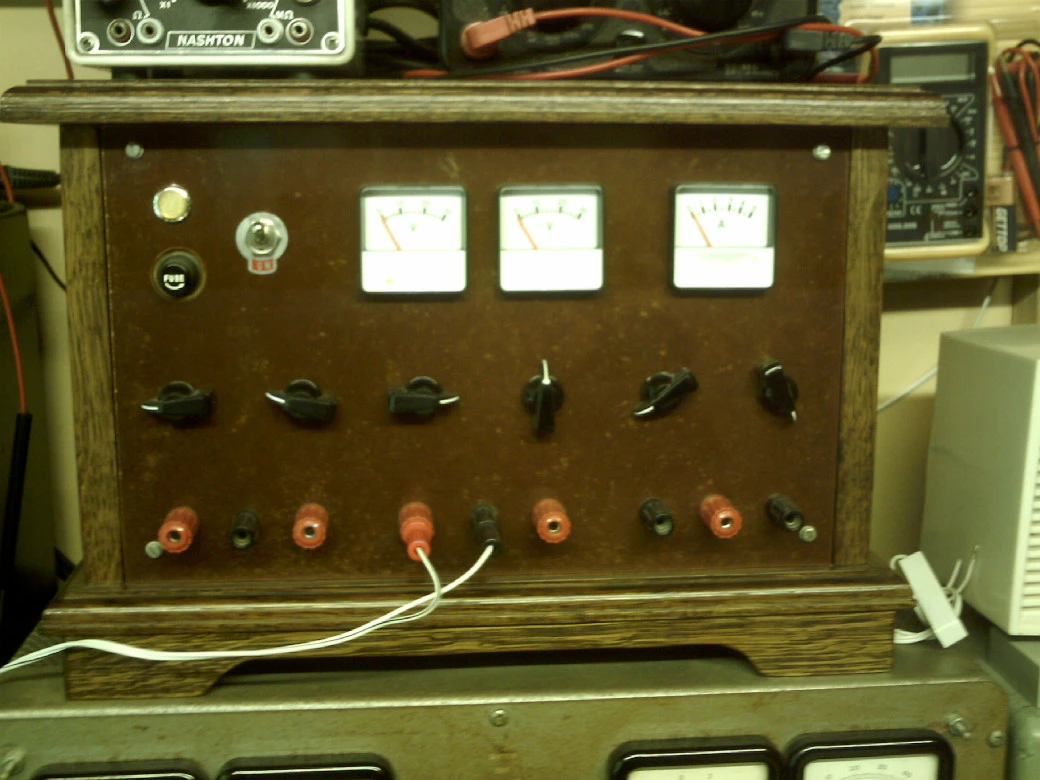

I ran into a slight problem with the Enzo synph; these aren't supplied with a power supply but because I play around quite a lot with electrics I always have a selection of power supplies; no problem I just collected a 9VDC power supply from the workshop and plugged the Enzo in only to find it was dead; out with the DMM and take a voltage reading and the power supply was fully working. During all my years of using lots of power supplies I've never known these can be bought with "Negative Center" so I live and learn; yes it needs a negative center power supply so I've now bought one through eBay but last night I severed the 9VDC lead from the supply I already have and cross wired it; now the Enzo is happy. I just didn't expect this.

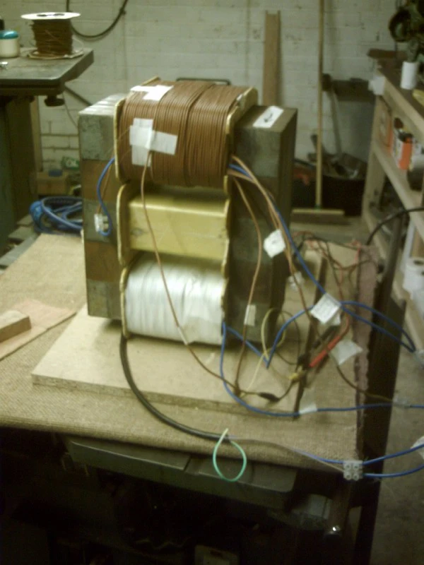

I used to restore vintage valve radios and these always needed transformers rewinding in fact transformer; coils and chokes etc; I used to rewind them all and eventually knowing how to rewind transformers I quickly learned how to make bespoke power supplies one shown above; this supplied both positive and negative DC outputs to suit the vintage battery radios the batteries no longer available; this power supply had two transformers for high and low voltage the high voltage in 10V increments controlled by Zener diodes from 70v to 160V via a wafer switch and power transistor.
Here's the largest transformer I wound when I installed 3 phase 415VAC into my workshop to power the big machines; it weighs around 75kg and here's it's on test.
I can't believe I got caught out so easily powering the Enzo so I thought it worth adding for others just buying an Enzo; music studios and equipment are new to me so I expect to make mistakes but I learn a lot from these mistakes.

Yes, you have to watch out for polarity on these things. I always read the tiny labels on the adapters and equipment, and refer to the manual.
The writing on those labels can be very tiny indeed. Sometimes I have to resort to an eyeglass.
There was probably a protection diode in the Enzo, but you can't always count on that.
