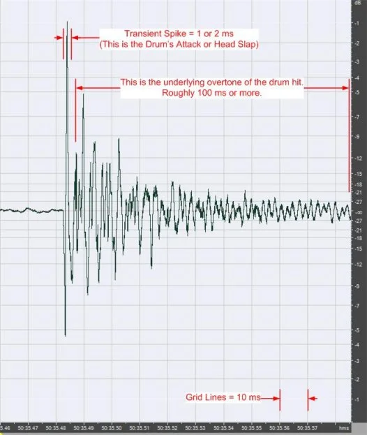

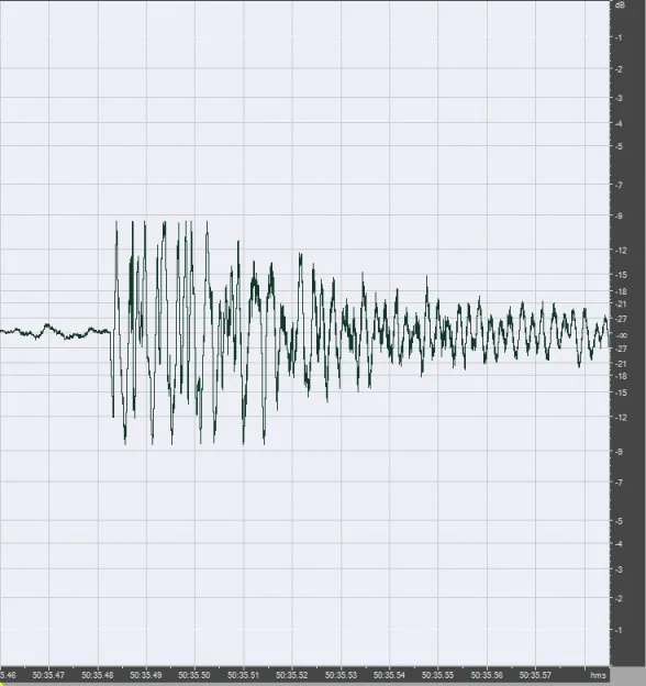

I simply made a duplicate copy of the snare track and pasted it to a new channel. For that new channel, I edited the waveform using Waves L2 Ultramaximizer. It is a brickwall peak limiter that chops off the transient peaks and pulls up the underlying head and shell overtones by using makeup gain. In a way, it sort of follows the classic gated-reverb theory by stretching out the body of the waveform to make it more noticeable and distinctive.
If you study the second (compressed or limited) waveform picture, you'll notice that the transient peak is gone and the underlying information has been pulled upward for several milliseconds.
I blended the two channels using the faders until it sounded good. After A/B'ing the results, (by muting the second channel on and off) I could tell it definitely added a "fatness" to the drum which brought it forward in the mix without adding much gain at all.
