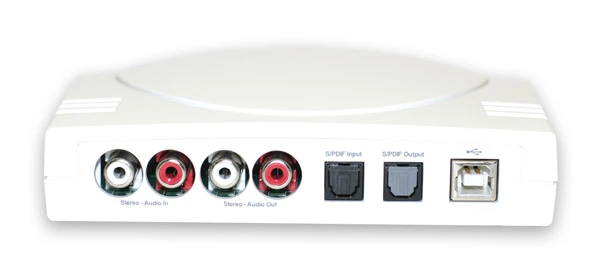

1) Greg's suggestion of a USB port into your computer. You would need one of these INSTANT MUSIC RCA to USB converters (or something similar). You would send from the tape outs to the RCA ins on the converter then a USB cable from the converter to the USB port on your computer. You can use the main outs instead, you just need to change from 1/4" to RCA to go into the converter.

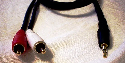

2) Line In to your computer should be stereo input. Send the tape outs into a RCA to 1/8" stereo converter, then into the line in on your computer. Or send the main outs to a 1/4" to 1/8" stereo converter then into your line in.
