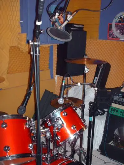

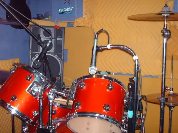

Here's a partial mp3 of the drum tracks for my last song.
The drums alone are named CMR Drums, the entire track is Catch My Recovery.
Here are a couple pics of the kit/room. They may or may not give you an idea of the room.
