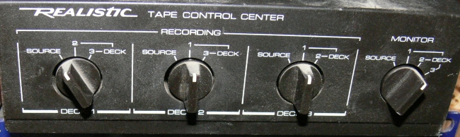

A lot of stuff over here is routed through tape loops(four). Generally, my little rack is on one tape loop. For messing around, you may have onboard sound jacks to employ. Just buy some stuff and get with it.

I've been doing it since forever. I can use three devices if I need to. I end up on headphones for fine settings, anyway. But ya, my ECHO Gina 20-bit sounds wonderful and has 8-out and was under $10 off eBait. With a tape loop, out can go to the speakers and the signal is live on all the other jacks

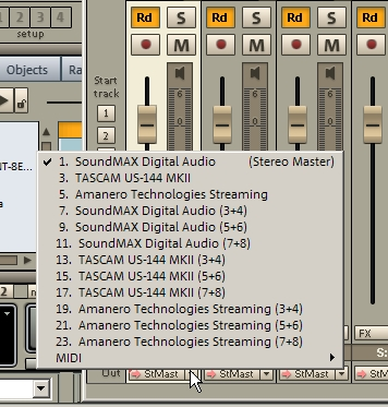

In my current DAW, I can send a track to any output device, not just the 2-buss.
Toss that out patched into the outboard
out of comp to whatever input
in daw set new track to rec monitor that input
Out to outboard, and in to input
How the hell would I know ? I don't even know if he has a DAW.
A clip of random output devices that were here at this computer for track 1, and , PIC of loop routing box
