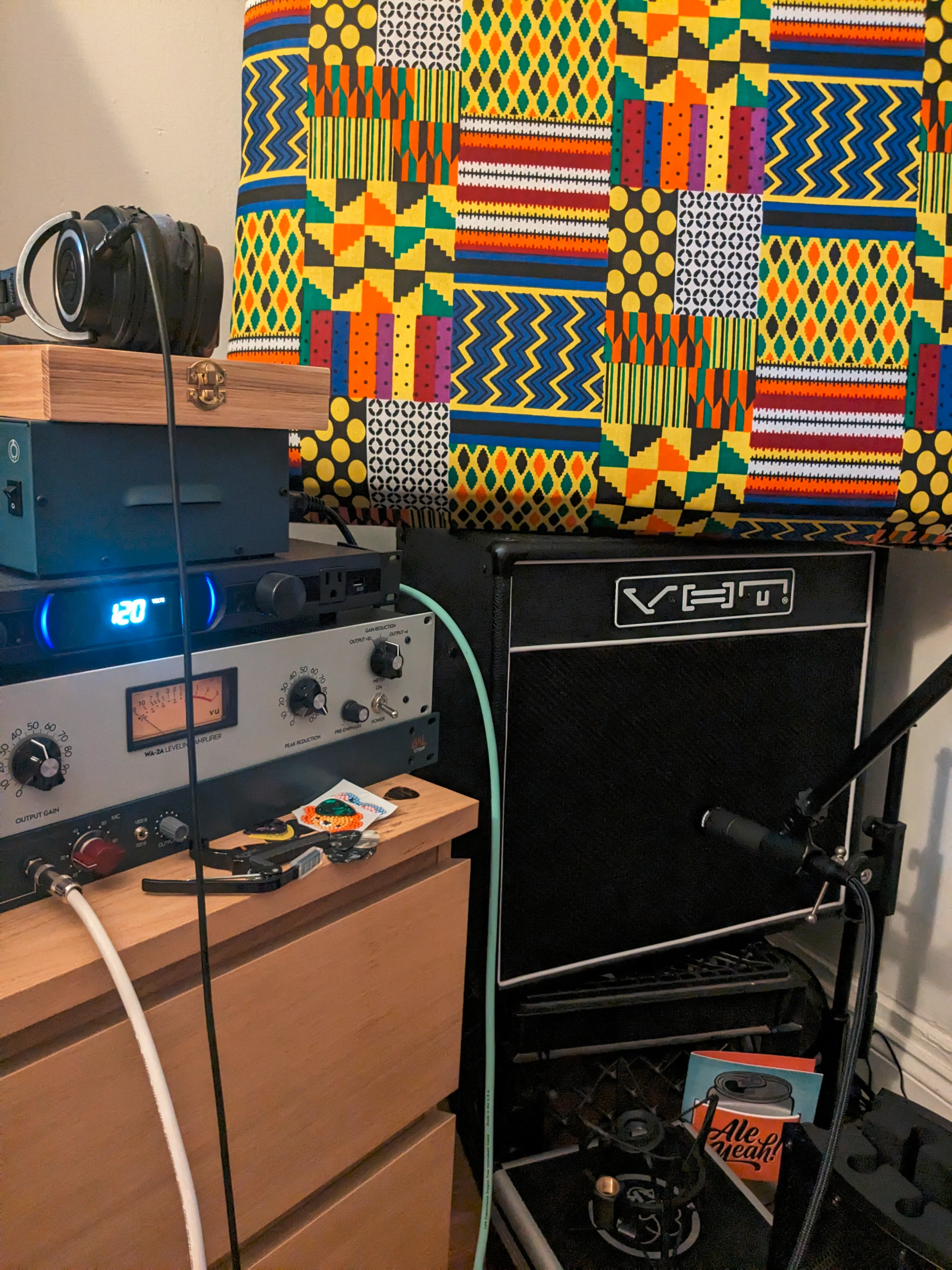

You are running a Mic PreAmp into a Compressor into a 2i2 Mic Preamp? Would you post a clip of this signal chain in action?
Yes, unfortunately this is the stupidest part of my setup. The Focusrite 2i2 does not allow you to bypass its preamp, so the already-preamped signal does go through another preamp in the 2i2 as it's recorded. I would prefer an interface with a line input to preserve signal purity, but you know how it is, I assembled this rig over the years based on what I was getting a good deal on at the time, and the 2i2 is very transparent anyway, so I can't justify spending the money on a new interface when it's not really causing me any problems. I just keep the 2i2 gain at zero.
If I wanted to indulge my perfectionist desire and GAS in the future I might prefer to get like a 6-channel mini mixer so that I can record several mics and have them all go through the same preamps, and an onboard EQ on the way in would be really nice too, but it'd be a lot selling and reconfiguring and all for like a 1% change when I could just spend that time working with what I have now to make new music.
Here's a photo of the setup, offscreen is the connection from the WA-2A to the 2i2. (Ignore the 1/4 inch plugged into the front of the 1073, it's not in use.) So here it's going mic -> 1073 -> WA-2A -> 2i2 (offscreen).
