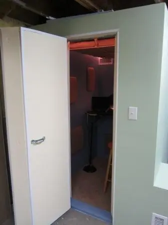

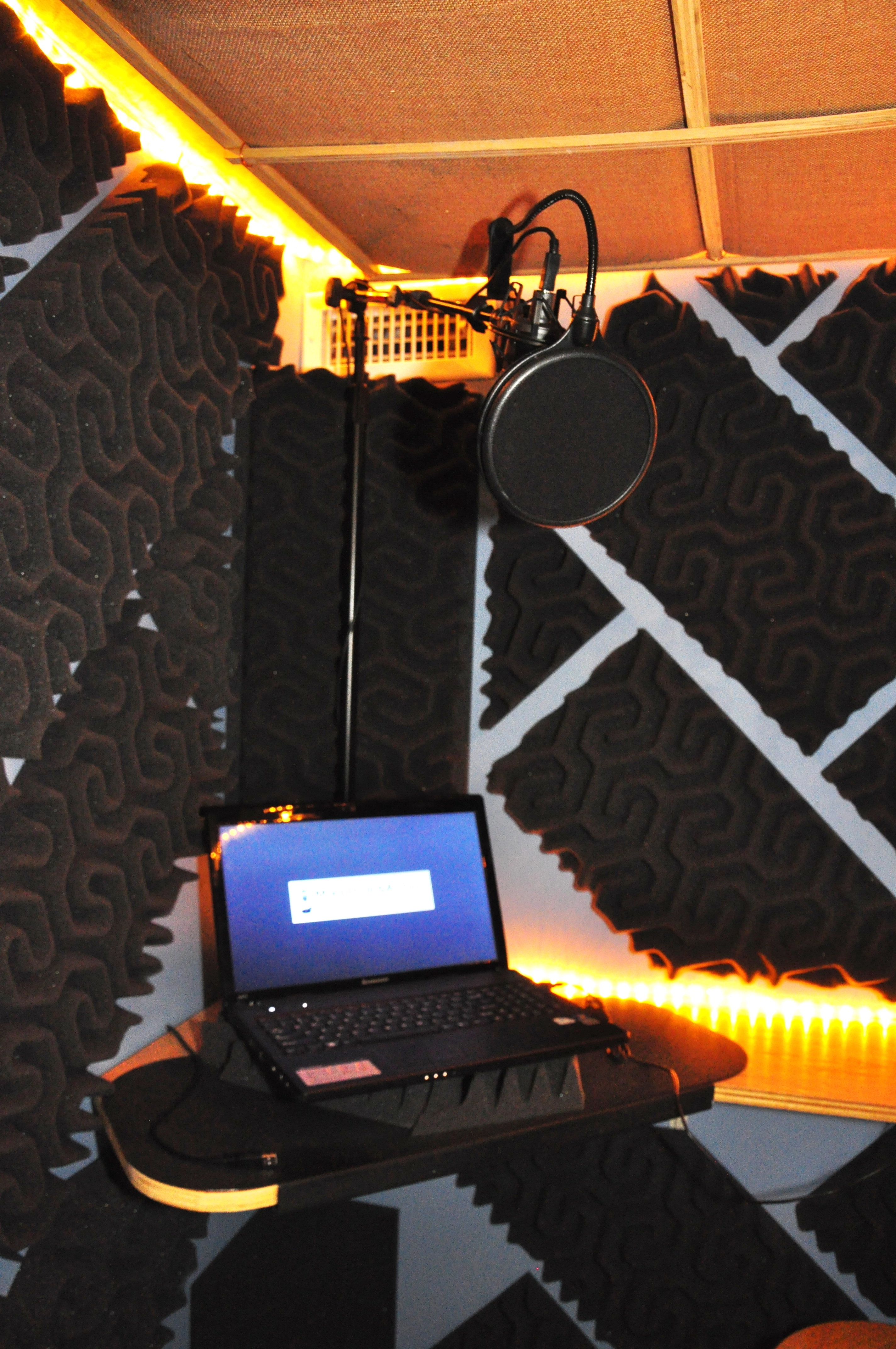

I built a vocal isolation booth for voiceover work, not a band. The interior measurements are 4' x 5'. I built the wall and roof frames with 2x6 bases and 2x4 studs alternating sides (but not touching both sides). Hung 2ea x 3/4" drywall on the exterior and a single layer on the inside.
I did not have rigid board, so I stuffed rock wool in the walls, weaving it through the alternating studs. Made the door the same way.
It works very well for isolation.
Good luck!
Mike
How did you hang the door? (i.e. what kind of hinges did you use to hold up that massive drywall block?) I want to make a 4x6x7 practice booth like that...
