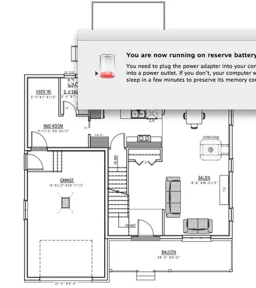

6. I would like to see the actual upstairs plan, as the stairway that is planned may or may not work according to other ideas, which untill I know your answers, I can't be sure of.
(note how my "idea" moves the stairs whereby you may have to have an "L" shaped Stairway with a landing at some point. This is what I am referring to. The reason was to allow a door under the stairway, without increasing Live room length while decreasing CR length, of which framing of this may or maynot be possible due to prior design limitations/upstairs elements. Also, I percieved the possibility of using the space under the stairs for HVAC/Plenum/ducting requirements)
7. Is there any plan showing the first floor framing schedule(nominal lumber size)/layout? If so, can you post it? If so, can you include any details/sections? Are there any beams?
8. Are you still working with your designer/architect?
That's all for now. As soon as you can answer these, and post anything you can in regards to the questions, I'll jump on the info ASAP and get back to you.

7. I will try to attach the plans, kitchen will be different however (same size, but island and cabinets will be moved around...)
8. Yeah, though she's being really unpleasant right now... she works for our contractor, not us, directly...
Thanks again (uploading pics being a bugger again...)
