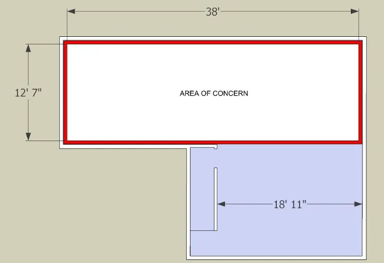

I don't know If I would have my mix room as small as 10x10. From what I understand you would be much better off keeping it all one room. Acoustics would be much better int he larger space.
I agree. One question I have is ...What is the author recording? Himself? Other solo artists? Bands? This alone will tell me something.
JF,
Do this if you can: (attached image)
This setup would work better acoustically but will be worse for access. You may want to look at other options for entry, stairs, etc. Or re-orient the studio working area completely. Doors in corners is not a good idea and ceiling height is a serious issue.
Cheers,
John

Ok John, back to the subject at hand.:D I probably won't post on this thread again until the author replies. But I was wondering something. I tried to use your Mode calculator, but I don't have Excel. Take a look here.(that is if I can get a damn attachment to work:facepalm:)...

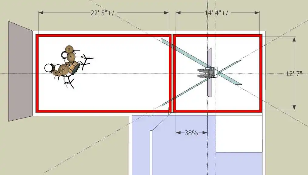

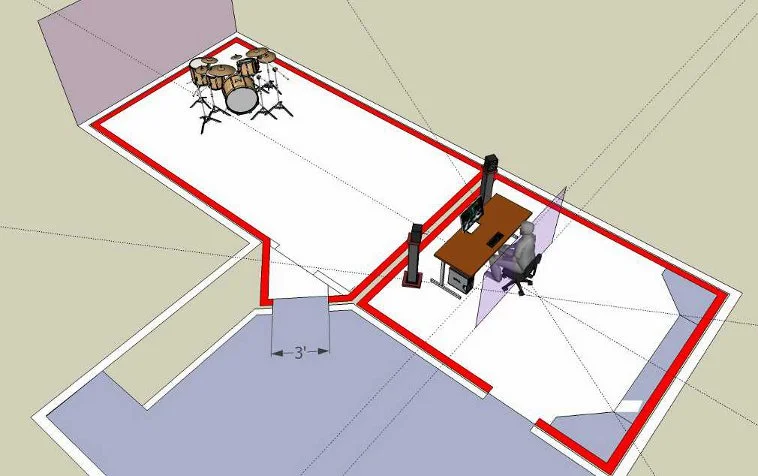

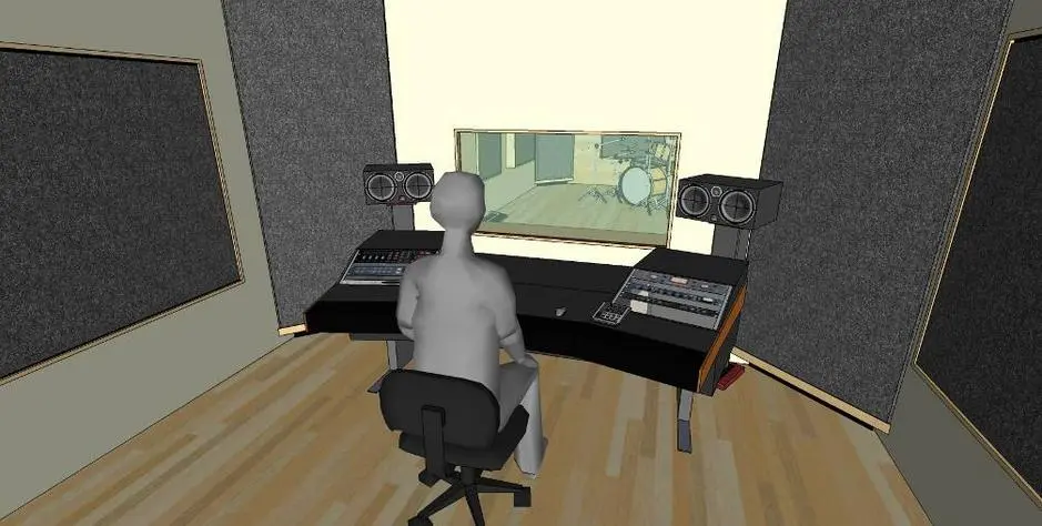

Ok, take a look. What this says is...the Live room door(at least in the available space and as per Johns recommendation)will DICTATE the length of the Live room..which in turn will kind of dictate the space available for a CR. Forget the third room.
The reason is shown below...ie...SCALE. When you look at simple plans, you really can't see the SCALE of the room vs a human. Hence:

For some godforsaken reason..it posted the pictures....ass BACKWARDS. The second picture should have been in the first place, and the first pic should have been in the second place.:facepalm:

Say John..could you run your calculator and see what dim's come the closest to those in the pic. I don't have Excel. I'd appreciate it. Thanks

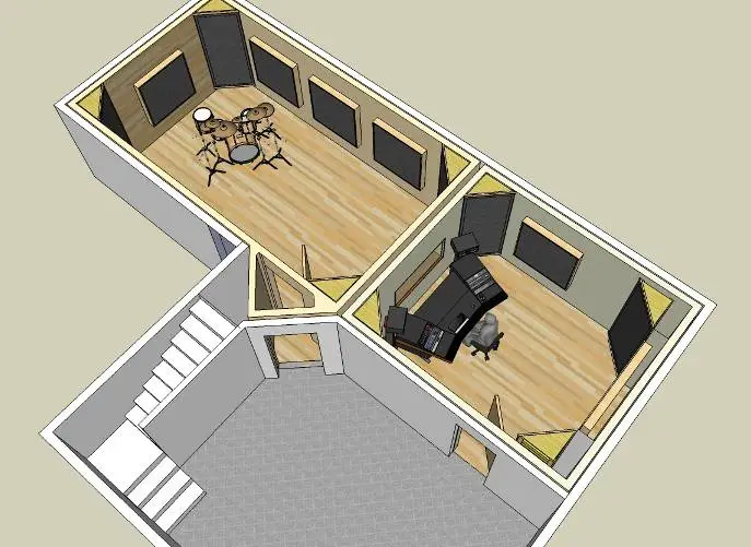

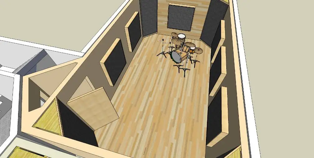

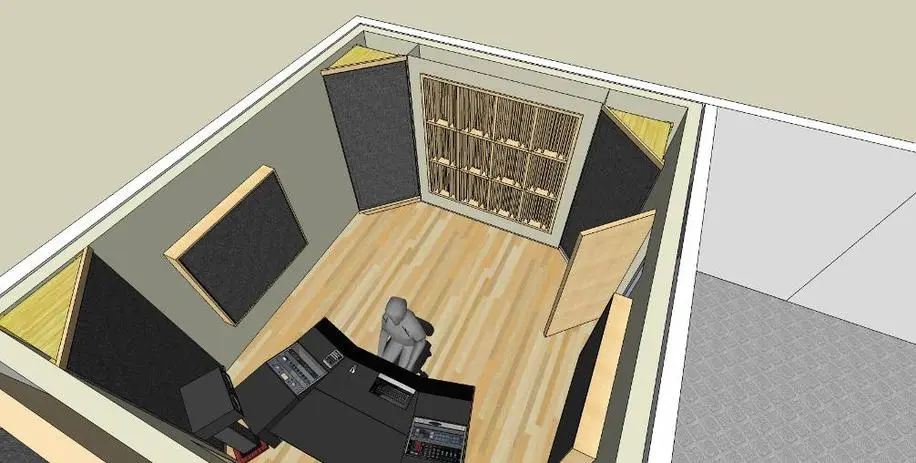

Fitz, phenomenal!!
And you did that on Sketchup... geez, maybe you need to give me a tutorial on that first, before looking into my studio space. All I can do with it is blocks and door frames...
The wife may have a problem with losing the storage space in the back... BUT, for the time being, the basement may remain with only the outer walls gyproc'ed, and floating floor. As a result of this, there won't be a lounge that she plans on using. This is a good thing, because it means I can use the "lounge" area as storage, temporarily. Which means I can set it up like you have it drawn up. I maybe have to set up a "temporary wall" between the live and control rooms. But once this set up is accepted as a fact, it means it's less likely that there'd be a lounge in the basement. Which means this becomes permanent. It's a tricky play, but I think I can manage it. So the door would have to be on a diagonal? I think there would have to be a door to the live room, only because were we to sell the house down the road, legally, the room needs access to the lounge area to be considered a room. And seeing how my province might be seceding from Canada within 3-4 years, we might move out sooner than later.
But this looks great. So I could line up the bathroom and storage on the lower right wall then?
Thanks again for everything!
Well, I already did it. I like to have fun with HomeStudio design:D
:D
And btw, yea, I can tutor you. I can send you the file too.
One other thing. These are simply "design" concepts. Once you confirm certain decisions, we can start "detailing"
the construction. Lot's and lot's of decisions to make though.
