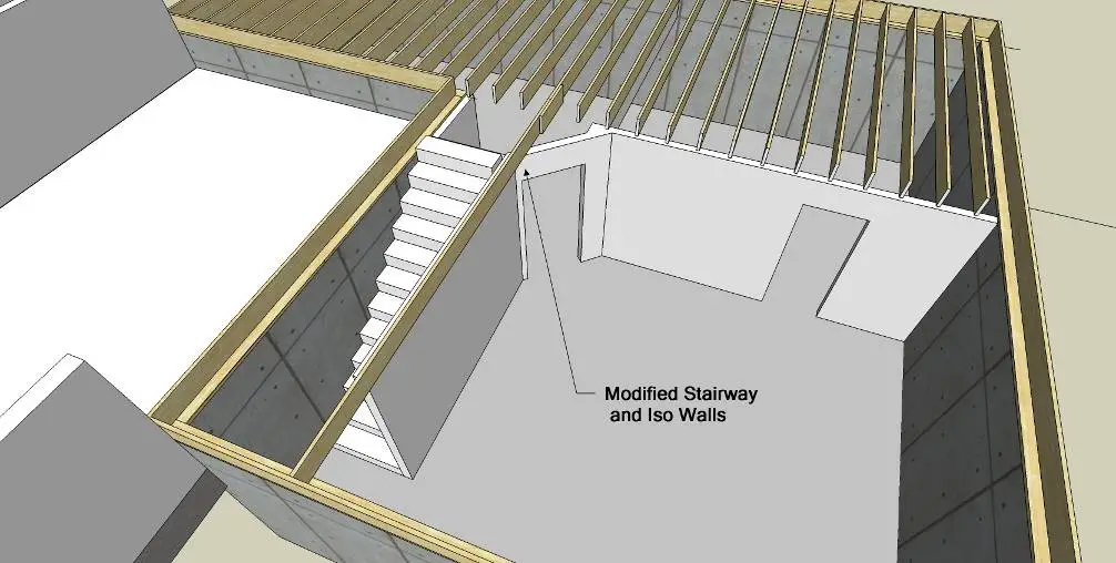

6. I would like to see the actual upstairs plan, as the stairway that is planned may or may not work according to other ideas, which untill I know your answers, I can't be sure of.
(note how my "idea" moves the stairs whereby you may have to have an "L" shaped Stairway with a landing at some point. This is what I am referring to. The reason was to allow a door under the stairway, without increasing Live room length while decreasing CR length, of which framing of this may or maynot be possible due to prior design limitations/upstairs elements. Also, I percieved the possibility of using the space under the stairs for HVAC/Plenum/ducting requirements)

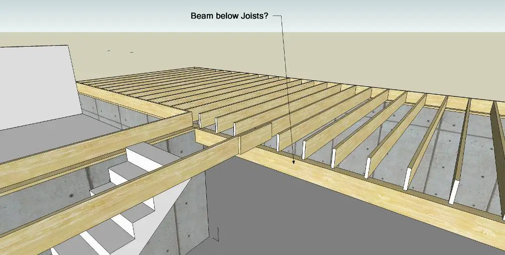

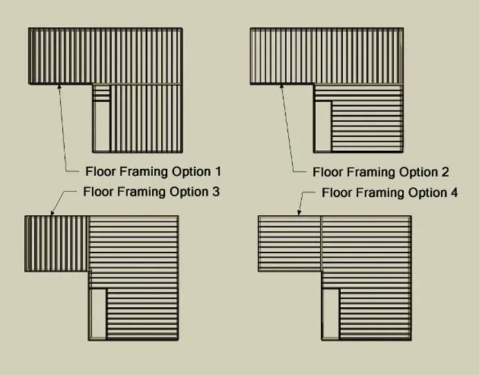

But this has to do with something else. The support of the first floor across the width of the "lounge" area. More on that later.
7. Is there any plan showing the first floor framing schedule(nominal lumber size)/layout? If so, can you post it? If so, can you include any details/sections? Are there any beams?
The floor framing/support/details/layout/ is all I care about. Again, more on that in the next reply.

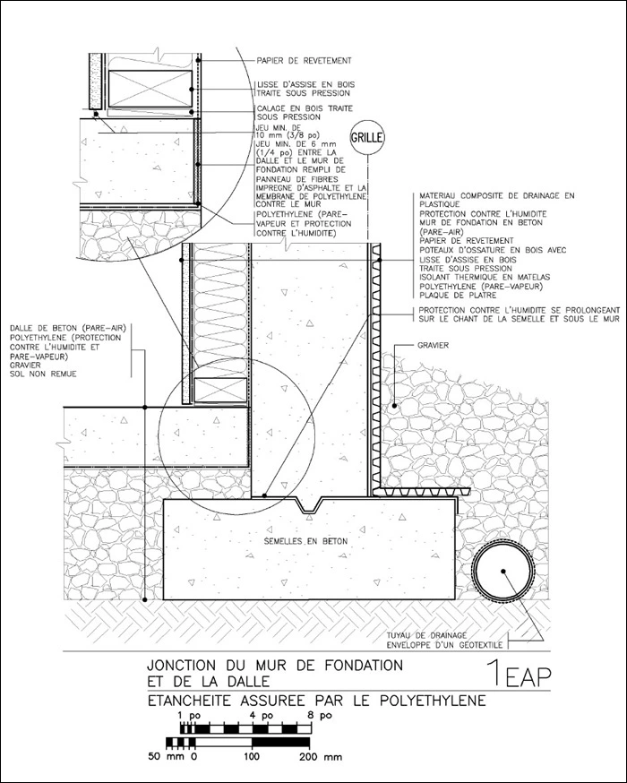

You see, I can't show you specific details if I don't know what is actually going to be done. In this case, IF, the concrete walls are below grade, I ASSUME the contractor will SEAL and INSULATE these walls on the OUTSIDE..which usually means a thick exterior foam insulation over a waterproof seal on the concrete. HOWEVER, you mention "sprayed"..is this on the INSIDE or OUTSIDE? Another quesiton is..IF these walls are below grade, that means they have to remove enough dirt to frame up the concrete forms...which means also...after the forms are removed, then they have to seal and insulate. And THEN backfill with dirt. Is this what's happening? Please, I need to know WHAT is being planned for the interior surface of the concrete walls IN THE STUDIO AREA.
Q-3. Has your designer/architect drawn any details/sections of the basement footing/foundations/slab/wall construction and connections? If so, can you post them?
Answer..
That's odd. How does the designer specifiy to the contractor and building inspection department, EXACTLY what/how things are to be built and or approved, if there's no details? Who is building this? Who specify's the nominal size of structural lumber...like the floor joists???3. The only drawing I have the one I posted a while back that you used to make your first drawing.
Answer
Ok, got the first floor plan and already worked a few things out from that. But..6. My wife is very understanding with the studio, moving the stairs can't be an option however. Sorry... we'll have to make do! haha.
.....moving it wasn't what I was thinking. Just modifying the framing. And now that I can see approximately(not in exact inches)where it starts and ends, take a look at what I was referring to.
7. I will try to attach the plans, kitchen will be different however (same size, but island and cabinets will be moved around...)
