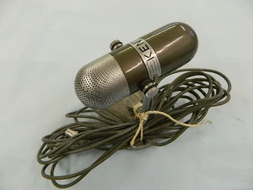

Hi Guys
i just bought an old microphone of ebay
untested. I'm not sure what kind of microphone it is and i was wondering if anyone has come across one like it before. If so please let me know as much as you can.
Thanks.
I didnt pay a huge price for it. It might not work.
I've never seen a connection like the one on it.
Not sure if it a crystal dynamic or a ribbon.
I just though it looked cool and even if it doesnt work i'd keep it as an ornament until I gutt it and put a ribbon motor in it and a transformer.
Thanks for any help you can give me

You just have to rewire the cord with an XLR and you'll have a working microphone!

Correct me if i'm wrong but i think it's an end address mic. Ive seen pics of it without the mesh top and the capsules flat to the body unlike an LDC.
When i asked what kind of connector it had on it the guy said it was like a tv ariel connector so i assume he means bnc? I dunno.
Shouldn't be hard to figure out wiring. Have you got it yet?
One wire will test continuous with the metal shell, and the other two are hot/cold signal, if it's balanced.

Those old Japanese RCA look-alikes are usually piezo/crystal mics, and have a high impedance output. I have seen some dynamics that look similar, but odds on for it being a crystal. Post some photos of the inside when you get it!
You will probably find that it has an unbalanced output cable, and you should try it with a 1/4 inch jack on the end.
If it is high impedance, it will not work well into a 'normal' mic preamp. Instead, connect it to an instrument input or even a DI box for best results.
I used a similar mic recently shoved into the back of a guitar amp cab, and got a really nice, big, tone!
Let us know how you get on.

I recieved the mic today. I have to say it's in really good shape for a mic that dates from the 60's.
After putting a new 1/4" jack plug on it, it works great.
Only trouble is its a 50k ohm high impedance mic. It will work quite well if plugged into a line input on the mixer and a guitar amp.
It also works well when coupled to the reel to reel recorder.
Has anyone got any idea how to make this high impedance mic better match my low impedance modern mic pre amp as i'd really like to try it out.

Well, you could use a transformer - I can make/sell you one if needed.
But don't bother.
Just run it into a DI box or instrument input on your preamp. There is no point sending it through a step down tranny, just to have it stepped up again in the preamp.
Edit: The line input is not ideal - a lot of preamps have a dedicated instrument in for guitars etc. Use that!

I tried it on the guitar/instrument in on my normal preamp and the signal was way too low and weak
then i remembered i have stashed away in a drawer a behringer mic 200 starved plate valve preamp i hooked it up tried several of the settings and it sounds great and i can now get a really good level to without cranking the amp so my wifes shouting at me to turn it down (and shes nearly deaf).
Thanks for that i might just keep it as it is it will come in handy when i need a high impedance mic.

Hey, the old boy is sounding pretty nice! Good to see that the B-ringer has found a good use. We get so obsessed with high end gear when a good or even a great sound can be had with an old crystal mic and a budget preamp.
Kip has hit on something interesting here. There seems to be no real standard for high-Z instrument inputs (or outputs), so it is always worth experimenting with what you have. Your mic wants to see a really high impedance and it seems that your behringer is giving it what it needs.
