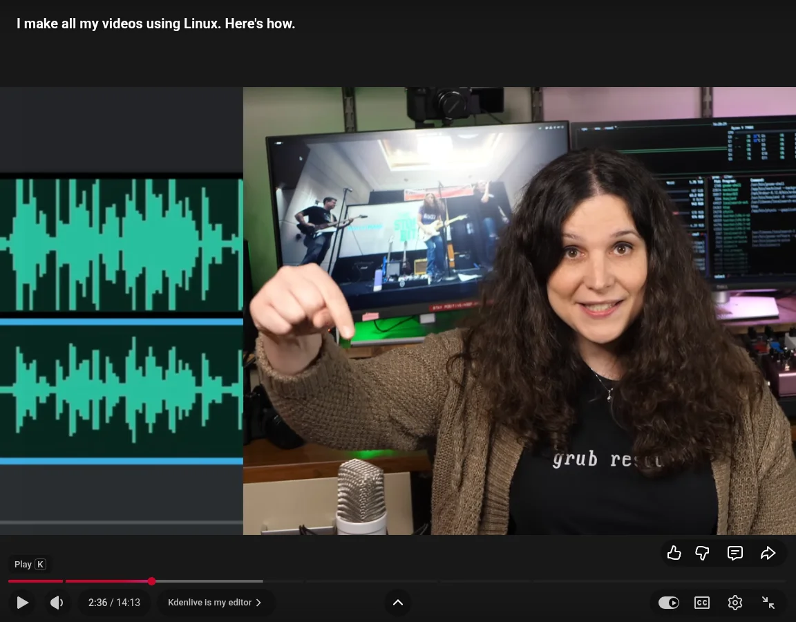

I'm seeking help identifying a microphone that I've seen in a YouTube video. It's a desk microphone, and its quality and capability are quite noticeable. However, the creator of the video, doesn't tell us which microphone she's using. I've asked in her comment's section. However, I haven't received a response. For this reason, I'm hoping that an audio community, with experience in audio equipment, may be able to help.
I've attached a still image from the video. In this image, you'll see that she's pointing at the microphone, on her desk.
Can anyone identify this microphone? I love the quality, and am seriously considering using one, in order to make videos.
If you want to watch the whole video, here's a link:
If you're able to identify this microphone, then I'd love to hear from you. Her audio is fantastic, and she doesn't even have to be that close to the microphone. I'd love to know what she's using.
Thanks for your time and attention. Any insight is greatly appreciated.
My guess.
Blue Yeti (or possibly Blue Yeti Nano)

This is the aspect that got my attention, most, when I watched her video. It's just setting on her desk, a few feet away. Yet, she has great audio. When I look at a lot of the people using the NT1, in other videos, their mouth is only a few inches away. Perhaps this is just the way that most professionals record.

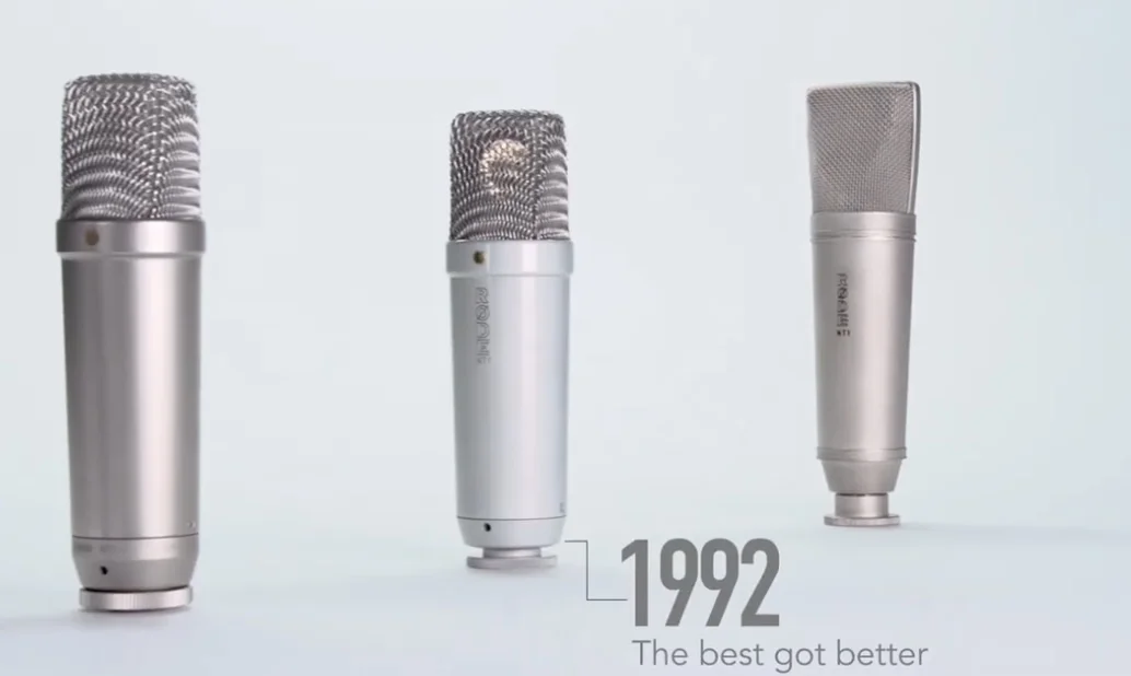

Her microphone does look like the Rode NT1; as many of you are pointing out. However, after a few quick searches, I don't see anyone using it at a distance of a few feet. Is it that the microphone is capable, but they're just not doing it?

ah - you're getting confused about the image vs the sound. I have recorded choirs with NT1s from a distance of 4 or more metres away - and the output level, and internal noise mean distance is no issue at all. It is not a low output mic like the Shure SM7B. However, they are actually more troublesome close in. Not in any 'faulty' way. They are a fairly normal studio large diaphragm microphone, and if you go in close they pop and blast from your nose and mouth air flow. The cure, like ALL studio mics is pop shields. Either the mesh type, but that looks a bit silly in videos, so you can use the larger foam windshields if you must go in close.
If you go in close, the sound warms up and gets bassier - because it's a cardioid mic, and cardioids, apart from specially designed ones, increase bass and warmth as soon as you get more than 6" or so away, and as you get closer from that point, the change in tone is very obvious.
Most podcast/video mics are designed for close in use and the frequency response is adjusted to make them more neutral. This mic is well known for having clean, clear sound with clarity, but of course it then also needs protection. Getting close to an NT1 naked is risky, but the same applies to all the great mics - U87 Neumans, and the TLM103s, plus AKG 414s and tons of others.
