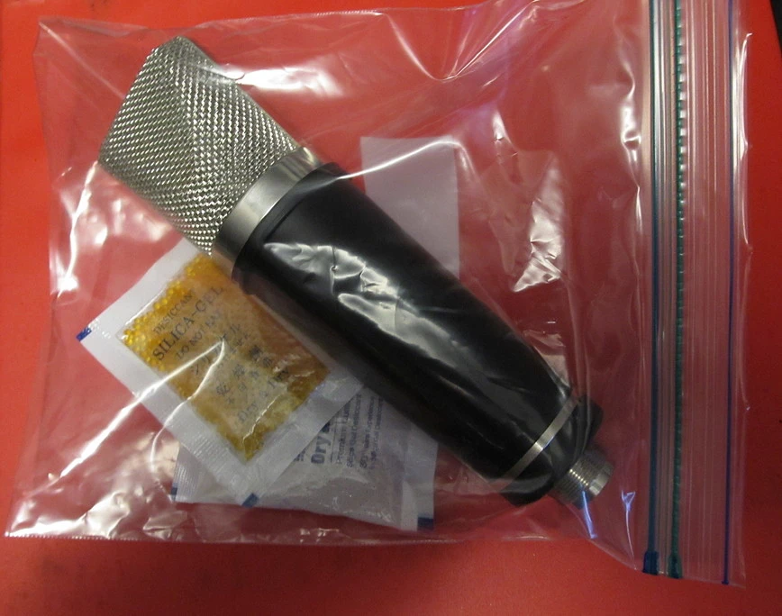

If you think it's moisture..... Desiccant packs with the mic in a ziplock bag for a couple days and stop flooding the forum with the same question.
