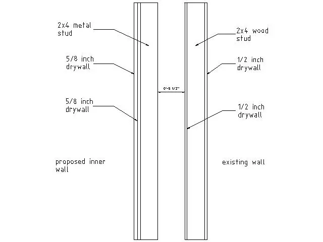

This thread has a lot of info in it! The attached pic shows my proposed "room in a room" wall construction. Not shown is the insulation between both stud types. Also the walls are 8 feet high. This thread also has the most mention of metal studs I've seen so far. The Certainteed bag showed the test data for their insulation and they used 24 in centers with metal studs. Pretty high STC ratings, but no frequency ranges were given. No mention was made here of the Auralex "Sheetblock" product. Have any of you tried it? Is any good?
SG,
Can you remove the inner layer of sheetrock on the existing wall?
That will gain you some reduction. If you remove it carefully and then reinstalled it inside the bays - you may get between 6 to 10db greater reduction then they way you have it detailed now - without spending a penny more.
Another comment is that you can gain more room space - you do not need a 5 1/2" air space between the walls.
What guage metal studs are you using - and how are you handling the ceiling?
Rod
Thanks Rod. I can remove the inner layer of sheetrock (it's a messy job but someone has to di it). I am not sure what you mean by "reinstalled it inside the bays". Also, what would you recommend as a good distance between the walls? I am not sure what guage of metal stud I will be using as I am still in the design/investigational phase.
If - instead of just busting up the sheetrock to remove it - you were to cut it out flush with the inside of the studs (a sawz-all would work great for that) then you could take the pieces and place them inside the wall tight against the drywall on the other side -
Some of Industrial's adhesive is a good idea in this case - with a simple wood stop. Caulk the edges after this and install a wood strip around the edge to hold them in place.
A 1" air space would be adequate - 2" optimum. You really don't need any more than that.
Rod

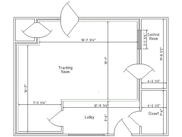

OK. This is the room I have to work with. The inner walls are steel studs as per the recommendations on this thread as well as manuf. data. The doors will all be solid core. There is a 2 inch gap between the walls except in the "Lobby". Insulation will be applied as needed in the new wall as well as the common wall with the Control Room which was not insulated from the begining. Basically I am asking if this room has a chance of becoming a recording studio. Thanks to all who have responded in the past.

Hi knightfly thanks for your input. I cannot touch the comon wall between the control room and the tracking room. It is a supporting wall between the room and the garage. I thought I could put the near-field speakers on the short wall. I was familiar with the thread you suggested.
"It is a supporting wall between the room and the garage" - I'm not seeing a garage, is it beside, above, or below ?
If your budget is too tight to re-engineer things to allow that wall to move (it's usually not a matter of possibility, only budget and time) then you could put nearfields on the short wall - you would need to use at least 2 inches of rockwool or equivalent on all 4 surfaces (ceiling, side walls, wall behind speakers) just to get a usable sound field (or almost) - It would probably help tonal balance and imaging to space the absorbent off the short wall by several inches.

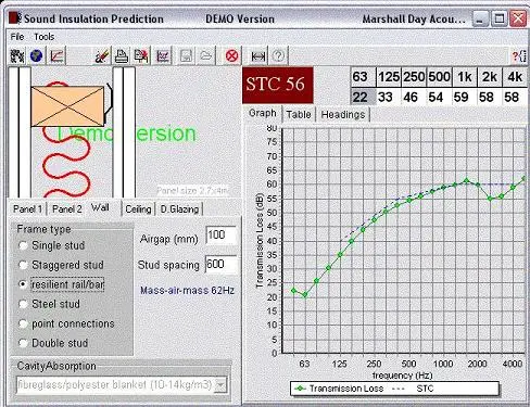

Your comment about no frequency ranges is what prompted me to link that thread - STC values are typically only equal to TL at 500 hZ, everywhere else is a function of the construction. The arcane formula used for STC (I guess there actually IS one) is misleading for anything but voice isolation.
Here is a screen shot of Marshall-Day's freebie wall calculator (which I intend to buy the full version of, if they ever answer my emails), showing a wall with one layer of 1/2 and one of 5/8 sheet rock on each side of a 2x4 wall, using Resilient Channel on one side UNDER the sheet rock. Just for reference. Note the much lower dB values at lower freq's, and the small "dip" at around 3 kHz - if both sheets of drywall used were the same thickness, that 3 kHz "dip" would be more "pointy" at its bottom, due to identical coincidence dip caused by same thickness panels. .. Steve
