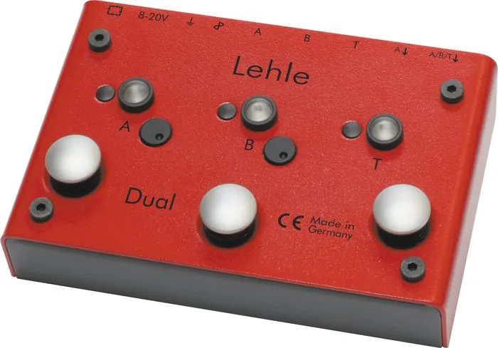

I second the A/B box.... I've used one to take my bass through my amp and DI into my multitracker. Works good. Just make sure that you get one that has the 3-way switch (A/B/A+B). I had one that didn't, which makes it worthless for what you are trying to do.
Thanks..that is just what i needed....a lil bit pricey (for something thats just gonna record any live ideas that spring up)...but morley made a $50 dollar one that seems it will do the same!
http://www.musiciansfriend.com/product/Morley-ABY-Channel-Switcher?sku=150757
Thanks again for everyones help..the re-amping idea will be the next thing into doing when the songs are finished and the tracking process has started!
