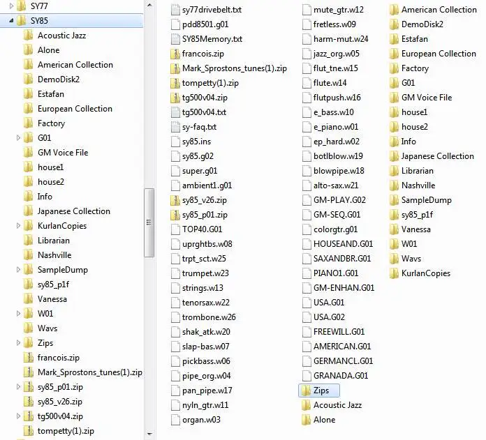

notsram, how's your collection of patches for the SY85. I have some I've collected from ages ago and could post them up somewhere if interested. The folder I've screenshot needs some cleanup and sorting.
I ought to get mine out of the closet and tinker with it :)

Thanks for this. I'd definitley be interested! I have a load of old floppy disks with various patches/soundsets on, but haven't tried them yet. Of course, i don't have a floppy drive in my PC these days, but they're cheap enough to buy

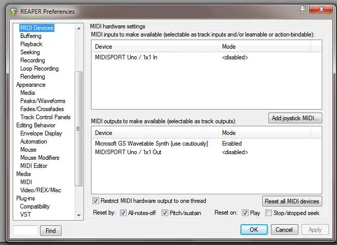

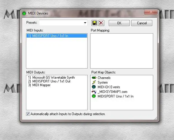

I've downloaded a program called Midi-Ox to test the connection between the PC and my synth, but it's not finding any midi inputs. THe USB to midi cable installs correctly, so as far as I know, that's fine. Been fiddling with the midi settings on my Sy85 for the past hour, but no luck. I'm starting to wonder if time has taken its toll and the midi ports are damaged...
If you haven't as of yet, you may need to install drivers for the MIDI cable (if it has them available). I just installed an old M-Audio UNO MIDI cable with drivers (MIDISPORT UNO). Shown below is MIDI-OX and Reaper (Win7 Pro 64bit). It didn't seem to want to install with Windows alone hunting for the drivers. Make sure the IN and OUT of the cable is connected to the appropriate jack on the synth :).
