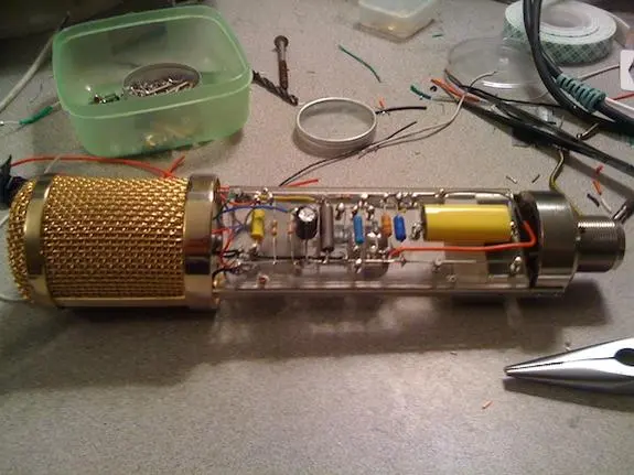

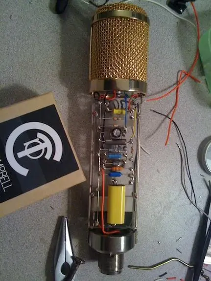

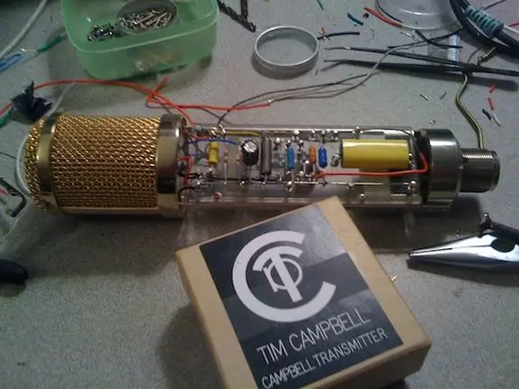

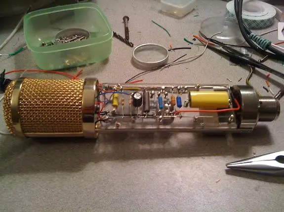

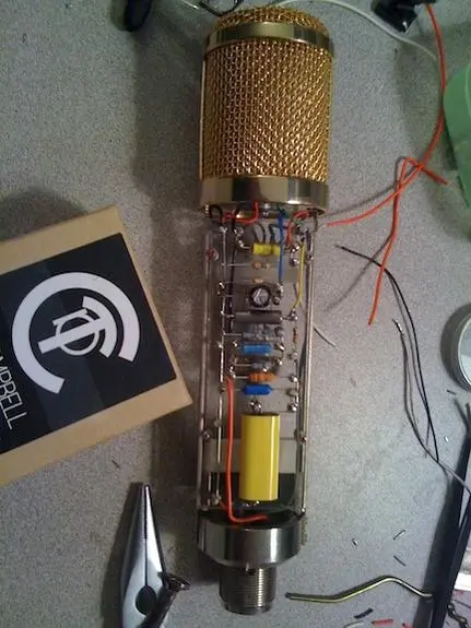

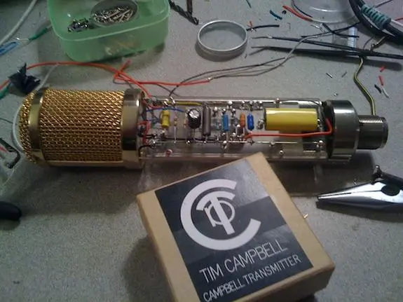

Yeah, that's definitely the Aurycle kit mic. I bought two or three of them. They are the same mic that was sold as the sE5000 (IIRC) and another famed mic (with a different capsule).
I tried modifying the board, but ended up just copying the Ela M 251 circuit (adjusting for remote pattern control) with a Tim Cambell capsule and a Lundahl transformer. I also found a better grill off another mic that matches the Ela M's grill mesh count.
Here's how mine looks inside:
View attachment 64360View attachment 64361View attachment 64362
Philgood.....that is some damn fine work.....that ground rail makes perfect sense. Is that a .001 IC film cap for the capsule coupling capacitor ?? I am using one for a capsule coupling cap on an ADK TC mic I gutted and rebuilt with a new capsule, Parallel triodes (5-star 12ay7) Takman REX plate resistor, 1n4148 X 2 on the cathode, and a few other tweaks. Makes for a really good sounding mic. I'd love to hear the mic you posted in those pics !!!
David Blackmon
Polycarbonate 250v. I thought I'd try that instead of a usual polystyrene.
Did you mean grid resistor?
No I was referring to the capsule coupling cap. I meant to say I am using a Mallory 150 600v .001 for the capsule coupling capacitor in the ADK TC mic I modded. I was out of polystyrene so I had the Mallory cap sitting around and the size was right so I gave it a try. It sounds better than the Wima film cap that ADK had in the mic. I might try a polystyrene in it when I get some more in. The mic sounds great the way I have it now though. I put an Advanced Audio K67 capsule in this mic. That is the same capsule that is in the Stellar CM-6 that has been getting really good reviews lately.
No, what you referred to was a "Takman REX plate resistor", and I was confused as to whether you meant the B+ feed resistor going to the plate or the grid resistor. I usually use a 2W 100k at the B+ feed to keep the noise low, but look for a high quality low noise thick film or carbon oxide(?) resistor for the grid, since that's the one being amplified.
I hate it when people say "Wima caps" like its all one thing. Wima makes polyester, polypropylene and polycarbonate capacitors. Most of them stacked. So, what KIND of Wima caps? I don't know what type ADK used in that, but most likely they were mylar .022uF. A bit of engineering overkill for the value. just cause it says Wima doesn't mean its the best. IMB makes really good capacitors. So do Auricap, AEON and Sprague.
