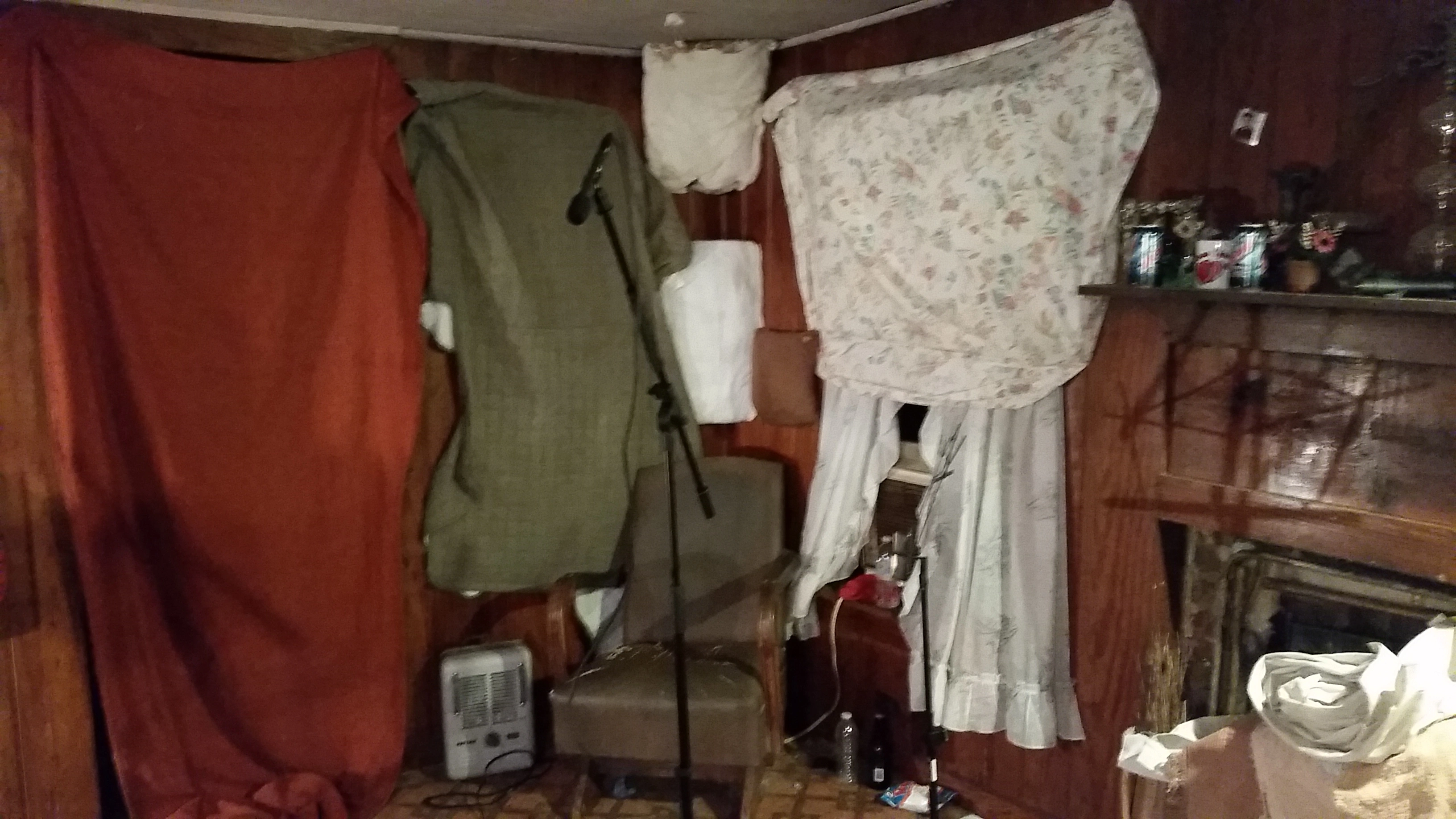

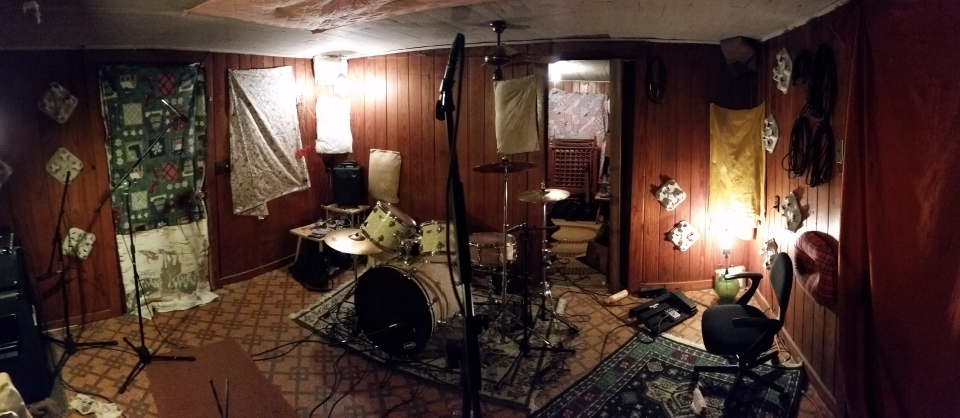

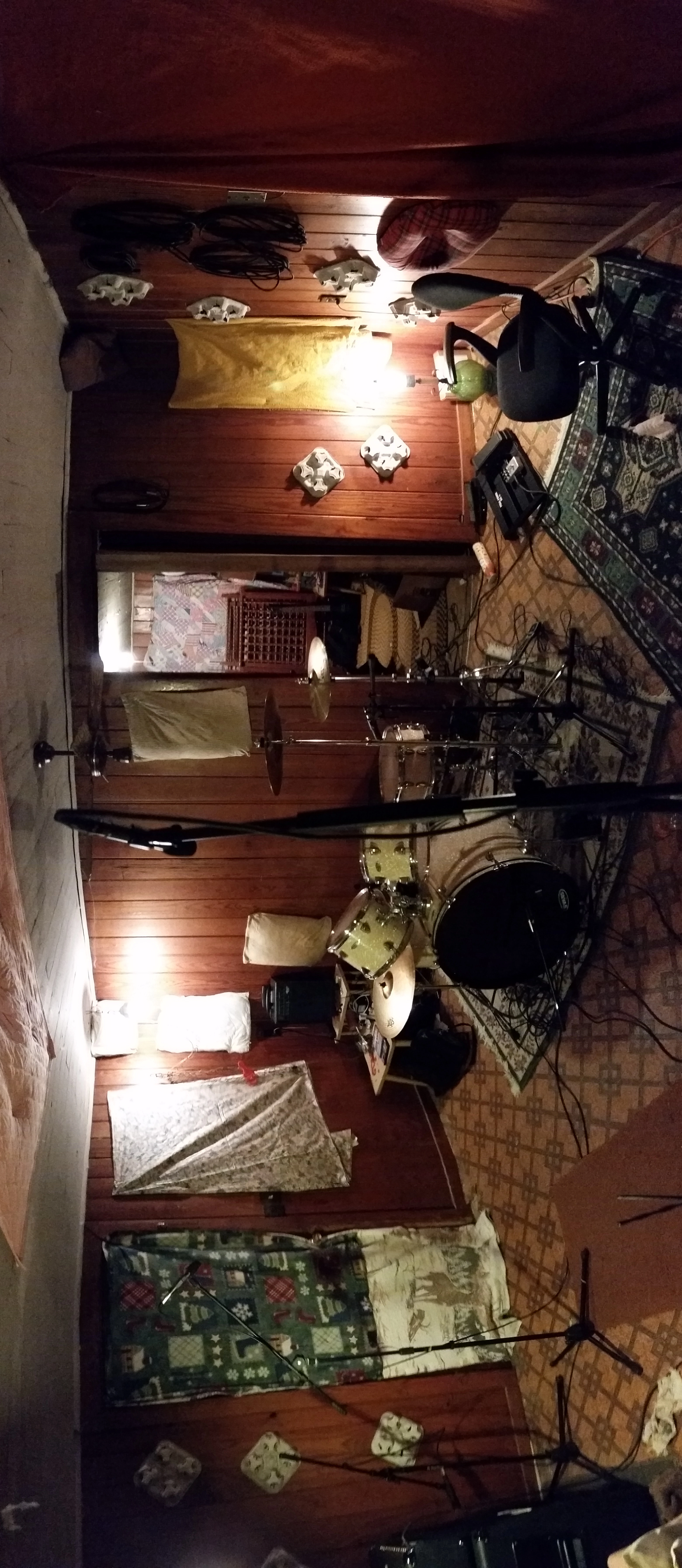

All, I put up a bunch of stuff in my performance room yesterday. It's really, really budget, but it worked, I think. The room doesn't give me a headache sitting in it like it was.
The photo of the chair in the corner is what I couldn't catch in the panorama.

Oh COA23 I was not replying to you about triggers, (our posts crossed) I was referring to the triggering crowd LOL. By the way get some Bass trapping in that room and it will probably sound OK.

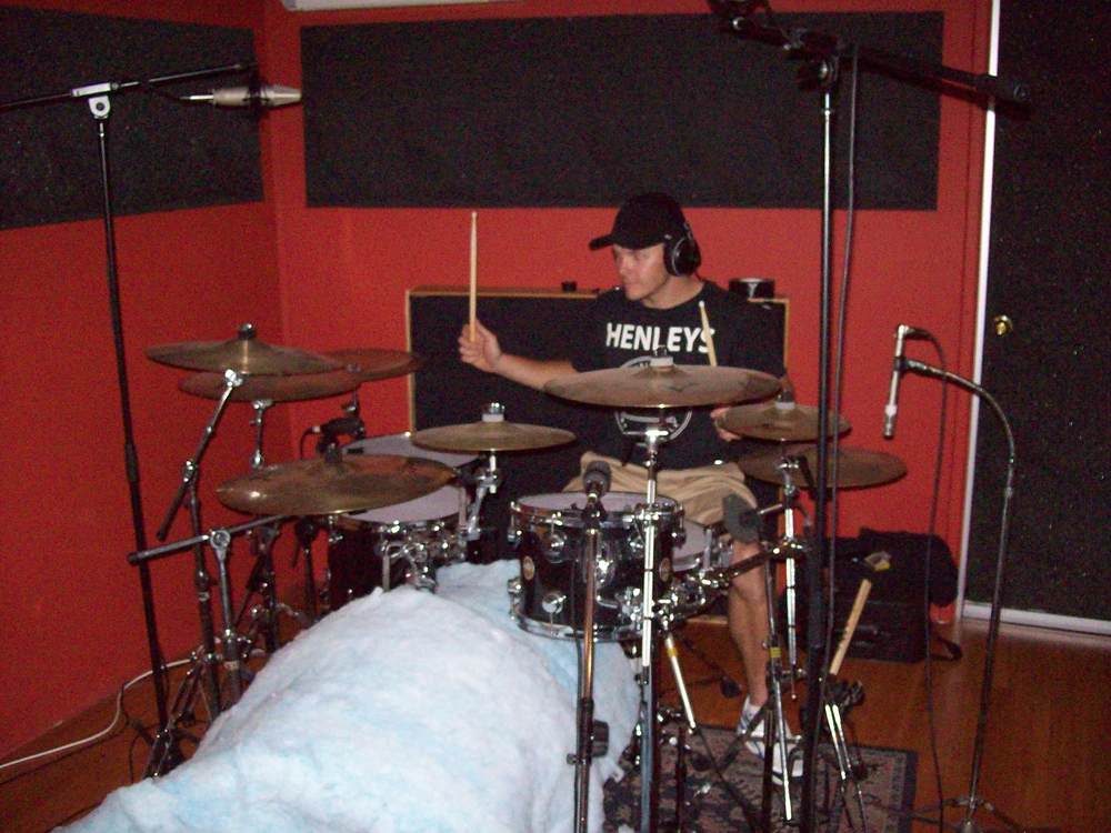

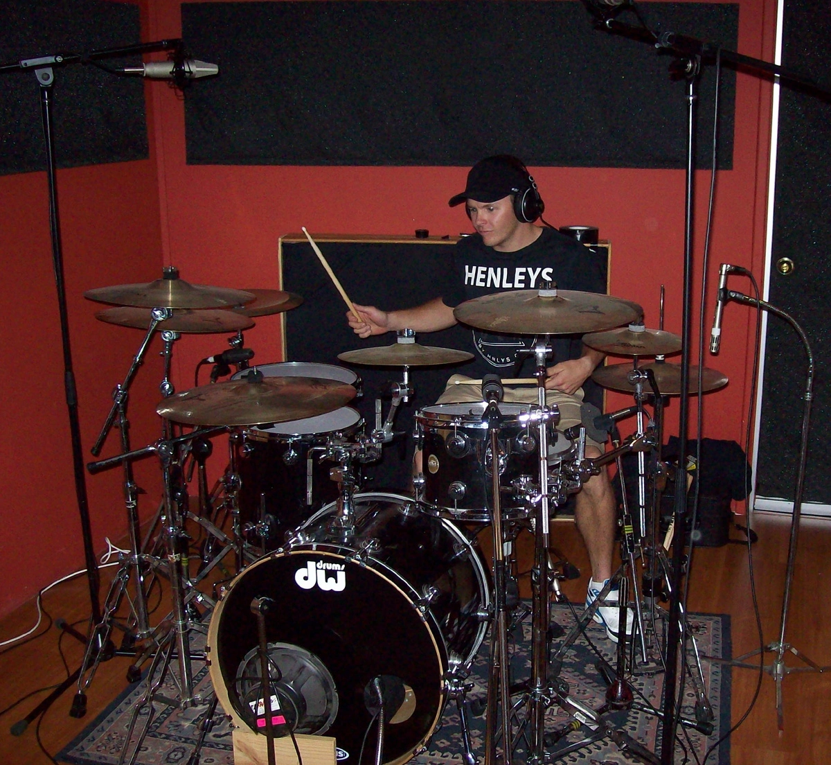

I suppose I should post a photo of my typical drum micing setup for information, real drums no triggers, this is from Saturdays session:
Alan.
Actually this photo was taken for a press photo so I had taken the kick blanket off.

That thing on the snare mic, is that to help keep the hats from bleeding onto the snare mic?
Yes, it is just a piece of foam with a hole to slip over the mic. There was not much of a problem with hat spill during this session so it was not really need, if there was a lot of spill it would have been moved closer to the head of the mic, but it probably helped even where it was in the picture.
Alan.
