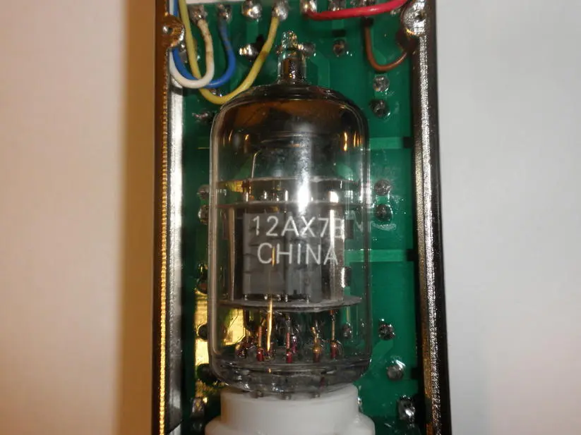

The valve says 12AX7B China.
I'm burning it in right now and it sounds quite harsh but it's really, really hot.

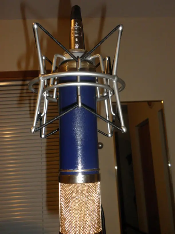

Fortunately, I have a Samson SP01 spider mount kicking around and it fits. When tightened, the mic can still spin around but is held firmly by the threads.
The cardioid emblem below the grill tells you where the front is.

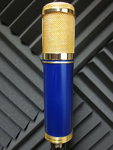

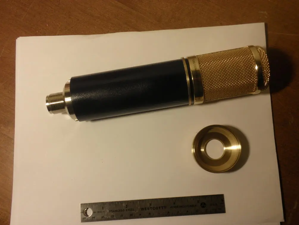

The paint job looks good.
It's all solid brass, I think and the ring on the body can move depending on which way you assemble it.
The base screws off.

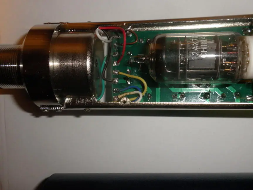

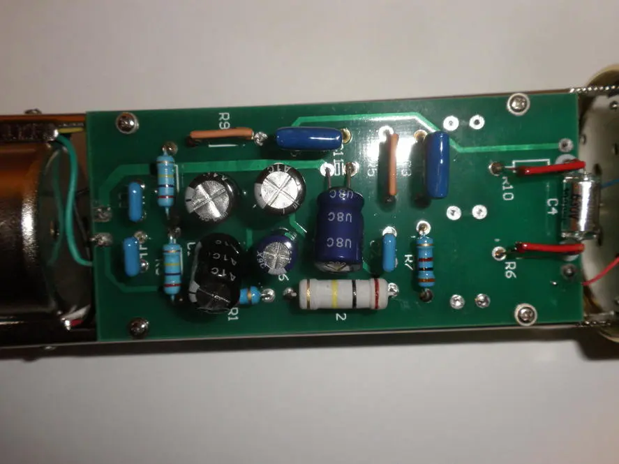

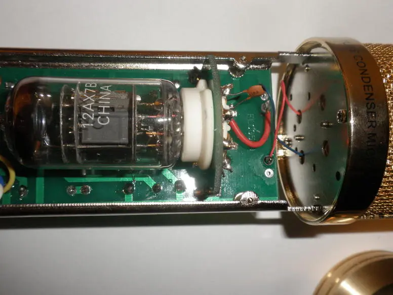

Don't know how many pictures I can upload here but here goes.

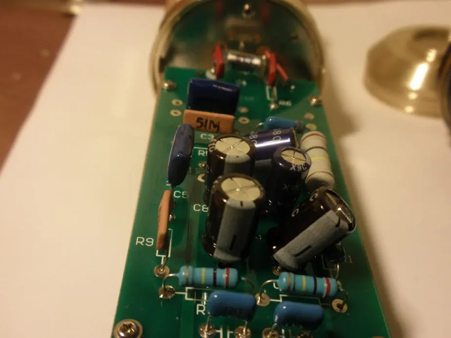

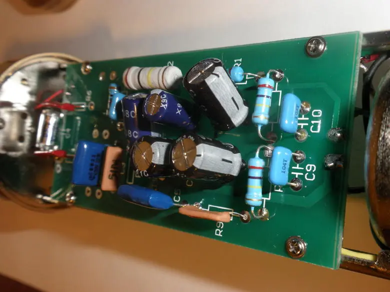

Now Open the power supply and get a few shots of in that box.
No!......................................................
Here you go.

Yeah, that's the Aurycle I think...first thing, get rid of that tube!...crap!...find a nice 6072 or at least a decent 6201 (12AT7WA) and swap it out...should tame some of the harshness...I don't understand why you buy the Behringer tube mic and this mic, when I post a link to a really great tube mic that costs less than the two of them together...guess, you just gotta learn...

Yeah, that's exactly what I was about to say. I don't know that the Chinese 12AX7 tubes are necessarily bad tubes, but the 12AX7 tends to be too high gain for the circuits in most of the Chinese tube mics, IIRC. GE 5-star 6072 parts are generally good choices, but honestly, I think you'll find that anything with lower gain than a 12AX7 improves the sound considerably. There are an awful lot of cheap tubes in the $10 ballpark that would be a sizable step up....

I'm not in to swapping tubes just because you can but I've said, right from the start, this one's really, really hot.
12AX7's gain is too hot for mics and pushes into distortion too quickly, which is why 12AY7 or 12AV7 is better.

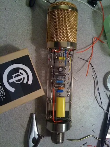

Yeah, that's definitely the Aurycle kit mic. I bought two or three of them. They are the same mic that was sold as the sE5000 (IIRC) and another famed mic (with a different capsule).

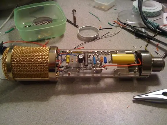

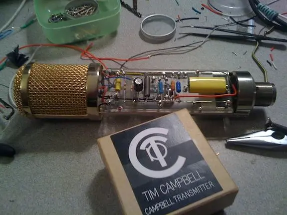

I tried modifying the board, but ended up just copying the Ela M 251 circuit (adjusting for remote pattern control) with a Tim Campbell capsule and a Lundahl transformer. I also found a better grill off another mic that matches the Ela M's grill mesh count.
Here's how mine looks inside:
Phil ..... did you ever put a stock one together and try it so as to be able to <in your mind> A/A the unmod and moded?
Yes I did. What I ended up with in the stock mic sounded very much like an off-the-shelf Apex 460. Its no wonder either. The circuits and components are almost identical in every way with the exception of pattern control and no cathode follower. Other than that, every components is the same type and value. It is exactly the same capsule and transformer used in the 460. The grill might be a few mm wider and taller, so that has an effect on sound as well, but over-all the mic was harsh and brittle. A few adjustments can make it switch over to be very good though.
Change the C11 capacitor to a high quality film up to 1uF. Swap the transformer to something good in the 10:1 range. Jensen makes on that is very transparent. Peluso's BV11P is made by Tamura, but is very warm sounding. Remove the RF caps by the transformer primaries. Change the 1uF filter caps to mylar (and you really only need the one between R1 and R2) and maybe reduce the 1G ohm resistors to 500M Ohm. You could also run both halves of the tubes in parallel and use a smaller turns ratio transformer, or wire it for something like an EF86 (which sounds really good in combo with a C12 style circuit.)
Then there's the capsule. K47 or a Peluso style CEK12 (I HIGHLY recommend a Tim Campbell CT-12 capsule). If you want to tame the highs while using a CEK12 or CT12, jumper a 100pF-330pF 600v shunt capacitor from before the output cap and tube anode to ground.
