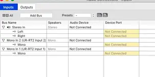

I tried the set up in Studio One and it was ok so its not the hardware...When I look at audio in and out it shows no ins..
but Studio One was ok...so that means its a Cubase thing... tried resetting, midi works, its just Audio in Cubase...
what could it be,..??

I got it going and maybe someone in the future should know what I did.... In the input/output routing strip up top you have drop down choices like stereo,L,R,Mono R etc.... but sometimes Cubase might not load ALL the choices it should.
Its a glitch in DAWs in general. In this case I had to delete the track and reload another and then at the bottom
there was 2 more choices, mono L( RT2) and mono R(RT2). You have to select the mono that shows your interface in parantheses.The other mono choices might NOT work.
