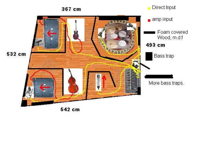

This is what I would do if I were you, should sound ok. Won't cost too much
