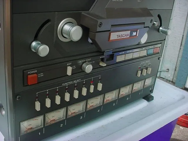

The Tascam 38
A simple, no frills, VU-meter style unit. See:

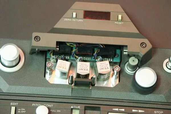

The Tascam 38 is a 3-head design.

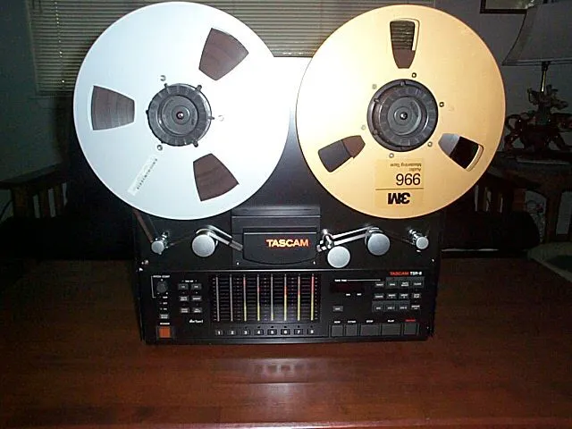

Here's the TSR-8
It's a much newer design than the 38.
The TSR-8 has LED-meters, auto-locate/auto-punch, and plug compatible synchronicity with Tascam/"Accessory 1 & 2" synchronizers. That, plus built-in dbx, makes the TSR-8 quite an advancement in technology over the 38. See:

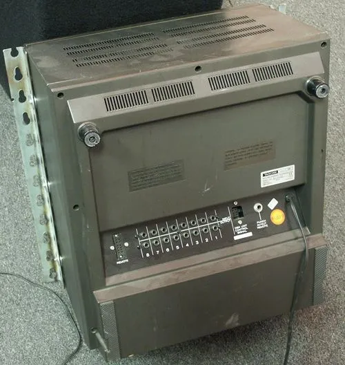

Here's the back panel of the TSR-8

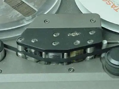

The TSR-8's a 2-head design.

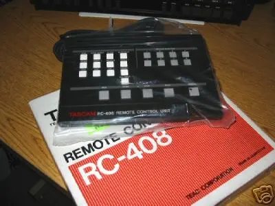

The TSR-8's remote is called the RC-408
Sometimes included with the sale of TSR-8, bundled, but not always. Here's one auctioning on it's own.

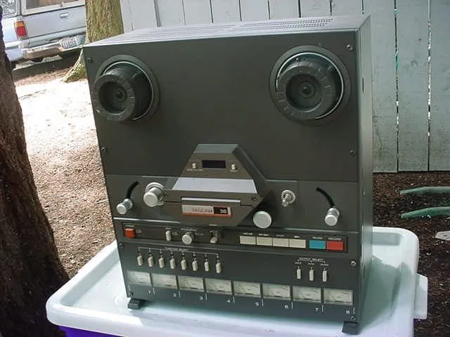

Here, I'll throw in this glam pic of the 38.;)

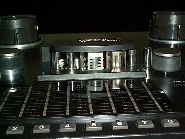

BTW, the 388 is a 2-head design, 1/4".

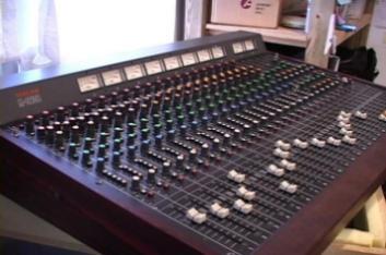

Get the 38 or TSR-8, and you'll be in need of a mixer,...
probably starting with the M30,...[see previous pic], maybe up through this, the M320B.

three head vs two head: advantages, disadvantages?
What does Tascam 1&2 synchronizers get you. What standard equipment can you sink to? Sync to each other?
This is the coolest thread ever!:D
Three tape heads allows off-tape "confidence" monitoring of the signal, real time,...
more or less. This is of some utility in the studio during normal production. The 3-head deck, with it's off-tape monitoring capability, also makes the process of calibration much easier.
The 2-head deck does not have any real-time off-tape monitoring. To monitor the actual recorded signal, would require you stop, rewind, and listen back to that segment of tape. Likewise, because of the relative limitation of a 2-head deck versus a 3-, the 2-head deck is much more laborious to calibrate, with uncounted REC-REW-PLAY-REW, repetitious operations to get all tracks calibrated.
