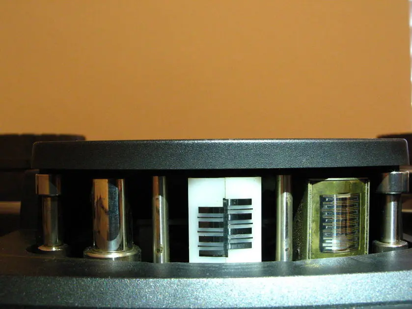

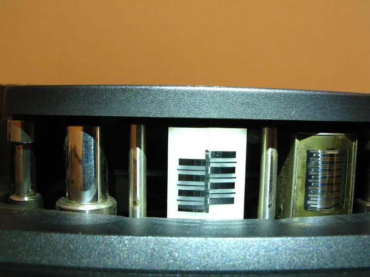

Using ATR tape, correct? Not my first choice but lets move on for now... Can you post a clear, up-close photo of the heads, tape lifters and guides? We're looking for deep wear grooves, which may be shredding the tape.

heads close up
just cleaned them heads then tried to record again but getting the same result.
took some pix but file size is too big. will post later.

Looking at the pics you may need to clean up a bit more, don't forget the guides also need cleaning and the heads still have some oxide on them.

Can you see the heads where the 2 groovers are on either side?
Is that a bad thing?

Hi Steve,
Good to speak with you today. After taking a good look at the photos it appears this TSR 8 is not quite ready to provide good edge track performance. Specifically here are the issues I can see from the photos:
Track 8 of the record-play head appears to have a radius worn to the air slot and this will make that track unstable. The tape heads are not freshly lapped as we first discussed. This service will help restore stability too.
A new timer-tachometer roller is needed on the supply side of the machine. This rubber has worn out and is chipping off. This in itself is destructive to the tape. It is also the reason I think the tape is steering up and down in the tape path causing the edge tracks to slowly modulate the treble.
The capstan shaft is caked and must be thoroughly cleaned to prevent further tape damage. Also clean the rubber pinch roller.
The tape lifter arms should be turned to a new position on a polished side. The tape is riding on a worn flat spot and this too contributes to tape wear.
The same flat spots are noted on the larger diameter tape guides and I can see the oxide built up from the photos.
There will always be some small degree of small slivers and or oxide powder that appears the first few wind troughs.
of new tape.

OK, first off, I mostly agree with Mike Spitz, with the exception relating to the condition of the heads, lifters, guides etc.... They're fine but require a thorough cleaning and it seems the capstan shaft, pinch roller and counter roller need cleaning and possibly replacement / re-rubbering (the rollers I mean). You absolutely need to clean the entire transport where the tape touches. It needs to be free of any oxide / residue. Another thing I disagree is with regard to that tape. It is (ATR) the wrong tape for the TSR-8 and most other TEAC / TASCAM recorders out-there. It's a waste of money because the recorders are not capable of using this tape formulation correctly, bias and level wise, not to mention the physical burden that this tape places on the capstan motor and heads, lifters, guides.. Whats-more is that your tech really did a terrible job at servicing this machine. That's why I always say, either take it to the people who built it, learn to service it yourself or don't bother with analogue. I would never take it to some off the shelf service guy.
Desmond, it took me about 2 hours to do a good cleaning on my TSR8 this previous Saturday morning. I actually just sat it on the kitchen table and started with the outermost portions of the tape path, the tension arms/rollers. I worked my way in and pulled the head cover off and proceeded to get a better angle of things (it's only two small allen bolts holding the "Tascam" cover on). I also turned the guides around a bit to get the flat spots away from the tape.
It sounds intimidating, but as long as you take your time and pay attention to what you are doing, it won't be any problem.;)
