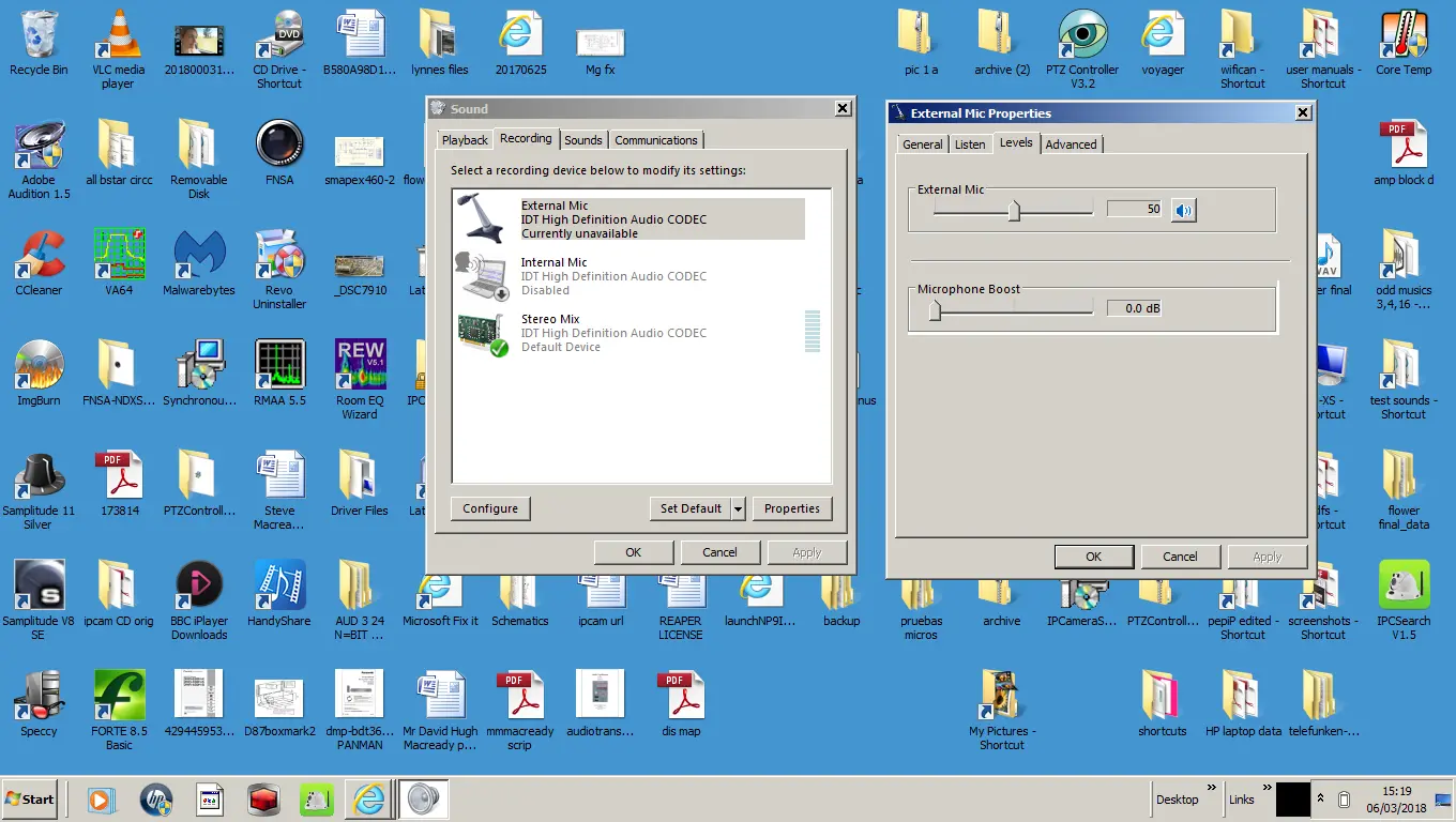

Right Sis! I am pretty sure it is as I suspected, you have much too high a record level set in W7.
Start with the two wee arrows bottom right left of date/time. Open it and R click on the speaker icon. You will get something similar to the attachment but setups can vary and you might be in for some creative clicking!
Whatever, I am sure you will find the record level is slammed to 100% (mine is at 50%). You need to pull this back to probably 5%, maybe less.
Do you run the laptop headphone output back to the mixer? If so the level might also need some tweaking. VERY roughly, when waffle into a mic blips the "0" LED on the mixer* the DAW software should hit about -12dBFS. This is for a 16bit system which is, I am sure you have, if it were 24 bits (see later) you would shoot for -18dBFS and peaks no higher than -8dB or so. Once you have these levels sorted going IN you can adjust playback to taste.

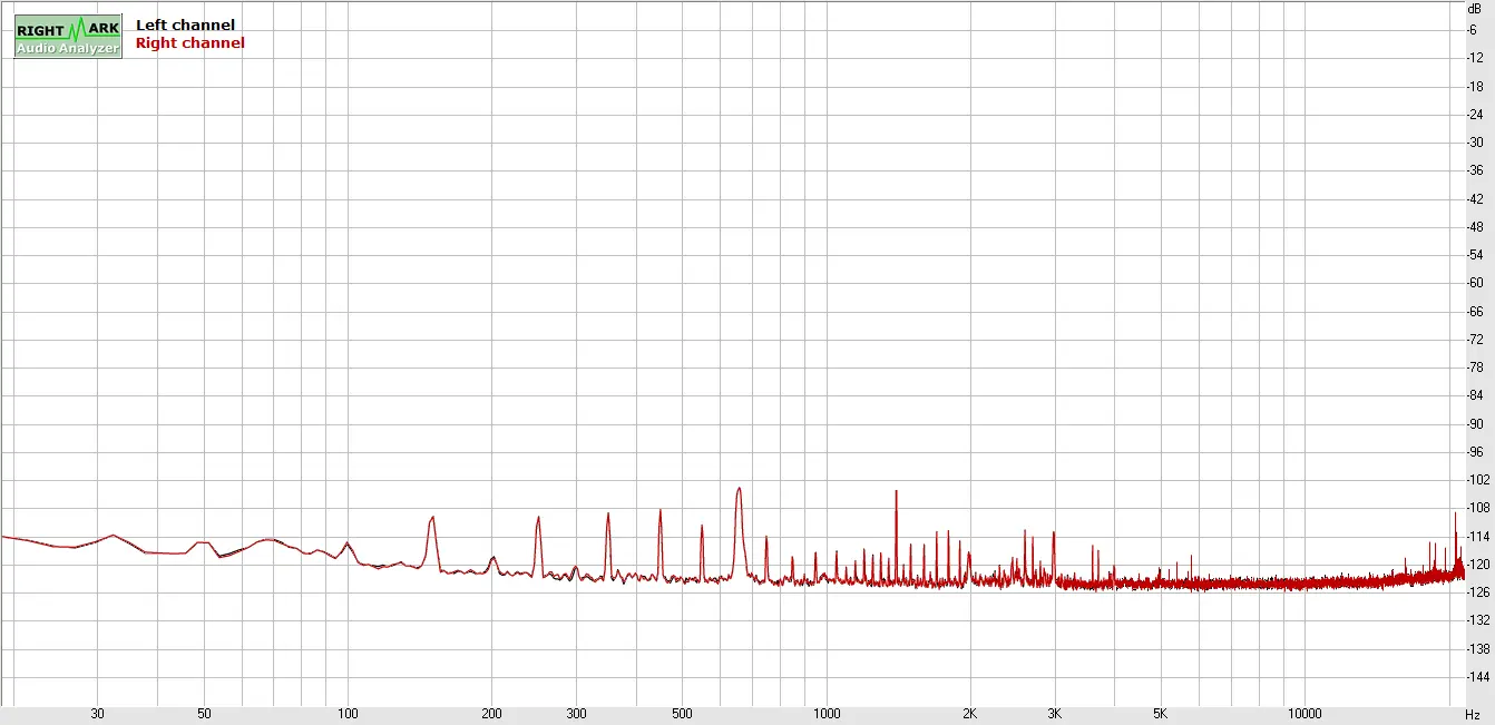

Attached are two spectra. The "A&H" is a pretty good USB mixer but is a bog S, 'generic' 16bit USB audio system. You can see the mess!. In practice those spikes (once Win gains are properly set!) are well below ambient noise for the mixer's intended purpose, recording live bands but if you crank the replay gain on a low level recording the noises WILL intrude. N.B. That mixer, just adequate tho' it is is WAY better than most 16 bit cheap recorders.

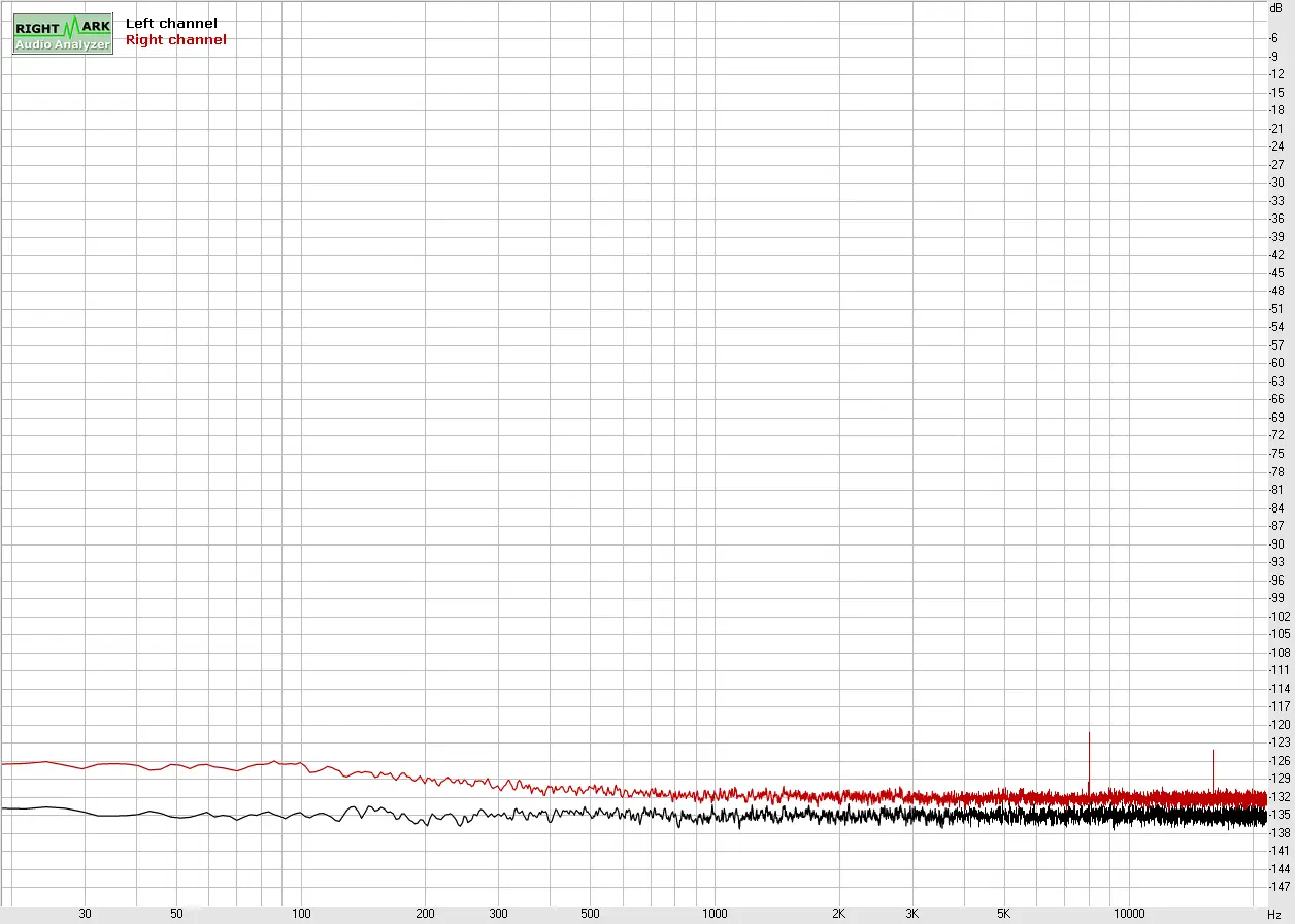

Compare the 24bit* recording of the baseline noise of my NI KA6 interface. Not only is the average level some 12dB lower but there is an almost complete absence of spikes (even the one you can see is probably due to my hurried setup)
So, you desperately need an external Audio Interface to get you clean recordings. Be aware, noise might still be a problem but it will likely be just noise EXTERNAL to the system. You should at least be free of 'whistles'!
*In practice the spectra are of 16 bit exports. The KA6 recording was done at 24/44.1kHz but Right Mark Analyser can only handle 16 bit .wavs . No matter, it is the MESS we are interested in! Note too that the R/H dB scale is 'wrong' ? I do not have a -122dBFS (there are a few!) system, more -100dBFS for the KA6.
