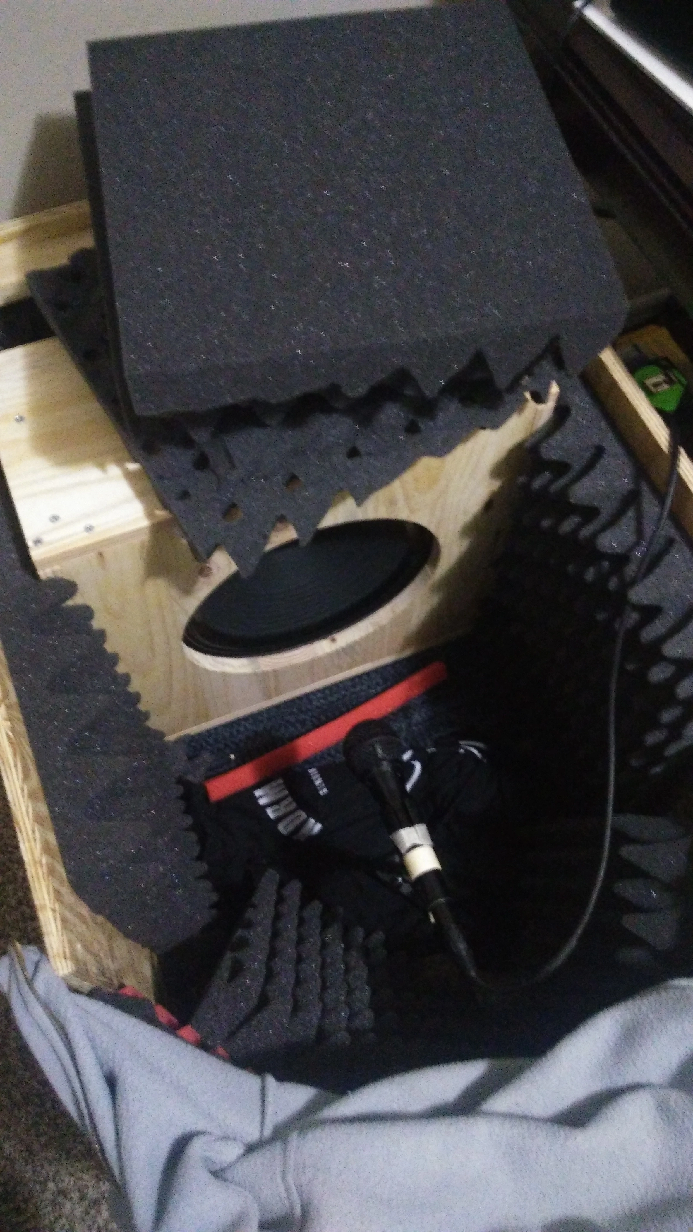

Hello all,
I'm completely new to this forum. However, I've been working on a small home studio for the past few months, building it bit by expensive bit. I'm a metal guitar player and am seeking to record guitar tracks. I've ran into an issue with lower frequencies (in the 100hz - 250hz range) creating a "wub" sound. I've tried positioning the mic at many different angles and changed it's distance from the speaker. I'm currently using an Eminence V128 speaker, with an Orange Micro Dark. I have an isolation box with 2 1/2 inch thick studio foam inside and an SM57 which I use to mic the speaker. I use Studio One 3 and have a DBX 31 band graphic EQ as well as a DBX compressor/gate along with a tube preamp. I'm using a Presonus audiobox. I've included a photo of the isolation box which also has a lid to go over it. I don't mind providing screen shots of the frequencies which are popping within the parametric EQ. The mic in the photo is an sm58 (used it just to see what would happen) I realize that is not the best mic to use. I have the SM57.
Thanks so much to all who read my post! I greatly appreciate it. If any other information is needed please feel free to ask :)
Keith

"acoustic foam" absorbs almost nothing below 250Hz, hence your problem.
mjb,
Thanks for the quick reply. Recording is foreign to me, as a result I know very little about what to do. What may be a viable solution? Expand the isolation box and add bass traps? Thank you for the correction as well. Would a different acoustic foam help? I can't thank you enough for taking time to reply to my post. You have no idea how much I appreciate it.
Keith
Are you unable to crank a amp/cabinet in your home?
Isolation cabinets 'especially small ones' are going to have issues. The box itself is going to resonate and alter the tone severely.

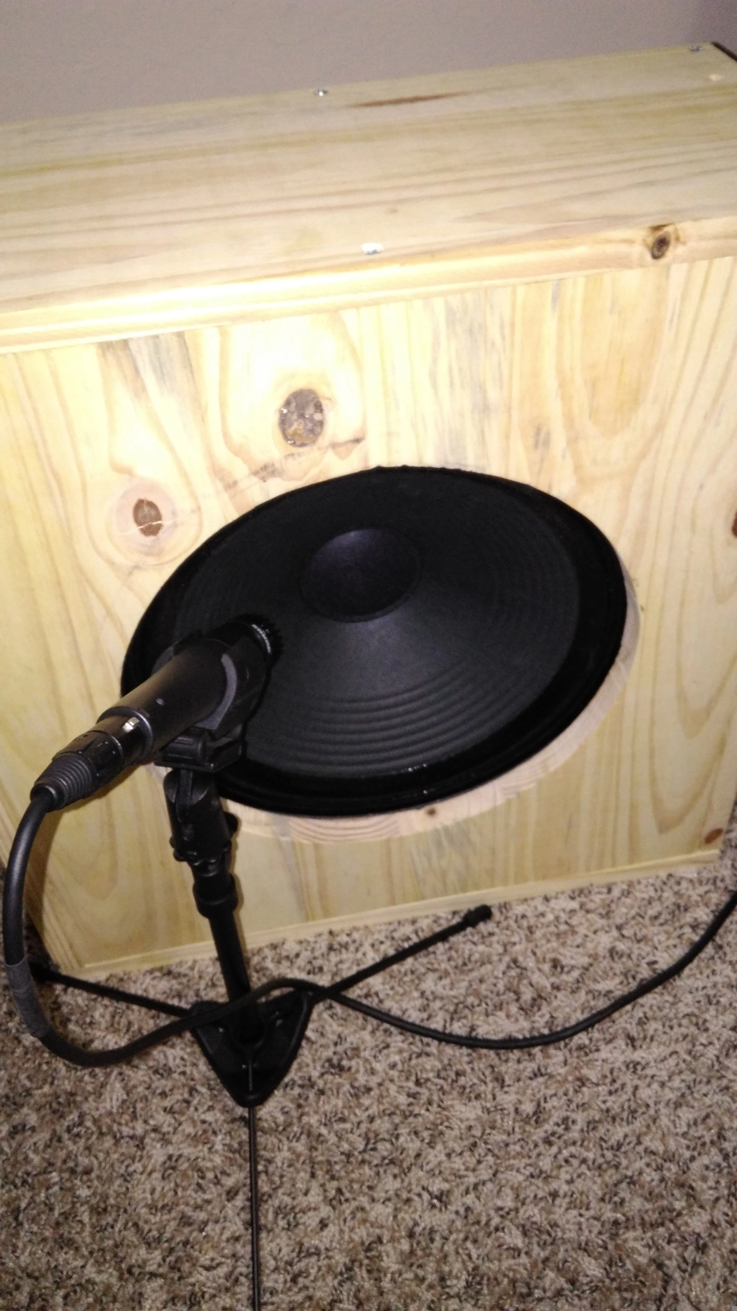

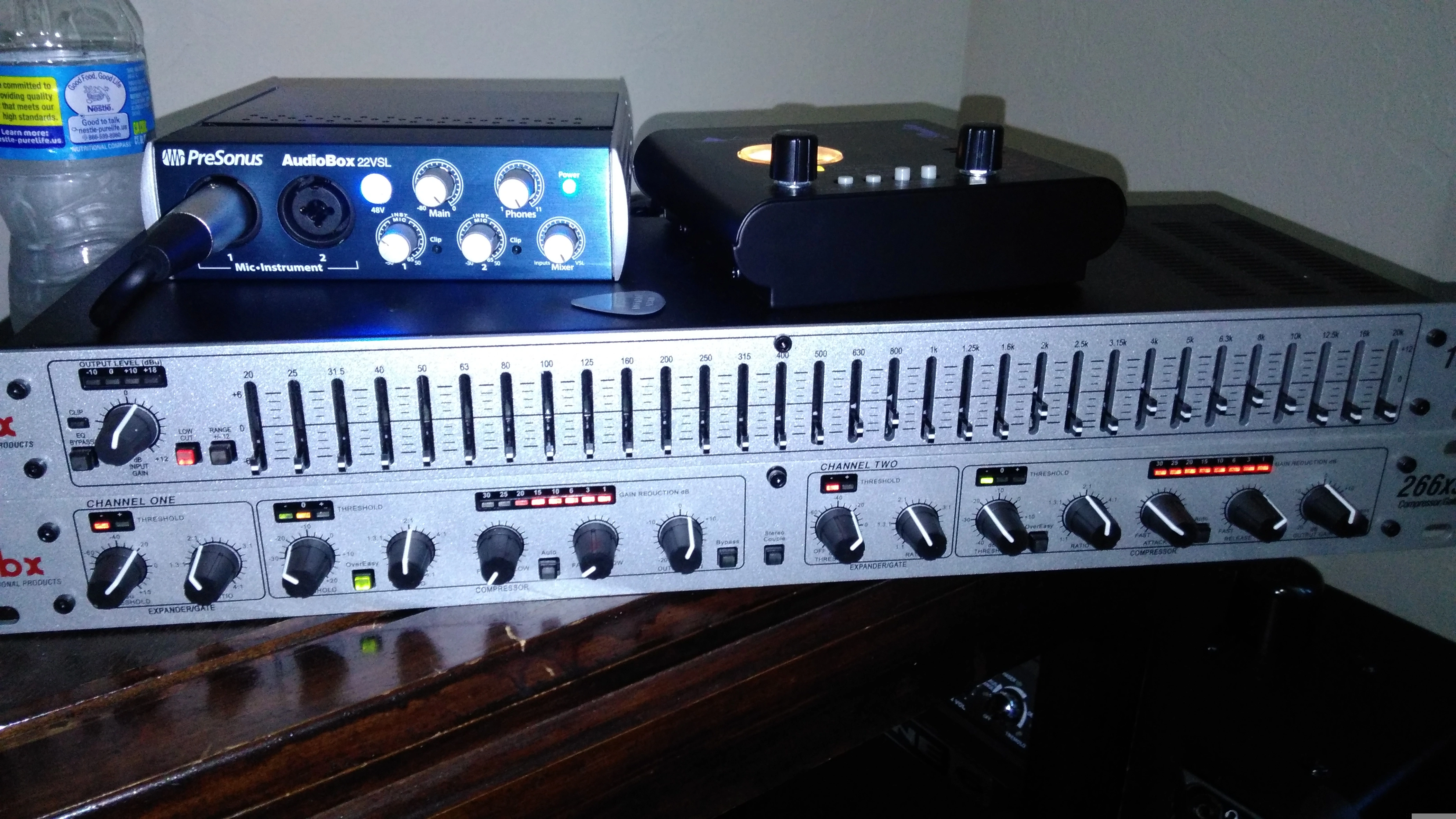

I know I keep saying this, but thanks for taking time out of your day to help me out. I did a scratch recording of just a riff with no harmonies or lead. I did not EQ it within the software. The only EQ was the graphic EQ and the virtual mixing board. Still, I have a lot of "flubbing" going on with the low end. I have a picture of how I miked the speaker and also a picture of the equalizer. Any suggestions?
Keith
I think with my current setup it will just take a lot of work in the DAW.
