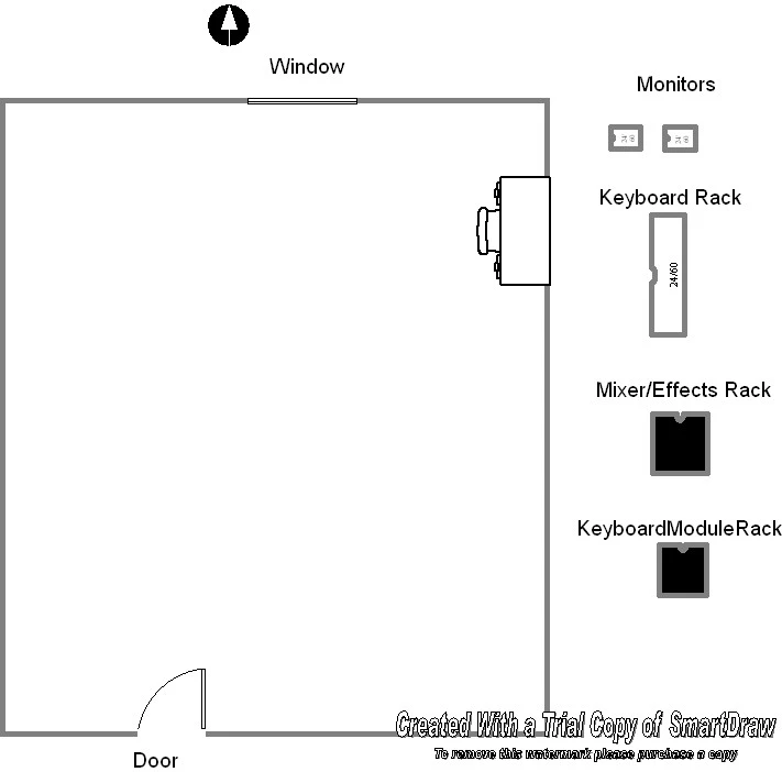

I have just finished construction of a home studio in my garage.
I only had enough room for a single room, so I will have to roll
the control room and recording space into the single room.
the room is 12"x16", with a 12" ceiling.
One 12" wall has a 31'x81' door, and the other 12" wall has a 4"x5"
window.
I have included a simple diagram of the room below.
My question for you all is: what would be the best layout in this
room for a mixing desk, 2 monitors, keyboard rack, and effects rack?
Where would I install auralex studio foam? Bass traps?
What other advice could you give me to make this room sound the
best it can?
Thanks in advance,
Fraser

I am including a jpeg of the studio layout, and still hope for more recommendations.
Thanks in advance for all advice!
fraser

Hi all,
I only had enough room for a single room, so I will have to roll the control room and recording space into the single room.
the room is 12'x16', with a 12' ceiling.
One 12' wall has a 31"x81" door, and the other 12' wall has a 4'x5' window.
My question for you all is: what would be the best layout in this room for a mixing desk, 2 monitors, keyboard rack, and effects rack?
What other advice could you give me to make this room sound the best it can?
Thanks in advance,
Fraser
Fraser,
Set up so you're looking out the window at the top of the drawing. You also want to be centered left to right in the room, 38 percent of the way back from the front wall. Then follow the rest of the advice in my Acoustics FAQ I linked earlier.
--Ethan
