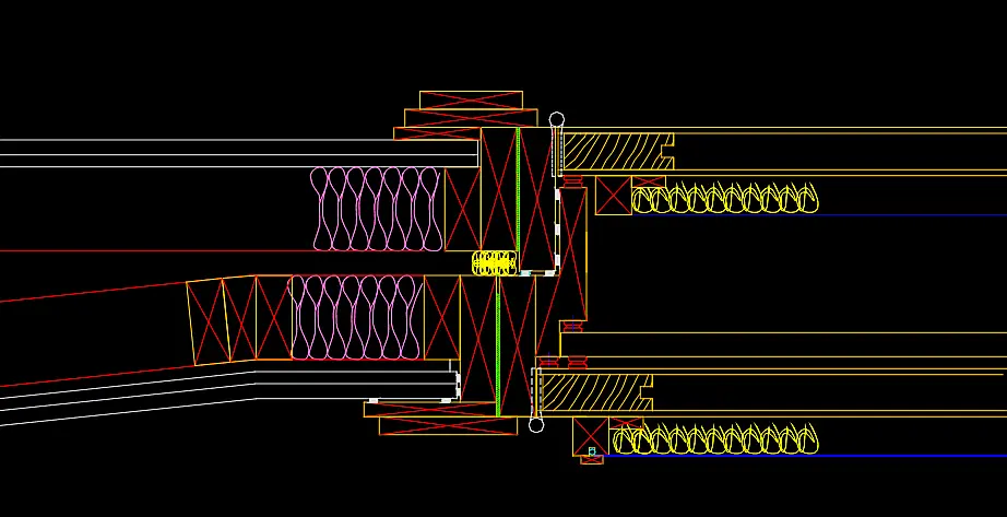

Hey Rick I am curious as to how you were planning to finish off those exterior doors. Soundproofing appears to leave walls a little thicker than normal so how would you attach moulding around the door?
Soundproofing appears to leavewalls a little thicker than normal so how would you attach moulding around the door?
Sorry to jump in here Rick, but I got up early:D
Hello sg400. You have to PLAN ahead. Take NOTHING for granted when building studio. In the case of wall thickness because of RC or multiple layering of gyp bd., you need to plan the thickness to either buy wider door jambs, or custom build them from jamb material or mill the material from thicker stock. Also, the framing for heavy interior doors must be framed accordingly, and with tighter tolerance between framing and jamb. All gaps between the frame and jamb must be caulked also. Here is my plan for double doors between a 2 leaf, 2 wall system between control room and studio. This is for situations where there is no room for a soundlock. Note the thickness to compensate for seals, caulking and air gap between walls. Also for threshold, which is a big problem with most designs. I didn't show that here, but it can be a formidible problem, if not planned in advance. Also heavy doors require heavy duty hinges. But this all has to do with your target STC. Why build walls with a target of 65, only to reduce the sound transmission loss by installing doors with a rating of 37. Weak link syndrome. Happens all the time. In this case, this is NOT a rated door assembly, as you would have to purchase the assembly with all associated hardware and jambs, to meet a rated target. This is only my attempt at overkill:D . But rated door assemblys can easily reach $1000 per door:eek: Hence my attempt at HR type design. Besides, it depends on the type music, your tolerance for noise intrusion into the recording, and how loud your local noise floor is.

Ahh CAD tools...you gotta love 'em. I have been considering the suggestions in a book titled "building a recording studio" by Jeff Cooper. His plan for a single wall, multi-layer wall tops out at approx. 7 1/2 inches (STC 50-55). I don't have enough overall space for a double wall construction so these look appealing. Looks like I will have to build my own door frames anyway.
