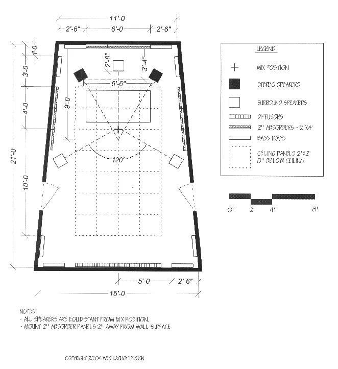

If I recorded bands it would be fine, but I mainly just need a mixing location. Thats why I asked about the 8X6 closet office area off the bonus room. I could build a removable wallin the bonus room that could be taken out. That would give me a 7' X 11" control room. However, I can't see where that is much better than using the 8' X 6' office thats there now as the control room.

As far as your room goes, man I would highly recommend using the whole large room instead of chopping it up if you don't plan to do any major tracking. I don't know if you've seen the plan that Ethan Winer has for a room that is similar in size, but I would be tempted to look into that. You could do the walls such that they could be removed later if you sell the place and it will be a great place to mix in (or so I believe)..

A room-within-a-room for two weeks' wages? I doubt it unless you are making some really big bucks.
